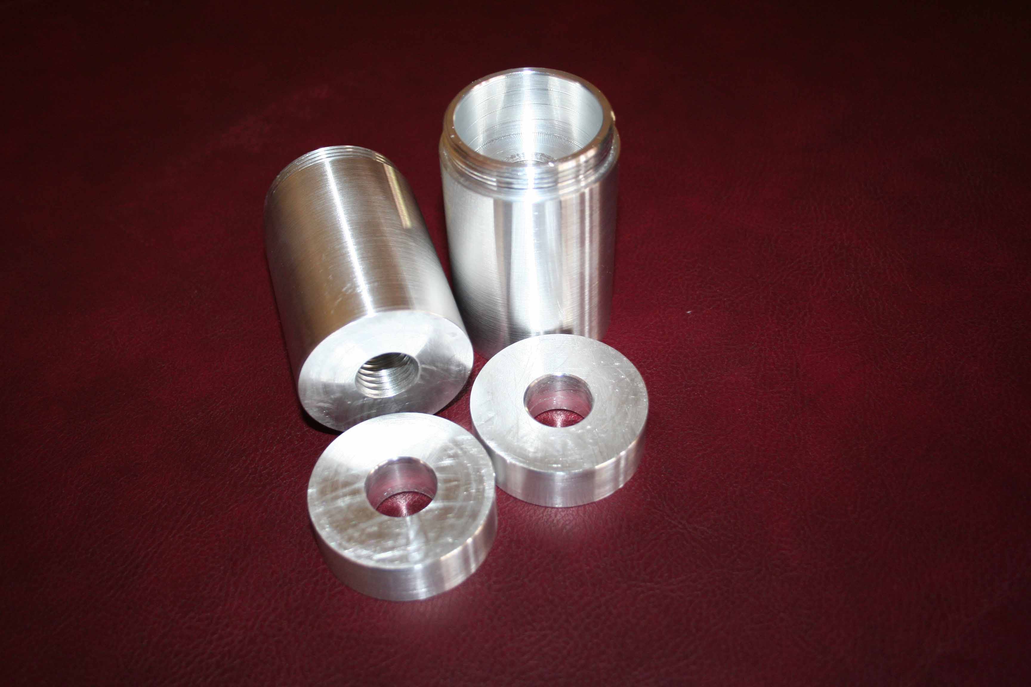

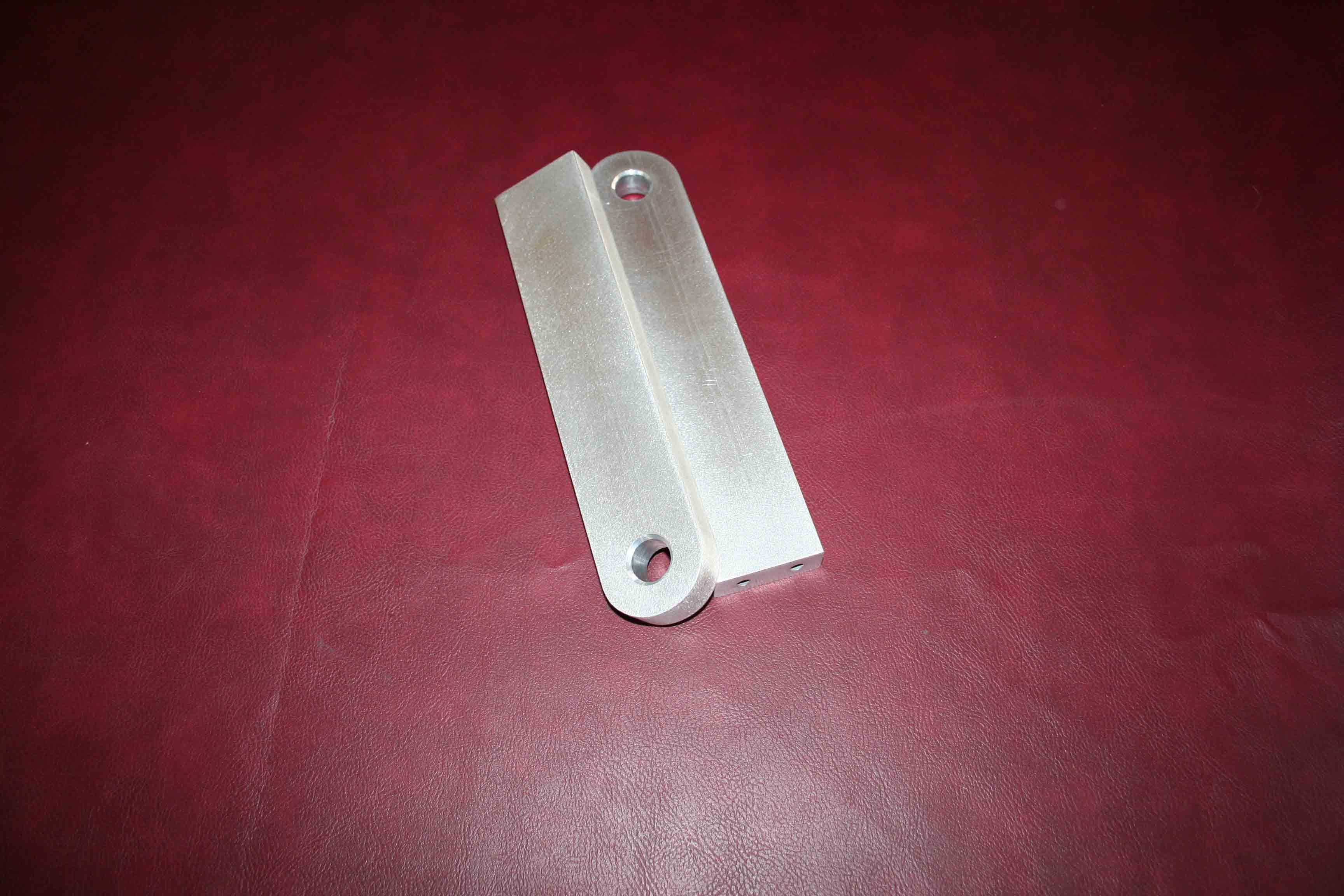

      NOW! If you have a hacksaw (oh, and a drill) in yer tool box you can also make this lil rig. I used some other tools, but to be honest, I (and you) could make the same tool. Might not look as pretty, but pretty doesnt matter. Function DOES.
      Its just some simple aluminum bar thats been drilled and fastened to form a tool.
      You can drill the holes and bolt the bars together, the bars could be wood. Duct tape a simple bubble level to the horizontal piece, the measurements arent critical, just as long as they are even front to back from centerline, easy.
      This is a tool that can be made from wood (not plywood) and a bubble level, that will IMO get you a better alignment than you can get from most of the major mainstream Goodyear, firestone or whoever alignment shops if you have an older car.
      Why? Because you get to pick YOUR numbers, and play with them.
      And all of it can be made from wood for you wood workers. Some oak would be nice, ash, heck, even pine, there isnt much load placed on it. A hand held drill, some screws, two measuring tapes, a decent level, not accurate, just needs to be sensitive.

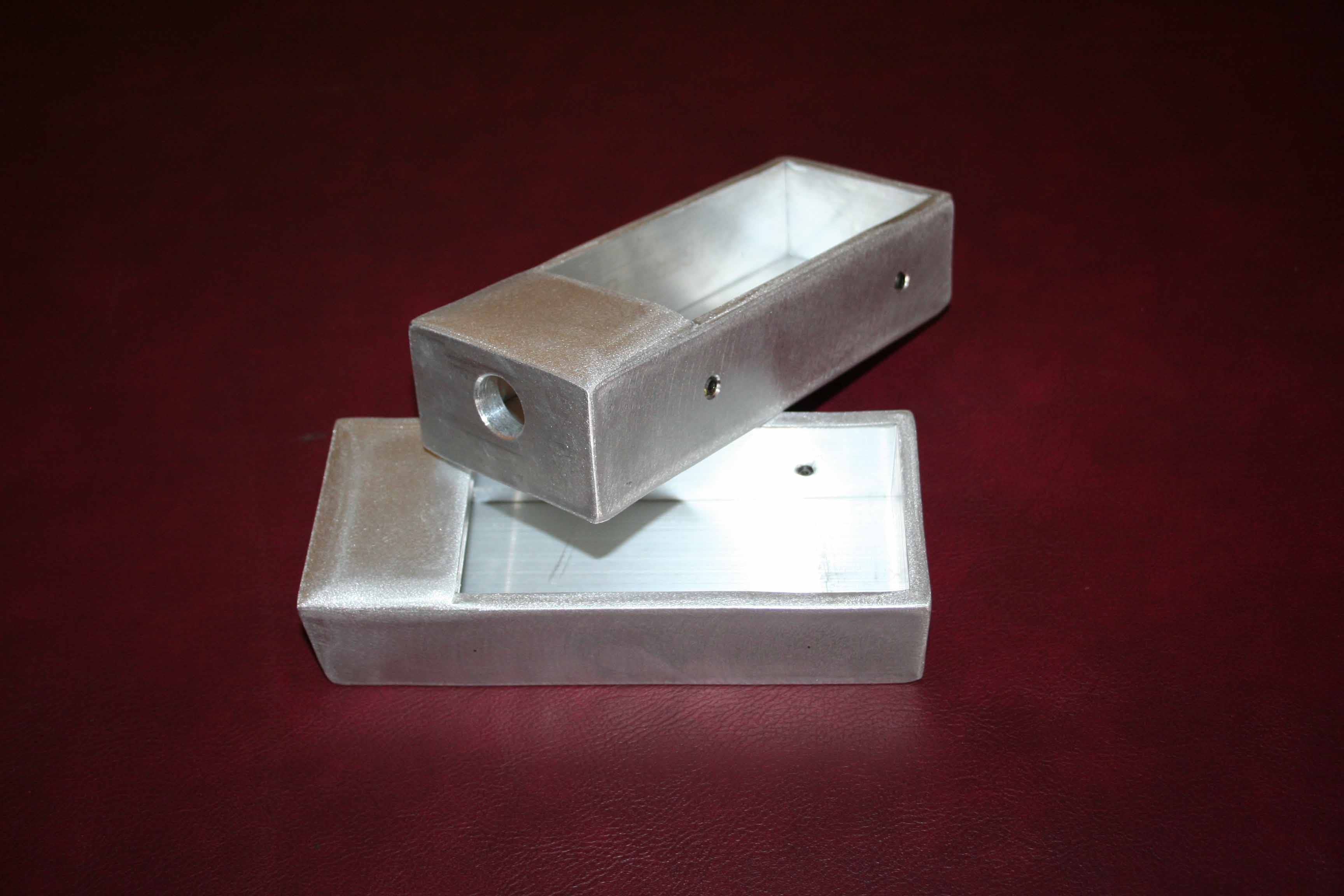

      Next was a housing for the digital protractors. There are alot of ways to do it. I do have a cnc milling machine. But to be honest, Im still learning to draw parts up in the cad program and Im not all that proficient. So welding up a box was an option. And again, welding aluminum is new to me. So I needed the practice. Glad I did. I need to get used to welding aluminum. Steel is so different and Im comfortable TIG welding steel, time to branch out.
      So I cut some plates of aluminum and clamped them up for welding. The beads weren't too bad. I HATE grinding welds down, it shows that the weld wasn't very nice. Well you get the idea, I ground down my welds LOL

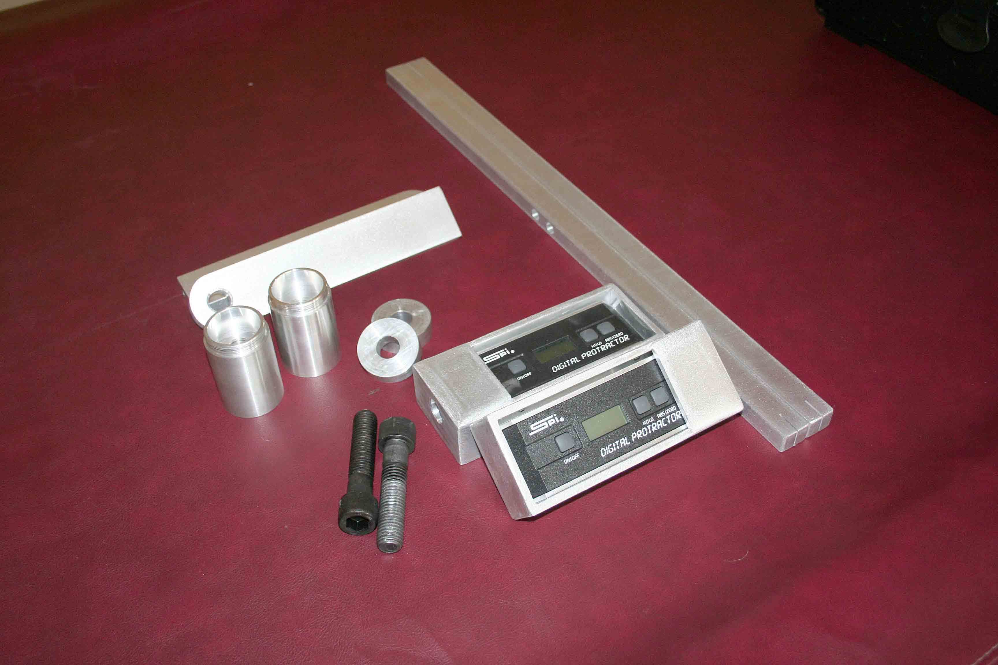

      Next was the vertical bars for the toe gauge. Simple cutting, drilling and sanding.
      The lower cross bars for the toe gauge. My car has 26" diameter tires so the lower bars are 26" long for proper toe setup.
      All the bits and pieces done.
      This is how the protractors or digital levels set in the boxes. They are captured by small set screws that align with the Vee on the body of them. Keeps them from flopping out. The reference plane that is tight to the vertical plane is the bottom of the box. When I welded the box up I made sure the upper and lower plates of the box were perfectly square with the end plate that mates to the round spacer.
      Then when assembled off the car this is what the whole thing looks like.

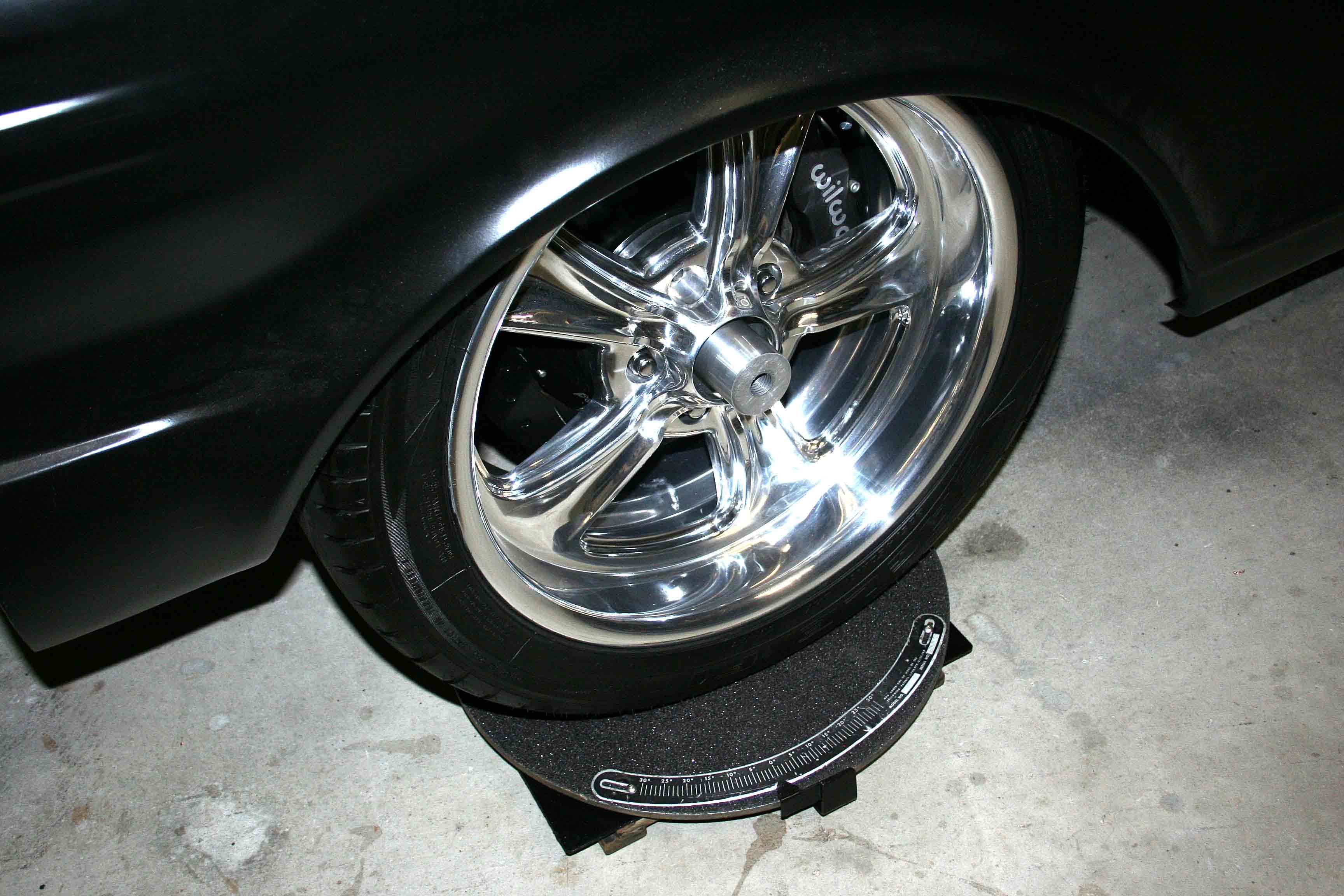

      Ok... Now the sweet part of this rig. The toe measuring. Thats why I made two of these fixtures. Hook a tape on the right side of the car and measure the left side. Its really nice. The lines are sharp enough that you can get a toe reading to within a 1/32" if you need to. And the lower arms dont flex during measuring. Its pretty stout.
      So Im gonna go ahead and do an alignment. You see the turn plates under there. They are a must IMO. Those are full floaters. Meaning they will slide fore and aft and in and out (sideways) along with rotation all on a BIG bearing. Some Bear plates I picked up on the cheap.
      Anyway, this alignment tool can be made by anyone with some simple tools. And even easier if you have a lipped wheel. No need to go with a hub mount. Hope you enjoy the pics (dont forget to click for a full image) as much as I enjoyed making this tool. JR
