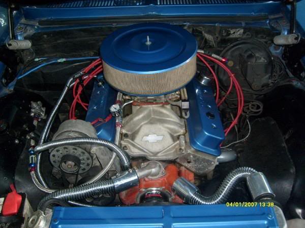

      5 years and no problems period.
      Erie, PA
      349
      Running the on my Monte for 4+ years without any issues...
