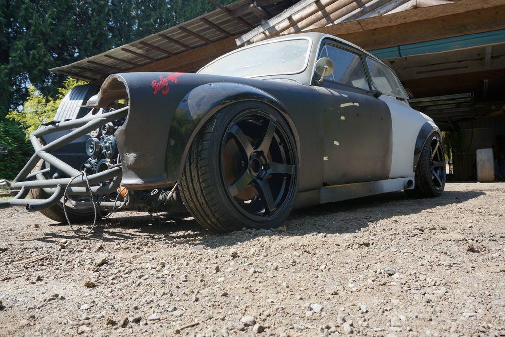

      Picked up some new wheels today..
      1966 Volvo

      Just read the whole thread, awesome build. The new wheels look great too. Really suit the look. Keep up the great work.

      Great car in general... but I really dig the "hidden" tube bumper idea. New wheels look great too. Somthing in the darker simpler wheels that looks more sinister...

      Thanks Nick. ;)
      Quote Originally Posted by LERM View Post
      Thanks for noticing! and ya I like the black wheels on this thing.
