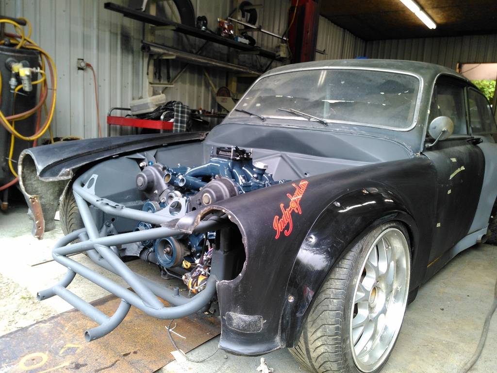

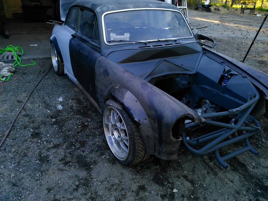

      Quick update....been driving it, been smoothing 1/4 panels, and finally got some flares on.....pic is in grayscale to take away from the distraction of primer and paint on the car. Still a bunch more fitting, and trimming of the flares but its nice to not see so much tire!
      I really hate how much I love the way this looks! What the hell is wrong with me?
      There is nothing wrong with you. It looks killer!

      Hahahah Trying to make something sort of ugly, cool. ;)

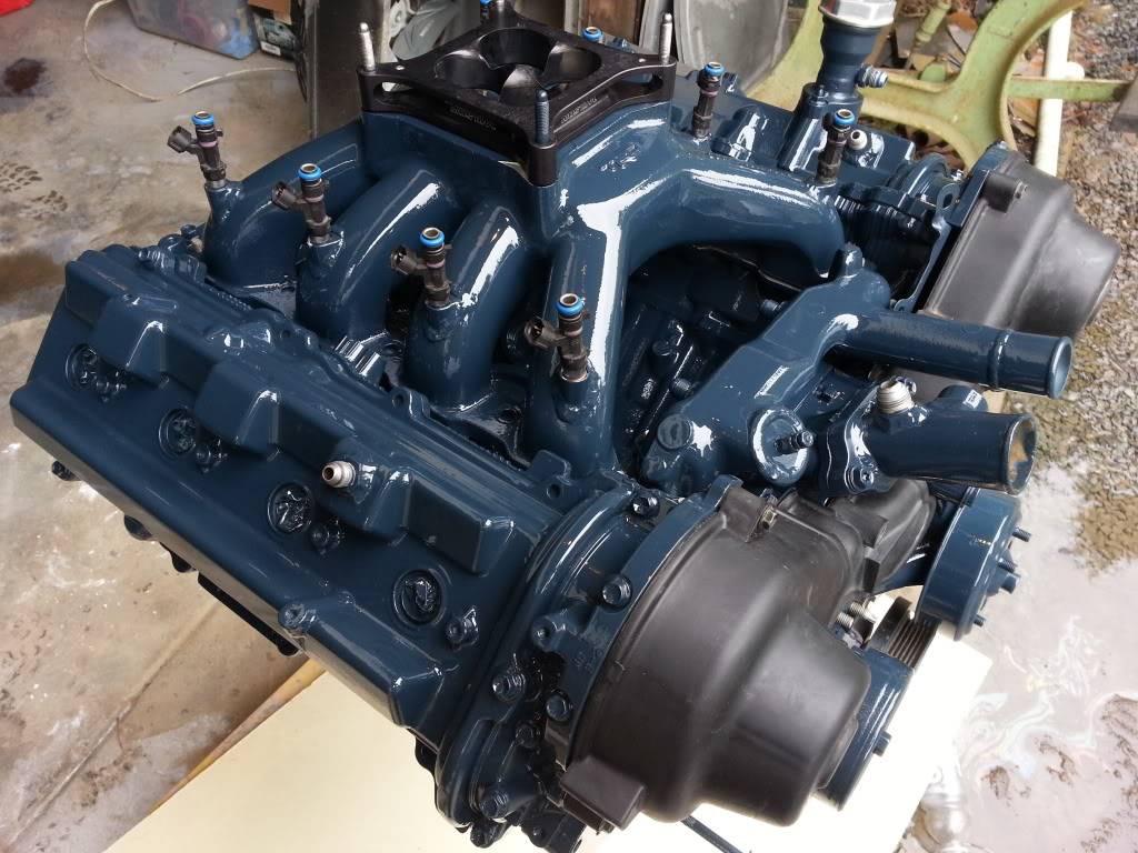

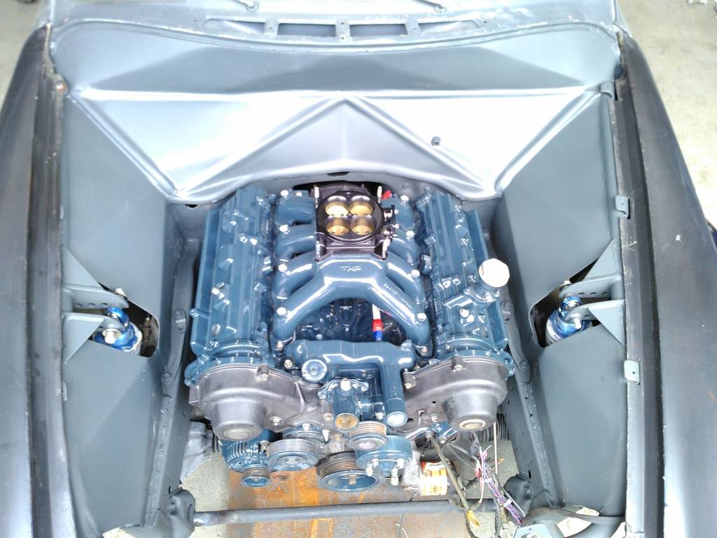

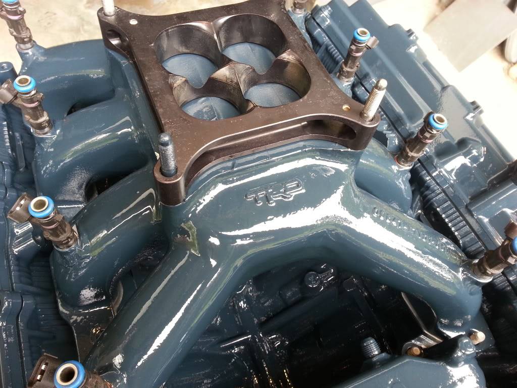

      Got some paint on the engine finally. My first attempt at ppg envirobase, it was pretty damn easy to work with. Came out a bit more blue than I was hoping for, but it really changes with the light. ;)

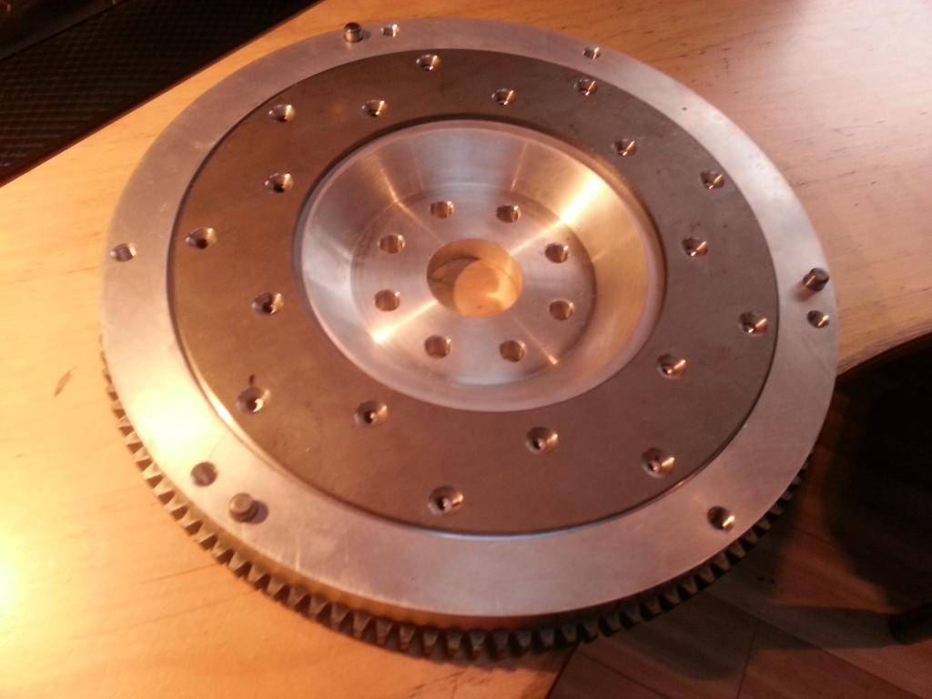

      It is alive, sort of. It is currently sitting in my shop with the motor removed while I finish off the engine bay and get it painted. I just had an aluminum flywheel made for the new motor, so once painted it will all go in and get rewired and tuned with a new ECU. Then I will start picking away at the body work, I didn't have it on the road last summer and that was a let down for me. So this spring I hope to have it back together. ;)

      Quote Originally Posted by Poopy View Post
      Do you have any more info on the paint color? Really like the looks of it.
      Thanks
    18. #258
      Abbotsford, BC
      359
      Sorry guys, this thing keeps getting delayed. I feel much guilt!
      Paint color is Audi Nimbus Grey. ;)

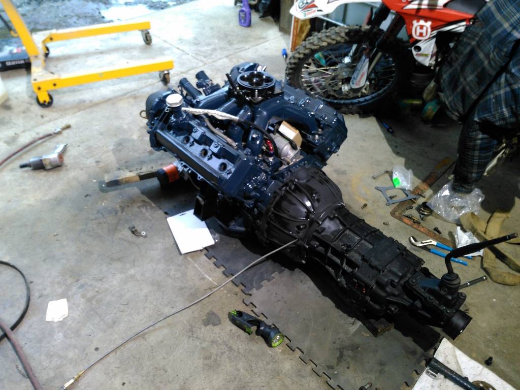

      Finally got the engine bay painted
      New custom aluminum flywheel:
      Engine and tranny mated:

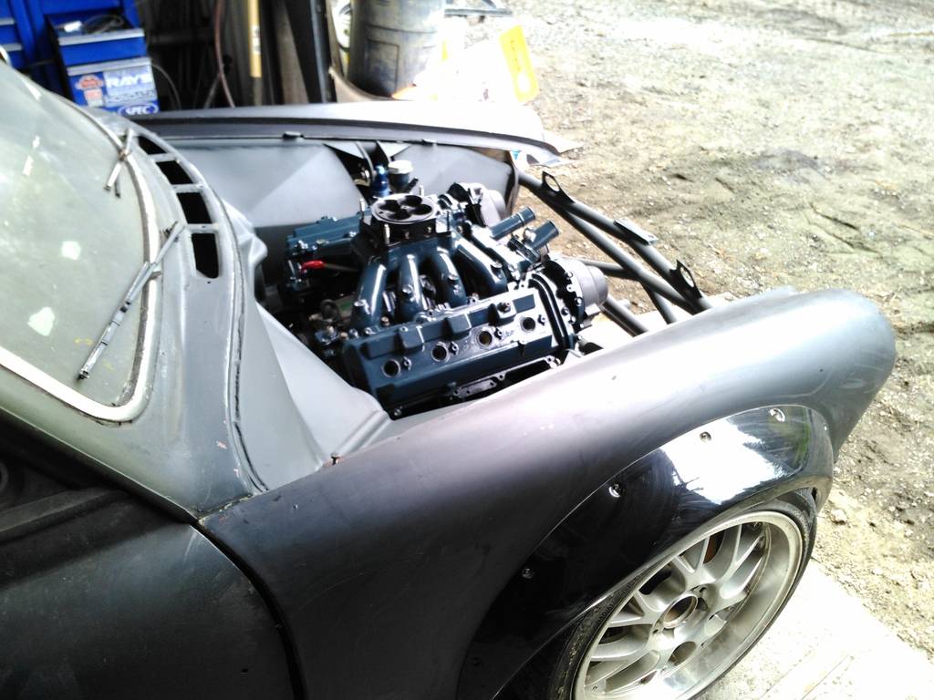

      YAY! motor installed:
      1966 Volvo
