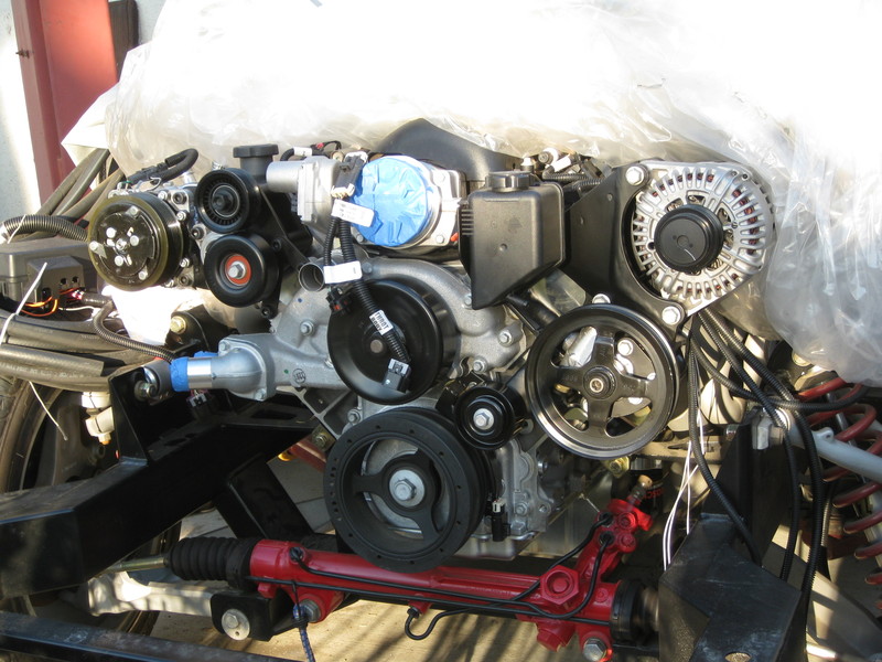

      Do you know or has anyone here modified an OEM drive to fit without notching the frame. Something that locates the alternator and AC compressor on top.

      Like this?
      GMPP serpetine setup without air and a Kwik AC compressor bracket.

      Here is that alternator on my Street Racer engine I am putting together as we speak. This is a March Style Track I put together but should be the same alternator as you need. Should have the same outlet for the charge wire and the mounts are at 12 and 6 o clock

      Nice job looks great that is exactly what I’m talking about. OEM all the way, daily driver. VA talked me into trying a 140 amp 3 wire Tuff Stuff. If this one takes a dump I’m going to do exactly what you did thanks for the Pics.
