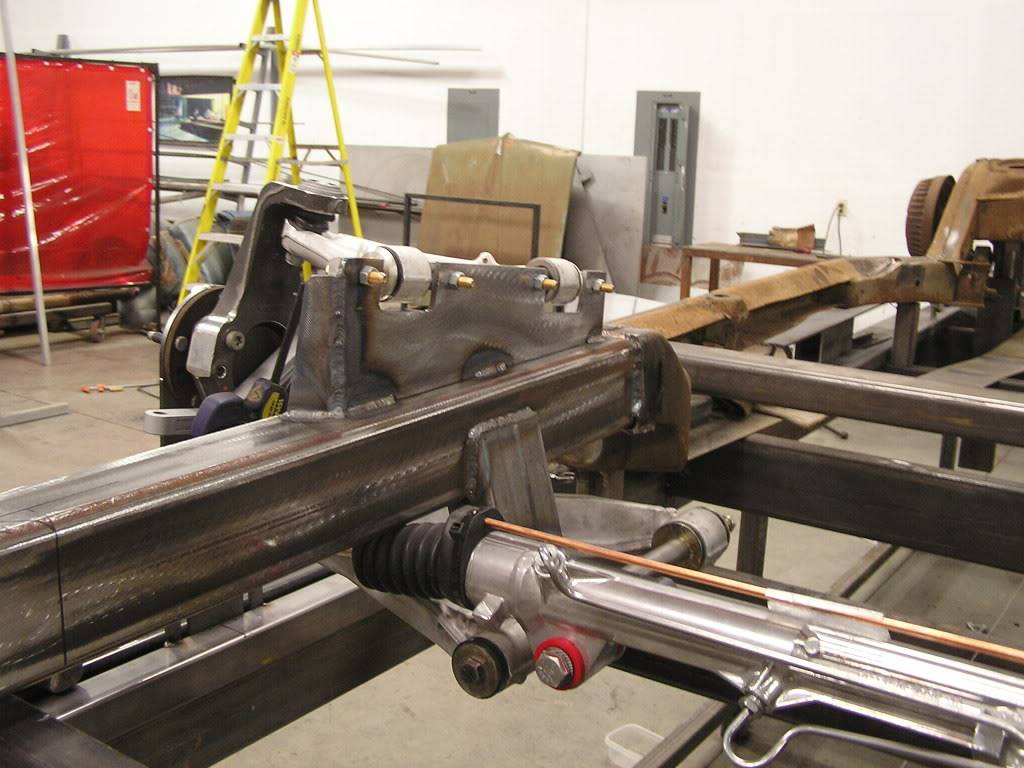

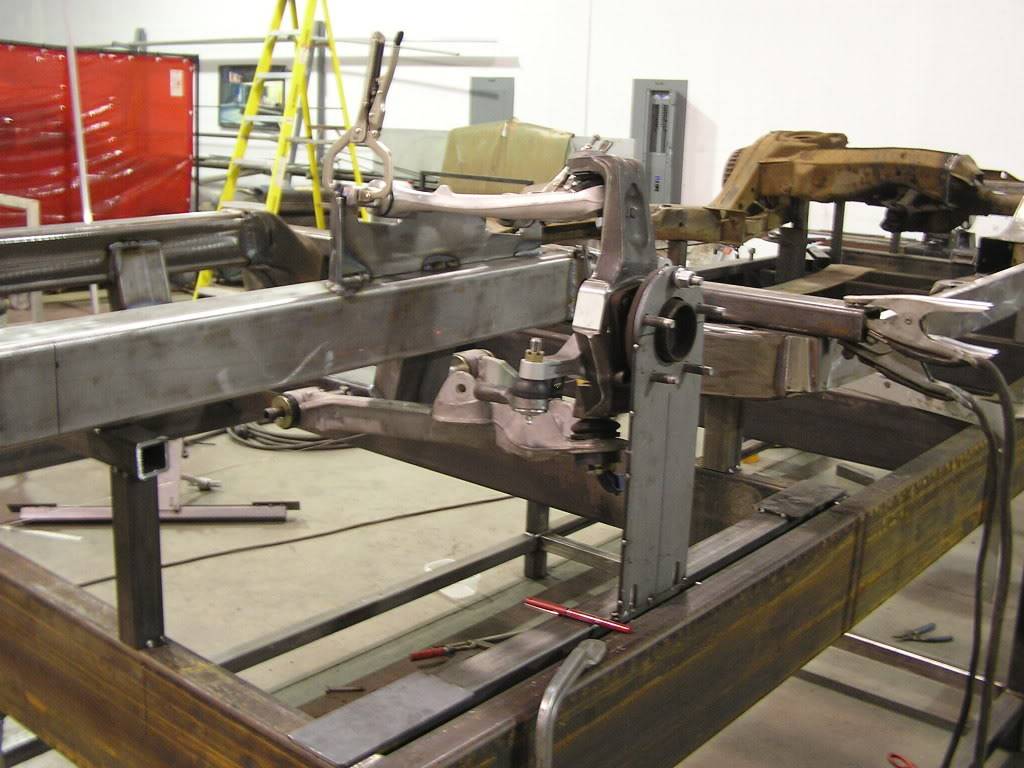

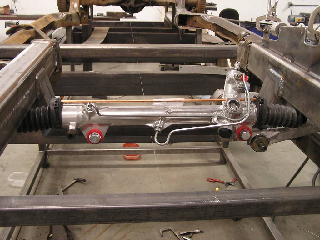

      I havent posted in a while so here is my progress.
      I'm done with the front for now. Waiting for the machine shop to finish my block then i can build motor mounts.

      Havent posted for a while,I have 2 threads on this car my bad.
      the plan.
      chassis work
      new stub in the front with C5 arms and upright's
      Rack and pinion
      6 piston brembo calipers
      14in rotors F
      13in rotors R
      Floater 9 in.

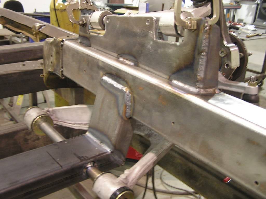

      Torque arm W/wats link
      narrowed rear frame 8 in.
      all boxed in
      Engine
      421ci. ls
      ls-3 heads
      iron block
      scat rotating assembly (free long time sponsor)
      mast custom ground cam
      hilborn IR manifold
      dual disk clutch with aluminum flywheel
      viper T-56
      carbon driveshaft
      Wheels
      18x9 18x12
      Tires
      255/40/18
      335/30/18
      Body
      2 door sports coupe (post)
      shaved handles
      drip rails
      smoothed and narrowed bumpers
      painted well?????? i have found the BLACKEST black i have ever seen!!! it made toner look brown. Or A49 mini cooper blue (thanks Mike Ring for the hookup on that)
      thats all for now before i have a melt down LOL. and all the work is done in house i'm proud to say. thanks for all your intrest and kind things to say, Jimmy

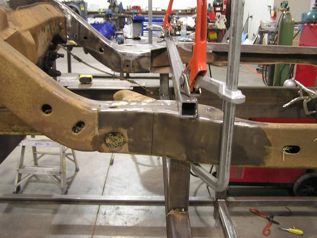

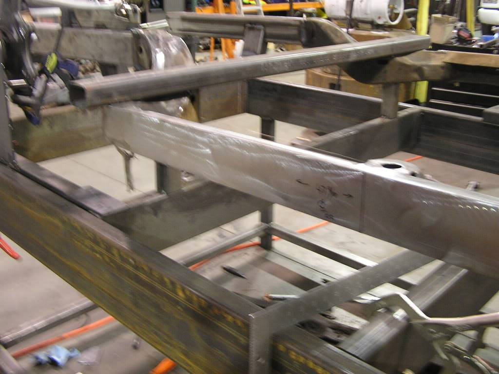

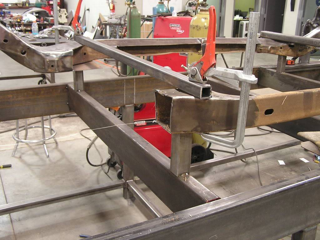

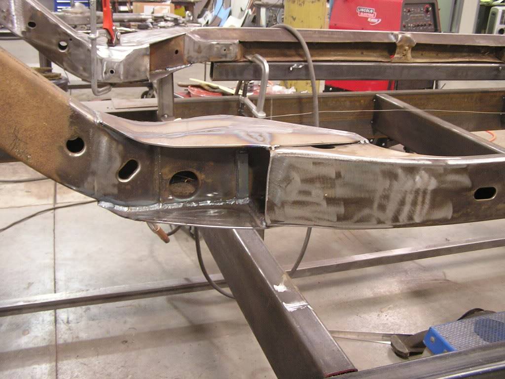

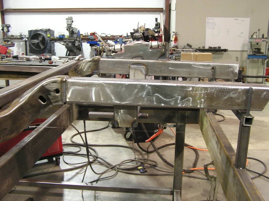

      layout of rear frame rail prior to cutting
      <a href="http://s749.photobucket.com/albums/xx137/usacsprintracer/?action=view&amp;current=012.jpg" target="_blank"><img src="http://i749.photobucket.com/albums/xx137/usacsprintracer/012.jpg" border="0" alt="Photobucket"></a>
      after cut
      top and bottom plates welded in.
      <a href="http://s749.photobucket.com/albums/xx137/usacsprintracer/64%20gto/?action=view&amp;current=017.jpg" target="_blank"><img src="http://i749.photobucket.com/albums/xx137/usacsprintracer/64%20gto/017.jpg" border="0" alt="Photobucket"></a>
      watts link.
      http://i749.photobucket.com/albums/x...%20gto/015.jpg

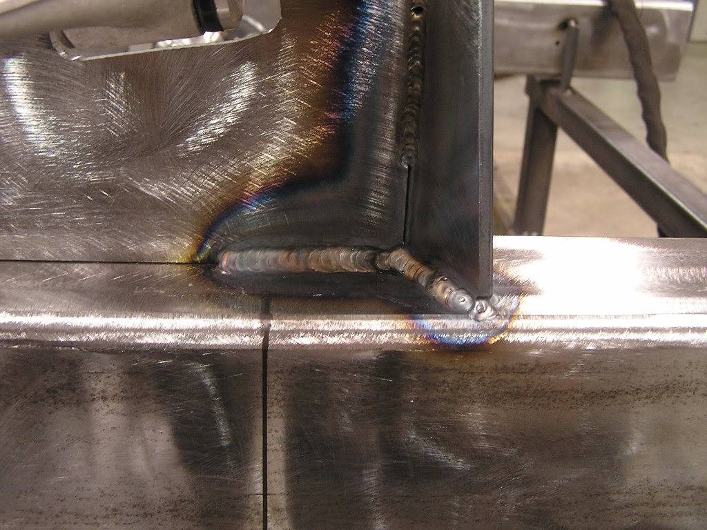

      Sorry for the screw up on my pictures! I'm an dork with a computer, But I'm bad ass with a TIG torch.
      frame rail layout
      frame rail cut
      0.125 steel plates top and bottom welded in
