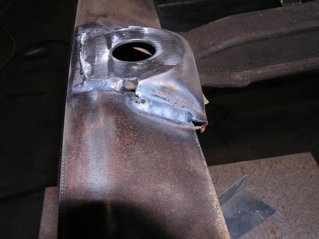

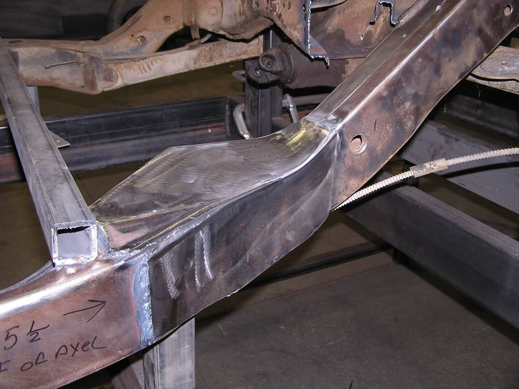

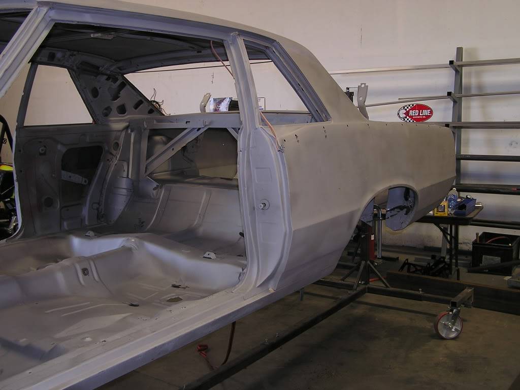

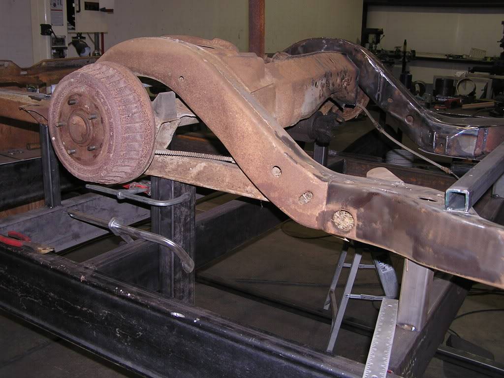

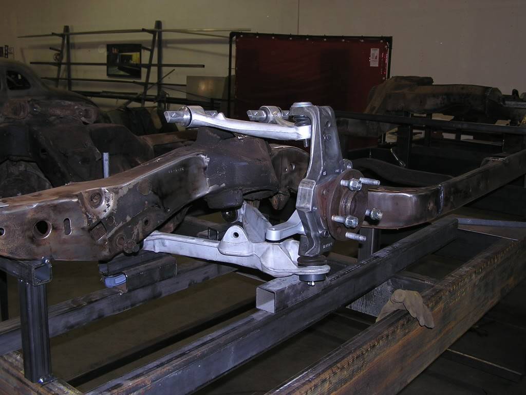

      Well i have gotten a chance to work on this a few hrs. on friday.
      Before
      After moving frame rails over 4"
      Welded up the factory frame joints.
      Layed out the front a arm's
      So making progress. I'm going to try to get the front all cut apart and boxed in this week then i can make all the front controle arm mounts. Rear end will dbe here next week then i can build the torque arm. thanks for looking Jim

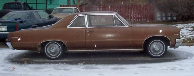

      this is what the finished car will look like.
      Feb 2006
      478
      Did you already have this car looking like that before you started the mods? That looks awesome already!

      no not my car
      i just love the way that 64 looks.

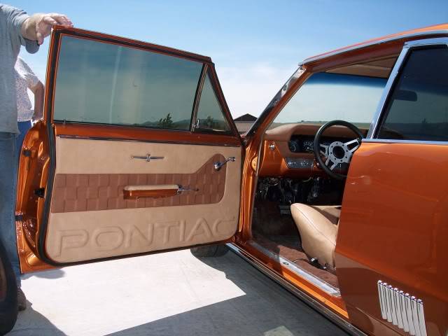

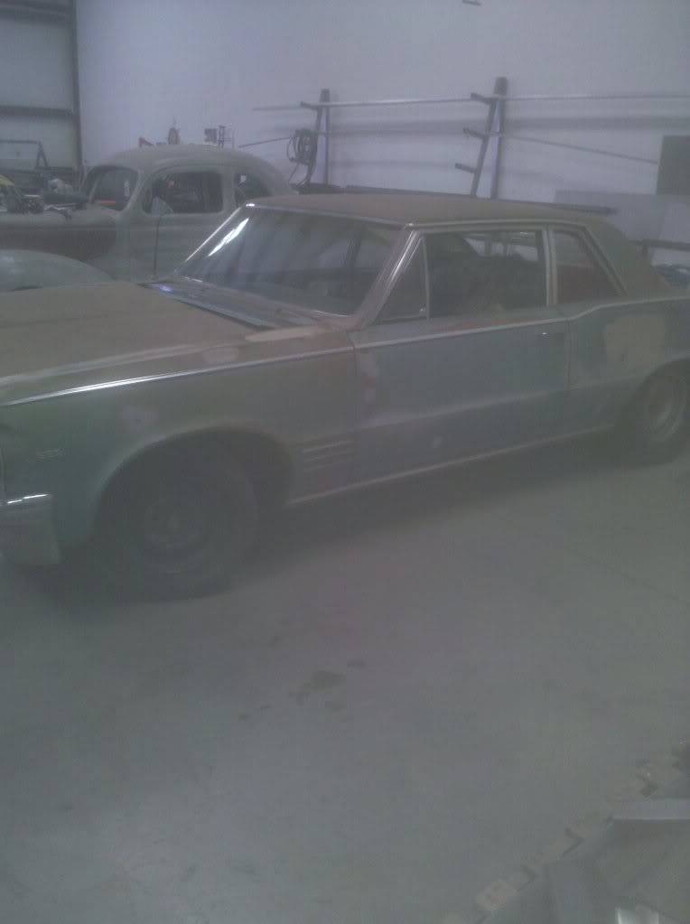

      I just left the post trim just gave it a polishing, its not in the best of shape but its what I could afford at the time. I have a 67 tempest sedan that I was thinking I would like to remove the trim and clean up the frames and just paint them but not sure how much work I would get myself into. If you make yours a hardtop I would love to see how you do it maybe I would do that on my 67. Here are a couple pics. Still need to finish and modify a few things but its close.
      Aug 2010
      modesto calif.
      54
      wow your car looks great!!!
      Aug 2010
      9
      Thanks, it was my first complete build. I did everything on it, only thing I paid someone to do was the alignment.

      i want to see way more pics of the frame rail narrowing

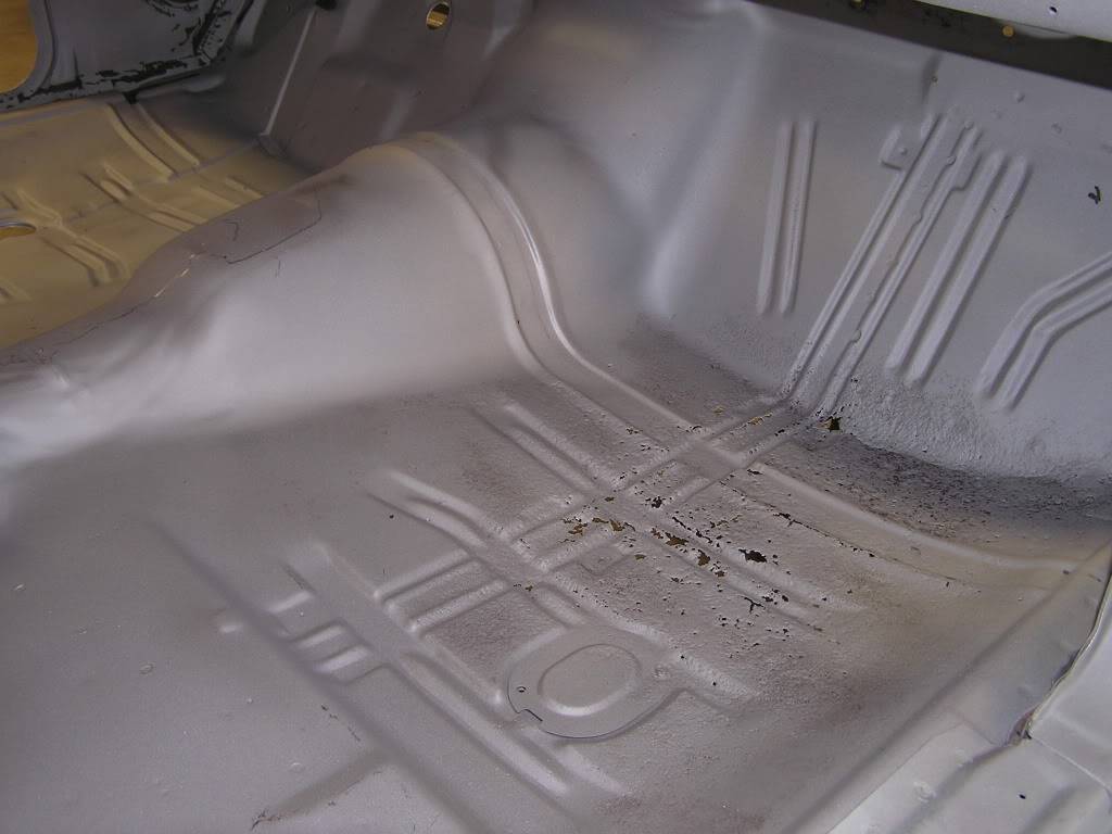

      Here are some before pictures.
      after blasting.
      mini tub
      335/18

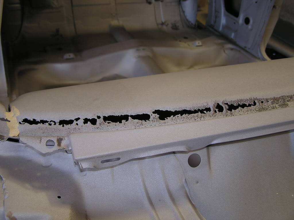

      Some rot to fix this car isn't too bad
      I have more pictures to post soon !
