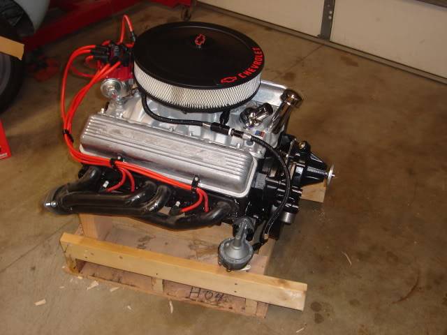

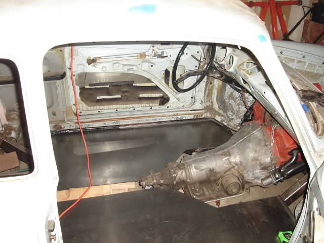

      Thanks for the input. I am on old VW person and these Chevy engines are new to me. Here are a couple more pics of my project. Engine is a brand new 330 horse.
