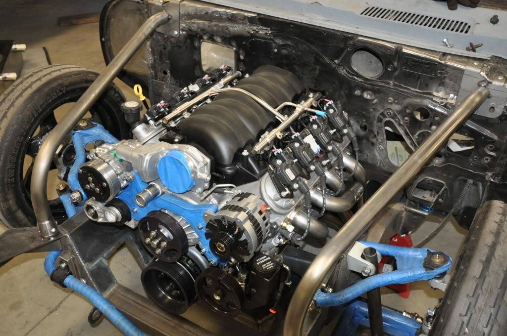

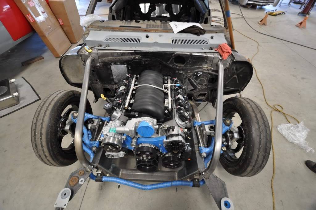

      Well enough of the emotional made for TV Drama stuff. Nic already had picked up an LS3 with a 4L60 trans from the dealer. We talked about some different options for his build and decided to go with complete Speedtech Suspension set up on this project. We bought the headers and everything from Speedtech. We then ordered the complete Marquez Design Interior kit, the Billet hinges and handles from the Ring brothers and the axles from Moser and the brakes are on order from Wilwood. We ordered a Rick's Fuel tank and a ton of other parts.

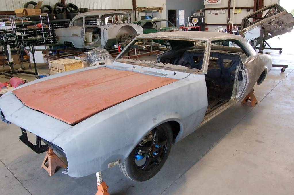

      We then began with the suspension and drivetrain install. We installed the Vintage Air Front runner on the engine and installed the headers. We got everything major installed in the car to begin our Fabrication around these parts. We built our own mini tubs and got those in place. We installed the DSE sub frame connectors and mocked up the front sheetmetal. We cut out the old dash and Mocked up the Marquez unit and set up the steering column. Currently we are working to widen the inner wheel tubs in the front to clear the wider tires.

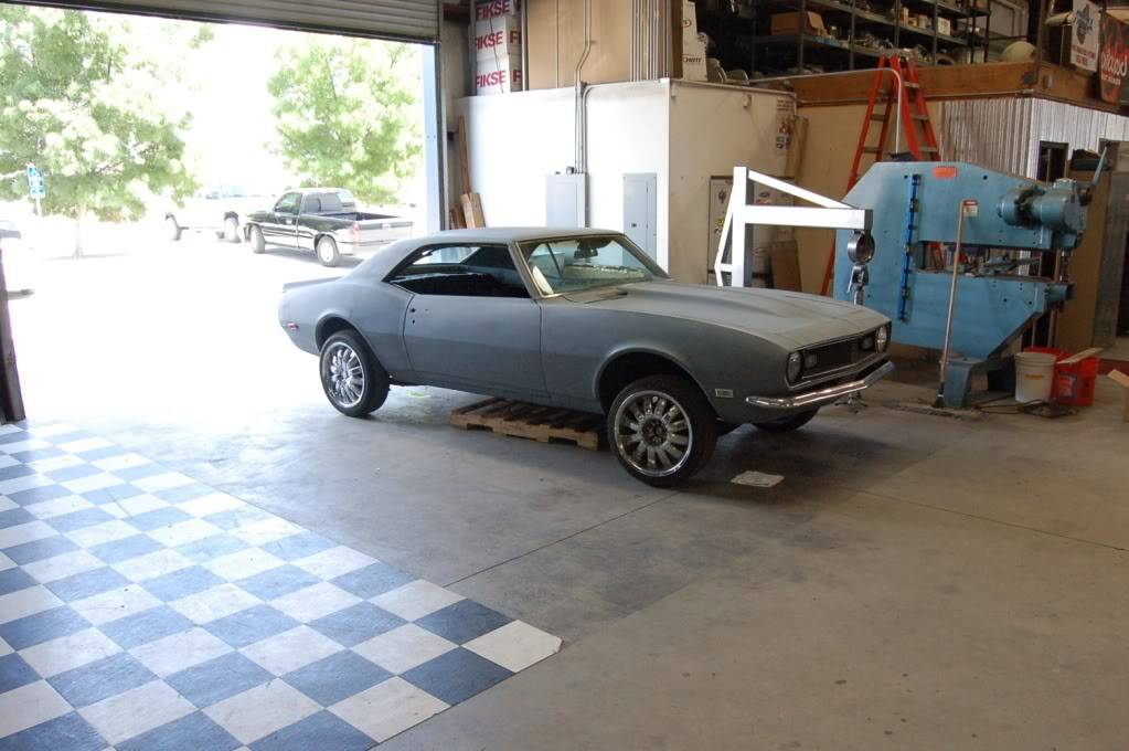

      How the car came in and why it got it's name. DONKey Kong
