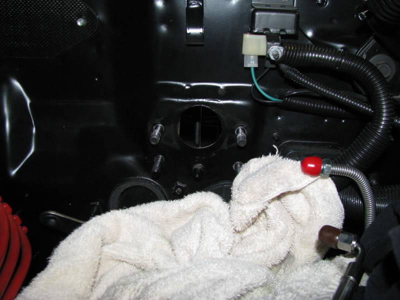

      I made a new gasket to fit between the new HB unit and the firewall, I used Felpro# 3157 rubber fiber gasket material from NAPA Auto Parts.
      Then I installed the HB unit. Before installing the Wilwood master cylinder, install the two high pressure lines and the low pressure return line. Installation of these hoses is nearly impossible if you install the master cylinder first (ask me how I know). Remove the preinstalled brass 90* fitting for the low pressure return port from the HB unit, and replace with the THI 5/16"-24 O-ring male to -6AN male fitting on the HB unit. Be sure to torque ONLY to 10 ft. lbs. as the threads for this fitting can strip very easily. Use one wrench to hold this fitting while tightening the Russell part# 613161 90* hose end with another wrench.

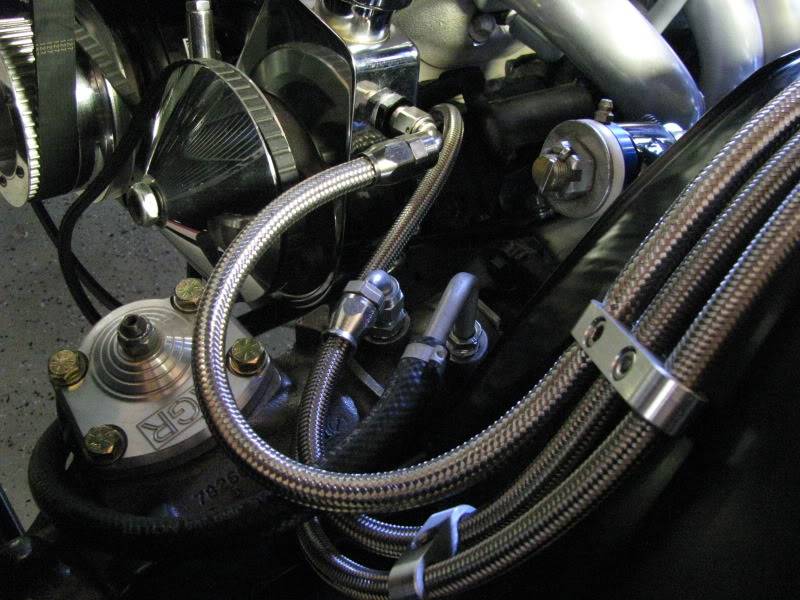

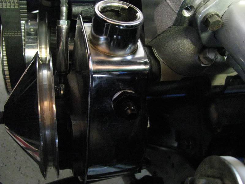

      Day 2) I drilled a hole above the fluid line in the PS pump reservoir and installed the Russell #670850 -6AN Fuel Cell bulkhead fitting in the reservoir for the low pressure return line from the HB unit. I stuffed a clean shop rag into the reservoir, spread some grease on the end of the drill bit(metal particles stick to it), and vacuumed real well with the shop vac to make sure no metal particles got into the reservoir.
      Then I cut to proper length, the two high pressure lines coming from the HB unit and installed the Aeroquip fittings and then installed them in their proper locations, and also installed the Russell part# 613161 90* hose end on the other end of the low pressure return line and installed that on the PS reservoir.

      I am not being critical but is there a reason for using a 90* fitting out of the PS pump? My first thought was a straight fitting would allow the hose to go over to the other hoses and keep the line away from the header heat.
      Great job thanks for taking the time to post.
      Tom
      Dallas, Ga.
      439
      Yes Scott, do be weary of the heat coming from the headers. It can lead to overheating the fluid and burning up a pump. Don't ask me how I know this.
      It's also a good idea to use a power steering cooler. Don't use one listed as a ps cooler though, they are too low of a flow rate and will cause a bottle neck when running on a track. I used a small plate fin type transmission cooler for my PS and it flows plenty and works great.
      If street use only and no track days or auto-x you can get by without a cooler, but get the line away from the header tube.

      He could turn that fitting a little more toward the front of the car(if the hose is long enough).

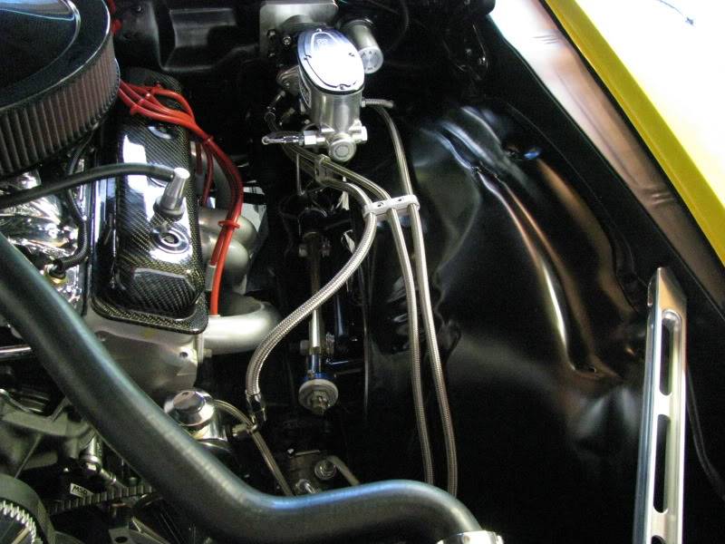

      Finally finished the brake plumbing. had to make up some new lines for the different configuration with the Hydroboost setup. Added a new hard line from the "B" port on the Wilwood master, back to the new proportioning valve for the rear brakes. I decided to move the "Tee" fitting for the front brakes up to the inner fender. That required a new hard line from the "A" port to the "Tee".
      I also made up a different low pressure return line from the Hydroboost back to the power steering pump reservoir. I made it longer to run it more forward away from the heat of the #1 cylinder header tube.
