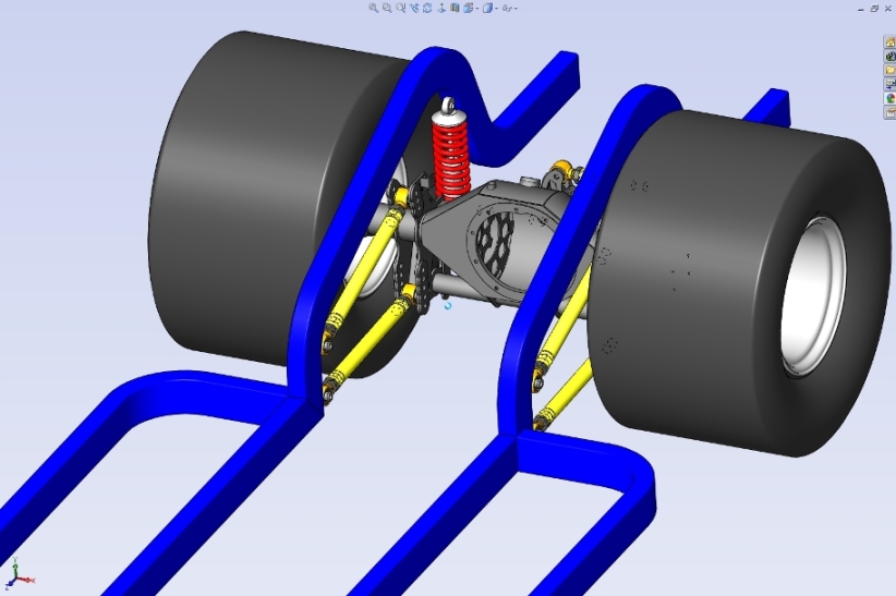

      Here are a couple images of the rear suspension I'm designing... The diff housing is also designed by me... Work in progress... - Jay

      I think I know what's going on with it, and I'm going to guess that you wouldn't be placing the ride springs and their dampers in the usual places. Maybe closer to what jaybob's pictures show . . .

      Quote Originally Posted by Jaybob View Post
      Hi Ray,
      I'm new to this site and actually found it because I was searching for info as I design the chassis and suspension of my project vehicle. I am intrigued by the concept you have posted here. I know that this is an old post and I am wondering if you finished and tested your design. I am currently modeling my design in 3D, (Solidworks to be more specific). My project is not a Pro-Touring car, but more along the lines of Pro-Street. I'm intrigued because the packaging of the suspension could possibly work for me. I have a very narrow rear frame set 25" outside to outside on the rear frame and I currently have a parallel 4 link with a watts setup and 2 coil-overs in a vertical arrangement. Feel free to contact me directly if you like. Thanks! -Jay
      Jay,
      Thanks for the interest. This project is stalled for a couple of reasons... Due to packaging constraints in this chassis, I am using a through rod type spring/shock assembly (not exactly a coil over). I had been working with the lead development engineer at Penske, but a lot of the info is proprietary to MotoGP and F1 teams. I think I found out some stuff i shouldn't have because he isn't returning my emails anymore...
      I also purchased another supermodified which was supposed to be a bolt it together and run it deal. Turned out to be a junk pile, but I'm in it now and need to get it finished.
      We will get the new car (on the bench at rear of this photo) done next year, and I'm confident that the suspension will work the way it should.
      As to your question, there really isn't a lot of benefit in your application. Unless you are really running 10/10ths through the corners, your pro-link with watts setup should be just fine. You would have to reverse the Mumford link (pivots attached to housing) with that narrow a chassis. The unsprung weight goes up with no real performance advantage.

      Thanks for the reply... I tend to agree with your comments regarding my current project... However, now I'm already thinking forward to my next project which is planned as a pro-touring car. I'm thinking a 1967/68 Ford Falcon slung low with a coyote small block maybe... Anyway, I digress...
      Here's my thoughts... As I model these various live axle rear suspension centering devices, (watts, mumford, satchell), in 3D and apply side loads, (as in cornering loads), I find that all three of these have a similar problem with respect to "jacking", (maybe not the correct term). What I see when I allow the 3D models to articulate is that it wants to "push" the body/chassis to roll to the outside, (in a counter productive direction). So then I add in some loading to represent "anti-roll" and I see that the side, (cornering), loading is, (in effect), trying to "lift" the outside tire from the ground. Am I missing something here?
      Thanks! -Jay

      Jay,
      I don't think your model is accurately representing the loads placed on the system... As long as the C/G is above the roll center, you are going to have increased loading on the outside tire. The anti-roll bar does not change the load going onto the outside corner. What it does do is to keep the car flatter by unloading the inside tire (picking it up off the ground in extreme cases). Normally the weight on the inside corner exceeds the lift generated by the bar, so the car "falls" back toward a level state. This isn't the greatest thing for traction, obviously...but that's a topic for another thread (coming soon).
      You are correct that a lower roll center (as offered by the Mumford linkage I am using) does cause more side shift of the chassis over the tires, BUT the low roll center also reduces the amount of lift on the inside, which improves total traction. It's common knowledge that a larger front bar will increase understeer, so the theory is backed up in practical application. We don't like to feel like we're going to roll the car in hard cornering; so the bar does tend to improve driver confidence, which can easily reduce laptimes. I'm still employing plenty of anti-roll force...just in a way that is much more controllable and doesn't reduce inside tire load nearly as much as a fat sway bar...

      Hi Ray,
      I went back through my loading and I cannot believe that I completely forgot to put the respective vehicle mass on the tires... Makes a hell of a difference... Okay, for this project I'll stick with the watts setup... I've got some ideas on a variation of a double A-arm front suspension that allows for VERY quick & easy camber & caster adjustment... Give me a few days and I'll post some images...
