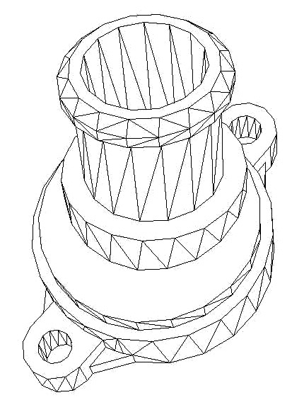

      I thought about that, but I'm just not sure it would look right. I'm in the process of drawing up a fabricated waterneck that will work, ans since I have access to a lathe and drill press, and enough knowledge to be dangerous, I think I can pull something off. I looked at using e-machine shop to have it done, but it would have been $200 for the waterneck. I think I'd rather buy $20 in materials and spend my time building a cool one off part myself.
      I also compared the LS1 housing to the gen 1 housing, and the LS1 unit is smaller, and the bolt holes are closer together. I'm still open to suggestions though, until I can get it figured out.

      This is kind of what I'm thinking. It basically is two pieces of turned round stock, and a couple of tabs to bolt it on.
