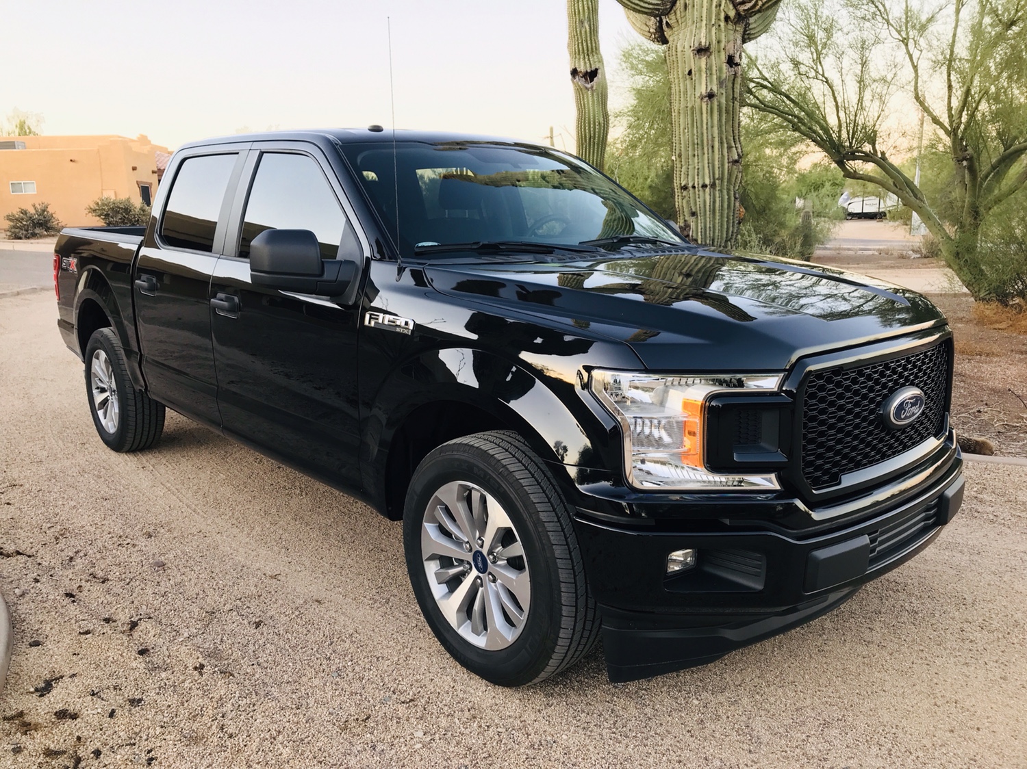

      I bought a wrecked 2018 F150 with the GEN3 5.0 Coyote 10 spd from Auction but was such minimal damage I fixed it in a couple days. Long story.
      After putting on 5k mi in just 3months I decided the low rpm power was just not there.

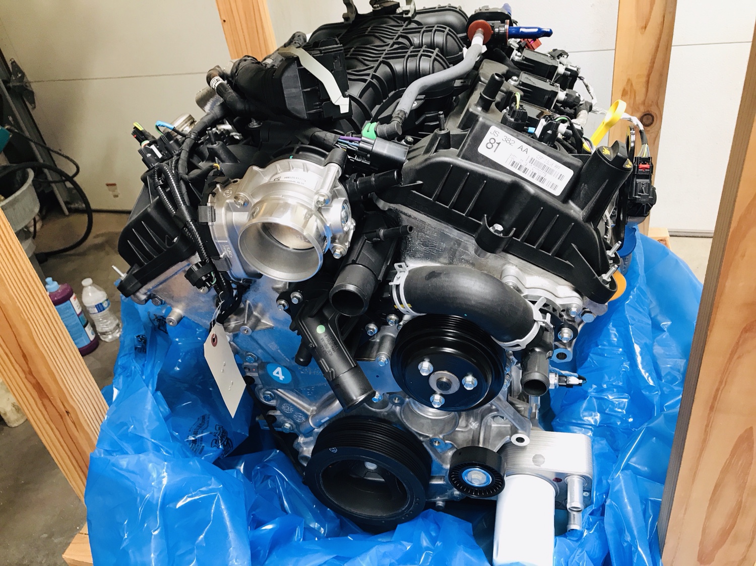

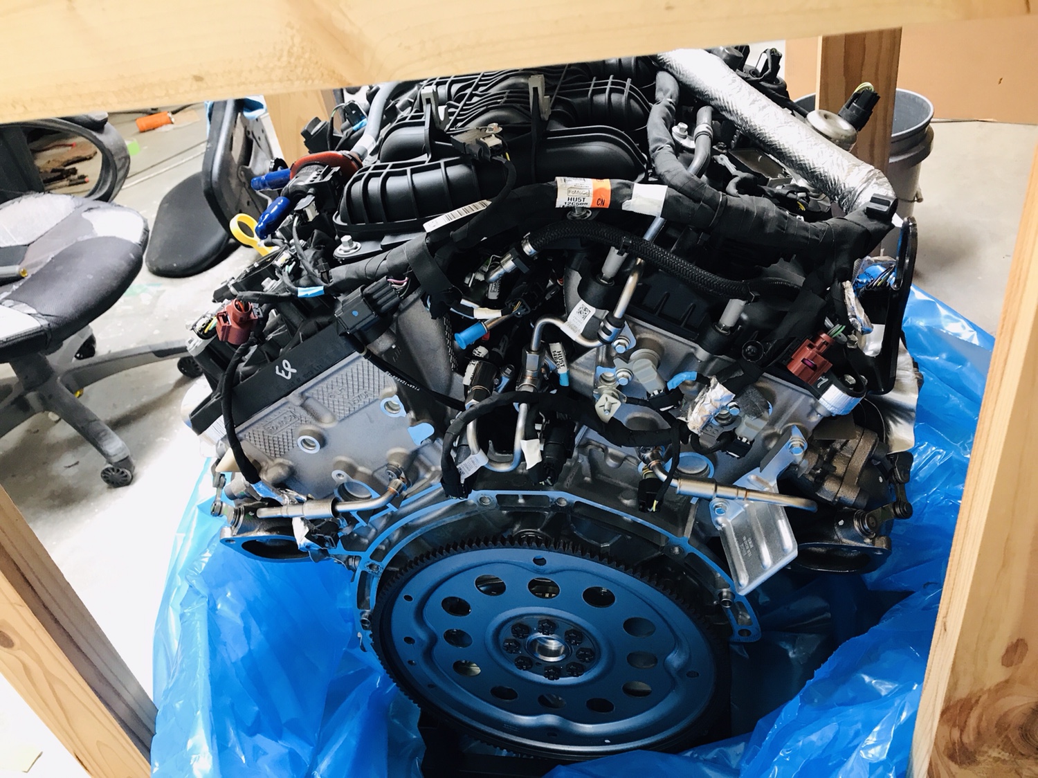

      Being used to big block power and after a bunch of searching I heard rumors Ford Performance released 5 450 hp 510 TQ Raptor 3.5 crate engines. I was able to purchase engine #4!
      With just a basic tune it should put down 500 HP and 550 TQ to the tires. Plan is to use the 10 spd auto and stock PCM.
      Raptor 450/510 crate engine
      The ‘18 150 5.0 I bought for engine and transmission but ended up just fixing it.
