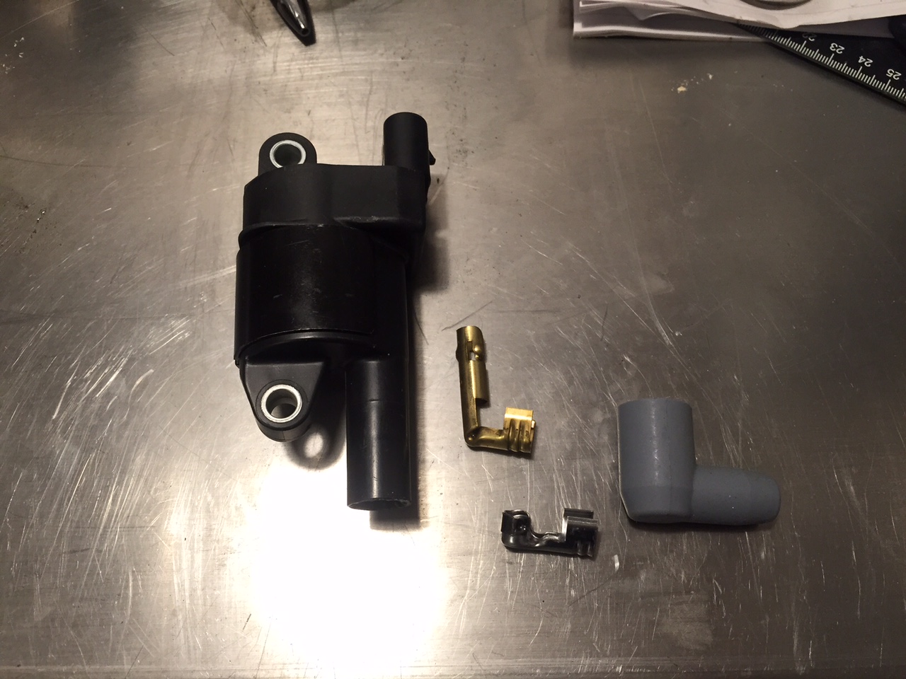

      I got a problem which I hope someone can help me with.
      I bought a DIY-spark plug wire kit so I could make custom length for the wires. However, I never checked the LSx ignition coils before doing it. Of course, they are different than the 70s HEI distributors...
      So, since the spark plugs wires were kind of expensive - does anyone know if it's possible to just buy the fittings for the ignition coils alone?

      Turns out it wasn't that hard to find when I realized what it was called. I've found 135° at summit racing, but I would prefer the 90° instead... Still searching.
      135°:
      http://www.summitracing.com/int/parts/sum-850448

      These should fit the coils above, right?
      http://www.summitracing.com/int/part...0006/overview/
      Yes, but the crimp parts are pretty short. Its tough to get a tight bend if thats what you need. Similar to what I have used. http://www.summitracing.com/parts/msd-3303/overview/
      I can see what you mean with short. The reason why I want a 90º bend is mostly cosmetic, so I'll might reconsider.
