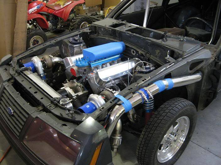

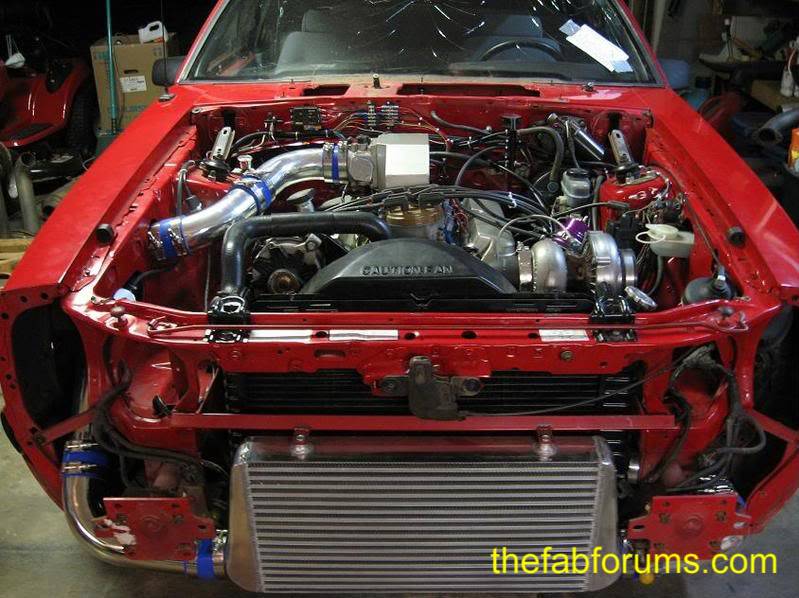

      The advantage to external would be size, control, and looks. External gates can give you more control for low boost or boost controler, because you can use much larger size gates. They also can be put just about anywhere for the proper look. Here are two rides I have done. You can see how freedom of placement helped me on the looks, and symmetry.

      I like the twin turbo mustang, that is how my twin turbos on my 67 camaro are. The turbos I have are internal but I think I am going to which over. I may run the internal for a while and switch over. If I knew how to post pics on here I would post some of my mine project and see what you guys thought and see if there is anything I need to change. I have 57mm turbos what size wastegates should I buy?

      57mm turbo is not going to be big enough If you do run it you will need to go with a large A/R on the turbine side. I would say atleast .96 or larger. I would also go with atleast a 60mm wastegate. The red mustang I posted above is a 306 and I started off with a 61mm turbo with a .68 A/R housing on the turbine, and even though it worked you could tell the small turbine housing was holding it back in the upper RPM range. I upgraded to a 70mm turbo with a .96 housing and it made a huge difference. The turbo would light almost instantly and never seem to quick making power. Boost for both turbos was controled by the 60mm wastegate pictured.
