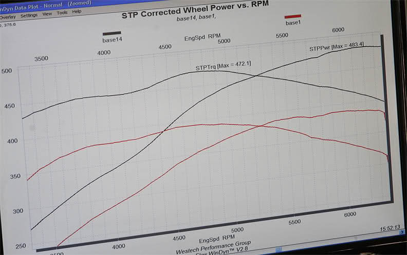

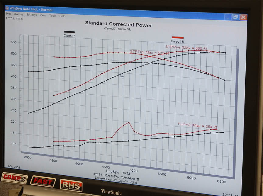

      Here's a dynograph, we were having problems with the XFI running the engine on the dyno and I think the peak numbers are a bit low (was breaking up a bit).
      Still, the low end torque stuff is good.
      Here's the engine dyno (compared to the before engine)
      Here's the chassis dyno (rear wheel compared to with the broken spark plug)
