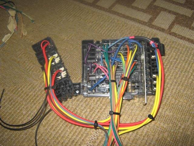

      Here is my setup. It is all new parts that are available at Mouser. There was only one part I couldn't get which hold two additional maxi-fuses. There are 10 relays and 26 fuses.

      what terminals do you have for the regular atc fuses? looking at the minis, they look like what I have/ need. looks like they are mp 280 series? wonder if I can 'make' them fit in my box?
