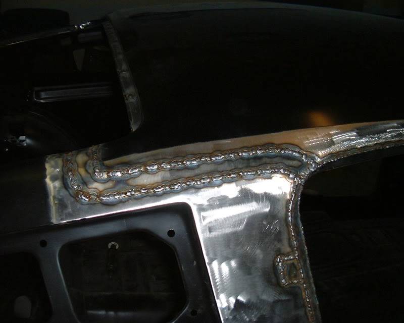

      Quote Originally Posted by rusty428cj View Post
      We did away with the drip rails and welded a patch at the body seam area where the factory had lead.
      That is a great idea cutting out the lead seam.
      I'd like to do the same on my 67.
      Also need to cut off the drip rails, they're pretty rusted.

    8. #28
      Sep 2009
      Port Richey Fl
      775
      All the original metal was left on the new quarter panels and roof panel. Brian made a patch that he welded flush so we used very little bondo after he ground the welds.
      Rusty Gillis
      Former SS/FA & SS/GA NHRA National Record Holder

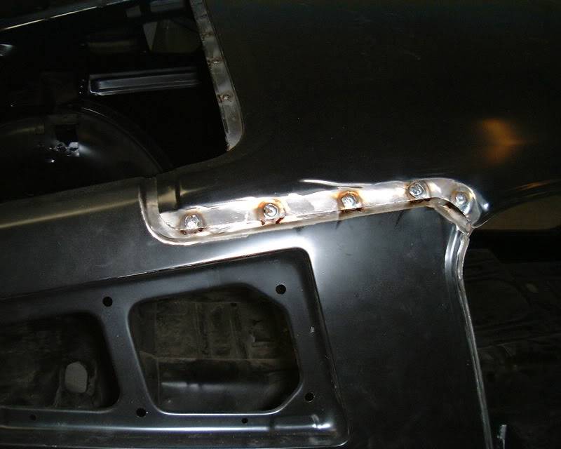

    9. #29
      Sep 2009
      Port Richey Fl
      775
      This is what it looked like before Brian made the patch
      Rusty Gillis
