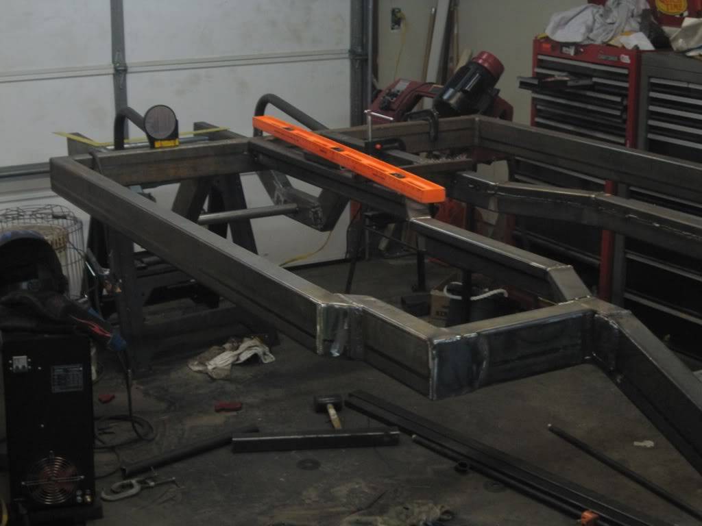

      Not much in the lines of fun pics to show for progress but here's where I'm at this morning.

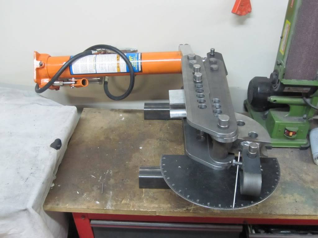

      Yesterday got my tube bender put together. Bought it from tubetek.net; they have a great price and their product is really good. I built a bench top base for it which worked out great yesterday.

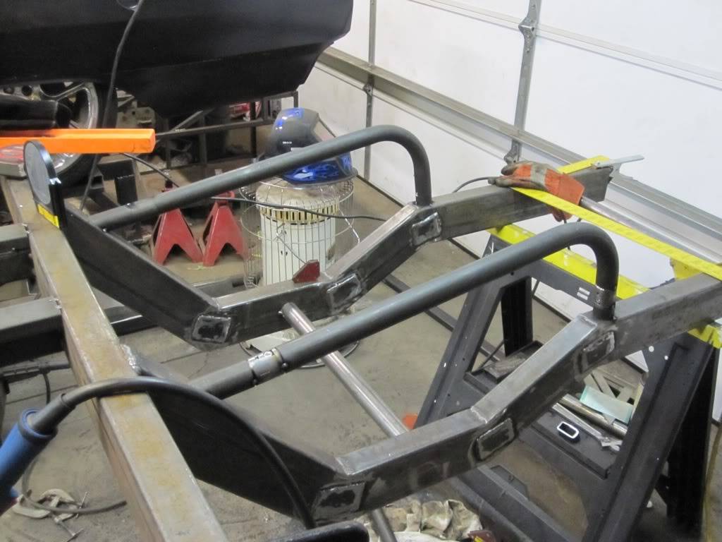

      Used it first to bend up some rear tubes that will pick up the rear lower control arms. I'm using tube clamps on the rear pickups in order to drop the entire rear-end, if needed, but I need to get two additional that should be here Friday. My original design only required using two tube clamps, but I changed it in order to make building the rear frame rails easier, which also simplified these tubes but now I need two additional clamps. The tubes are tacked in place until I can get the suspension mocked up against it and I know the fit is perfect.
      Welded in the rest of the center section on the chassis, with exception of the support pieces that the floor will rest on. I'm waiting to put those in until I can test fit the chassis; I want to make sure the width is adequate for the trans and exhaust routing. This isn't a great picture to see it since the chassis is upside down but I'll try to get it flipped today.
      My new inner rocker panels will be here tomorrow so I finished getting the drivers side ready for those, still need to lay down some weld thru primer but I'll get that today. Sure isn't much left of the original rocker, but this should work out perfect.
      Had some problems with gas flow on the welder over the last few days so we spent a bunch of time getting that worked out. I noticed the problem while welding on my fishplates, they came out looking terrible so I had to grind everything down; hoping to get at cleaning those up a bit soon. Took a while to get it worked out but we fixed the issue (kink on the line inside the machine) and all is good now.
      Today we are assembling my front lower A arms; we're tigging these together. My buddy Dave will be doing the tig work on these so I'm headed to his place shortly. After that, I'll come back and finish getting things ready new inner rockers and installing the chassis for the first time. Hopefully will be another productive day. I still have a lot to do in order to make this thing a roller before I leave but I believe I can do it, time will tell. More to come...

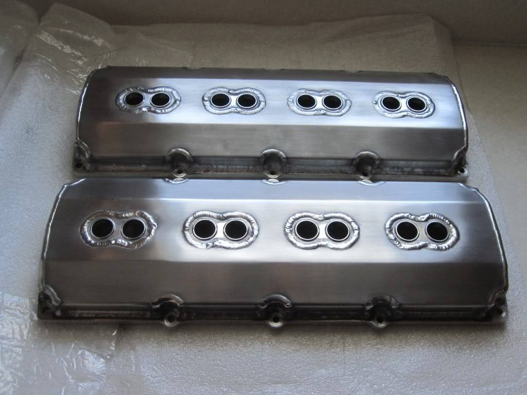

      In the midst of my crazy thrash, I'm still having parts show up. Picked up these sheet metal valve covers from Tim Bruning...

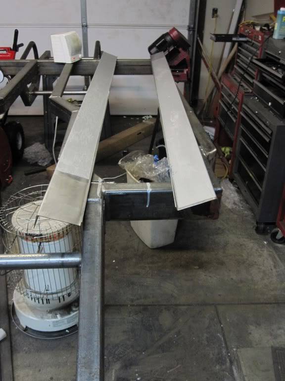

      The inner rocker panels I had Spohn bend up...

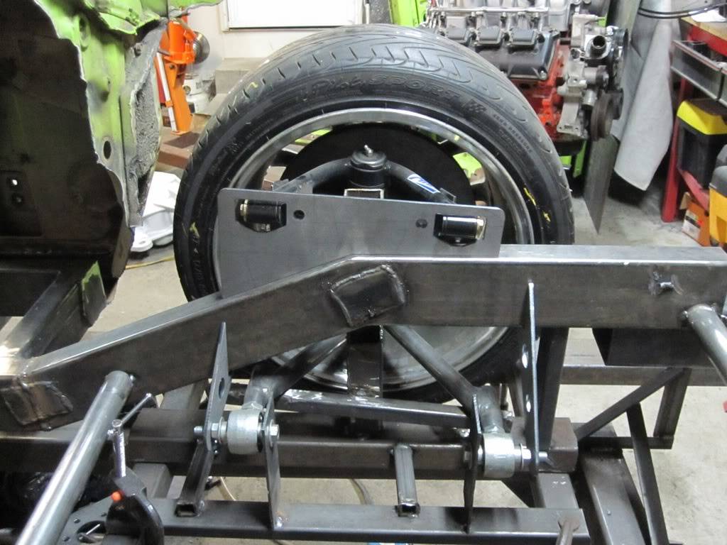

      Here are the lower control arms we built, have yet to put the mounts for shocks on...

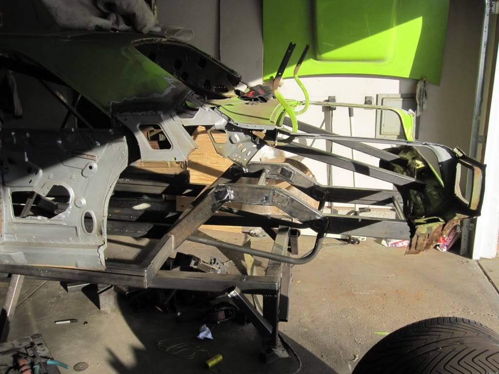

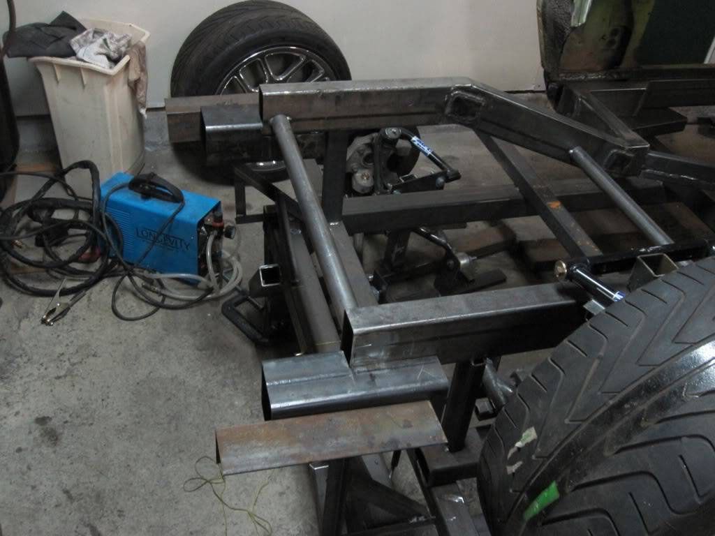

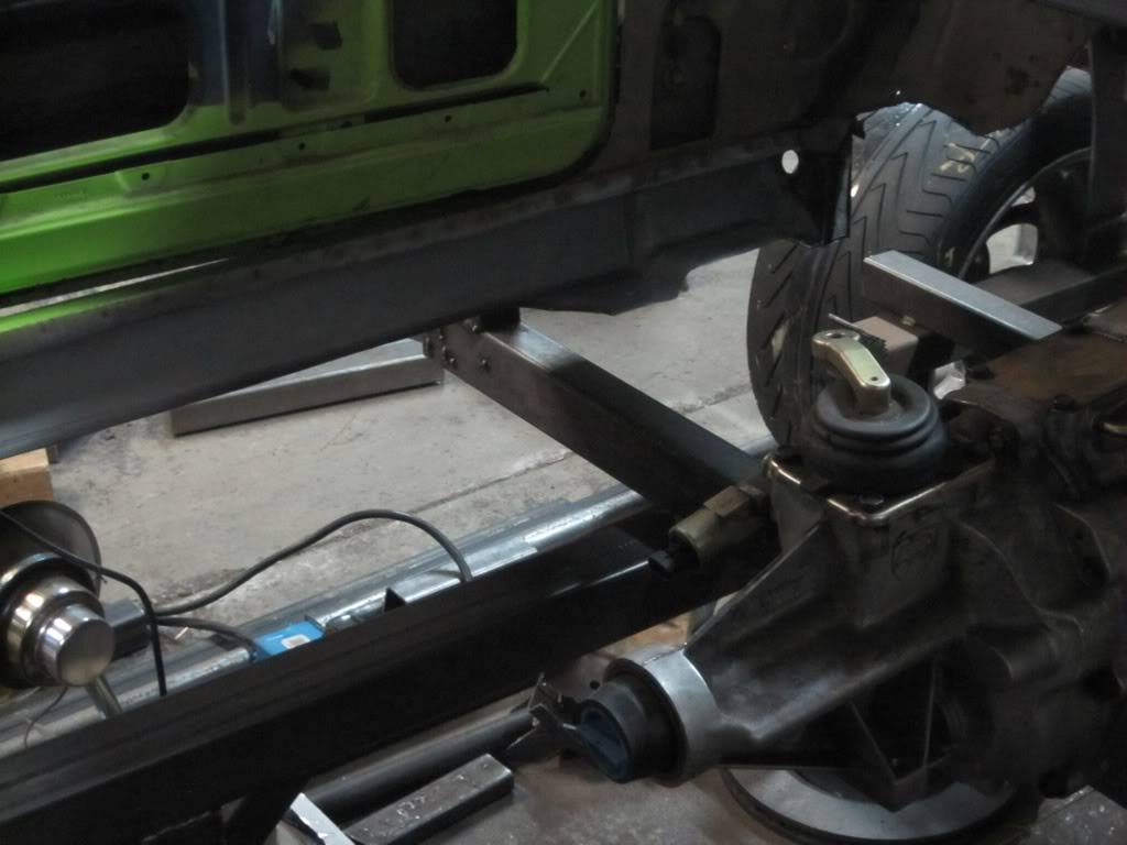

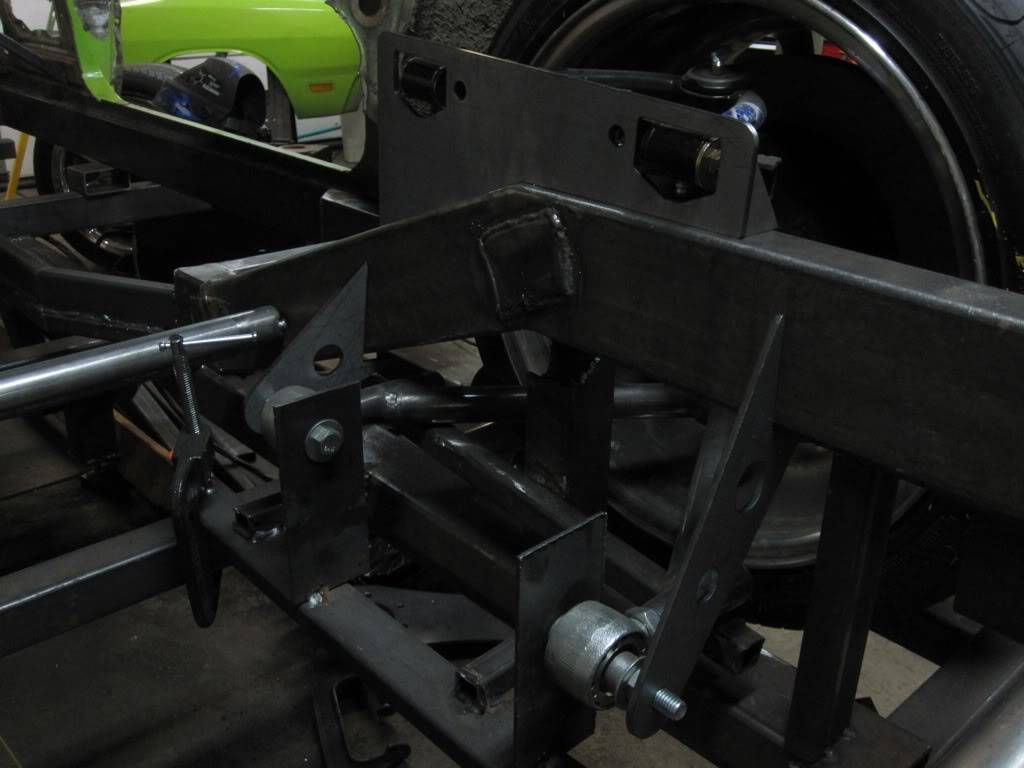

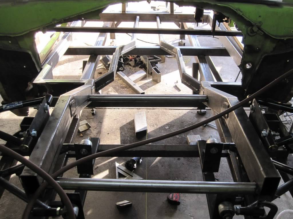

      Got a bunch done today. Welded the chassis into the car, welded the rear tubes in, finished straightening the front & rear rails, started cutting and mocking up the mounts for the front bumper, reset the rear suspension in order to measure for mounts. Also got the first set of front suspension mounts delivered today. The rest of my mounts should be in tomorrow. BIG thanks to Greg (chopsmitty) for helping with these. Here are a few pics...
      I have thought a few times over the course of this build that I never expected to see my car look like this...
      The first step in putting together bumper mounts, these have a LONG way to go...
      Resetting the rear suspension and the rear tubes that have been welded in...
      And finally, the brackets Greg designed and cut for me. Tonight we took measurements for motor mounts as well as rear suspension. Still putting together a tube that will run between the LCA mounts...
      Sorry for the dark pics, my wife leaves and all of a sudden I can't work the camera?
      Hopefully I have another great day tomorrow getting the UCA mounts welded in, more work on the front bumper mounts, starting the rear bumper mounts, and begin adding some additional rigidity to the back-bone of the chassis. All of a sudden that's a big list. More to come...
