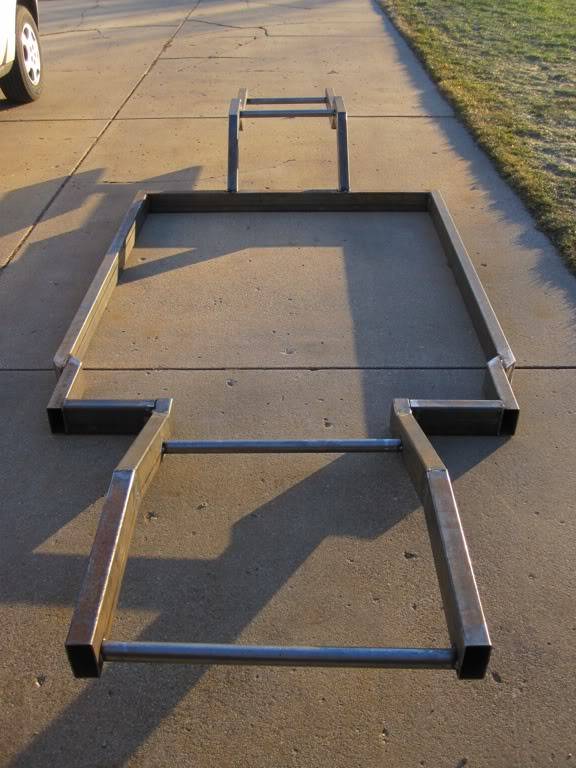

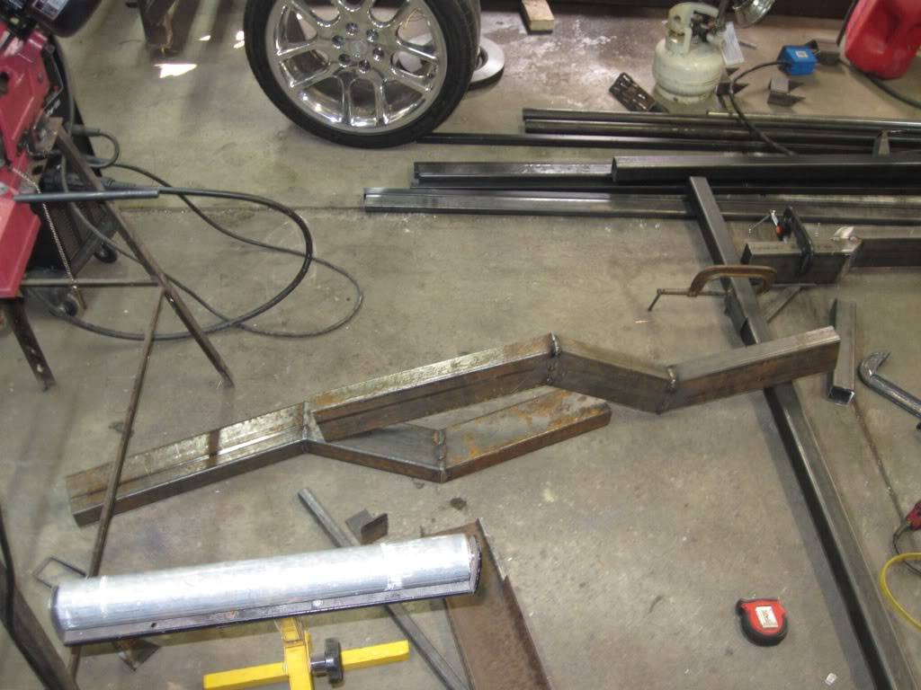

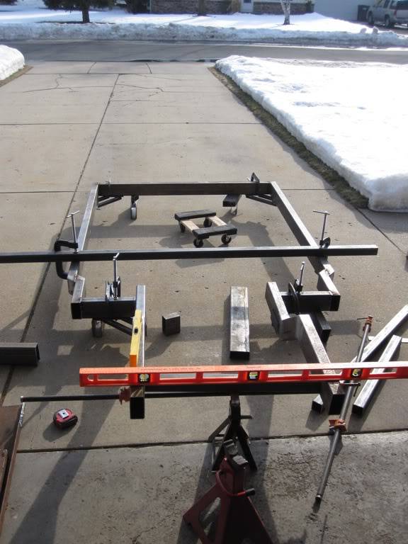

      Y'all better chill!!! Working in the garage all day doesn't leave much time for updates. But I got a few pics for you. All day Monday was spent running around and getting my junk together, a little bit more of that yesterday but then started cutting more tube and getting my perimeter frame rails put together. Also was double checking some measurements on my front spindle to make sure the geometry I have is solid; all is well on that front. So, here are some pics...
      Got caught dealing with jet lag around 10 to 6 yesterday morning
      Getting frame rails put together
      Assembling the front 2/3 of the frame
      And where I'm at now with the frame

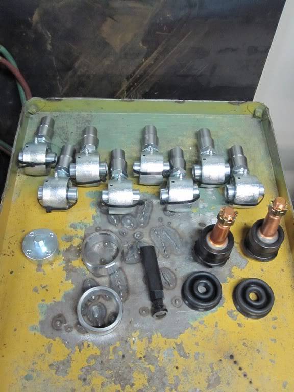

      I've got my welder dialed in pretty good for this 1/8" stuff; now if I can get the operator dialed in I'm good to go... I also started building my jig for the LCA's and will finish that up tomorrow with the hopes of getting the new LCA's put together. I'll get some pics tomorrow, but I received my Del-Spheres from Spohn, those things are beautiful, as well as my Howe ball joints, those are super nice too. In addition to getting the LCA's going tomorrow, I'll be trying to get the rear frame rails finished and added to the chassis along with getting the back brace measured up, cut, and tacked in place as well. If I get through all of that I'll work on the front cross member and hopefully start building suspension mounts this week(end). More to come but things are going well and I'm real happy so far.

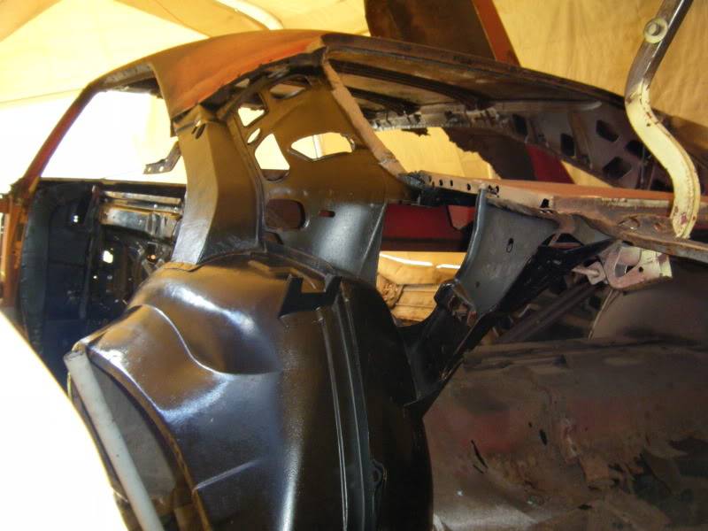

      Great to see more work goin on, just be careful with that surface rust. Id say hit it with the POR-15 3 step coating because you never want your work to rust out from under some paint

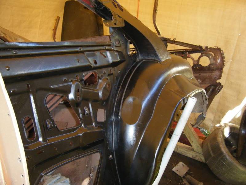

      Its great stuff, here is my before and after. The stuff is hard as nails too and runs into every pore of the metal
      Better shots of the drivers side I did

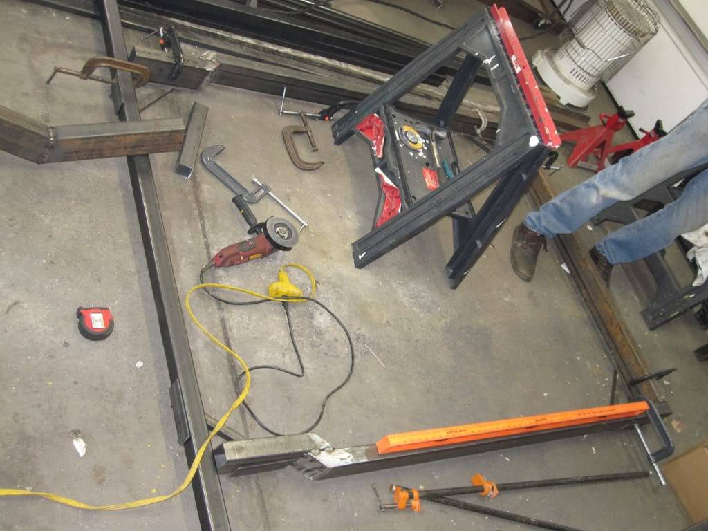

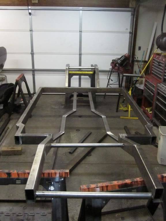

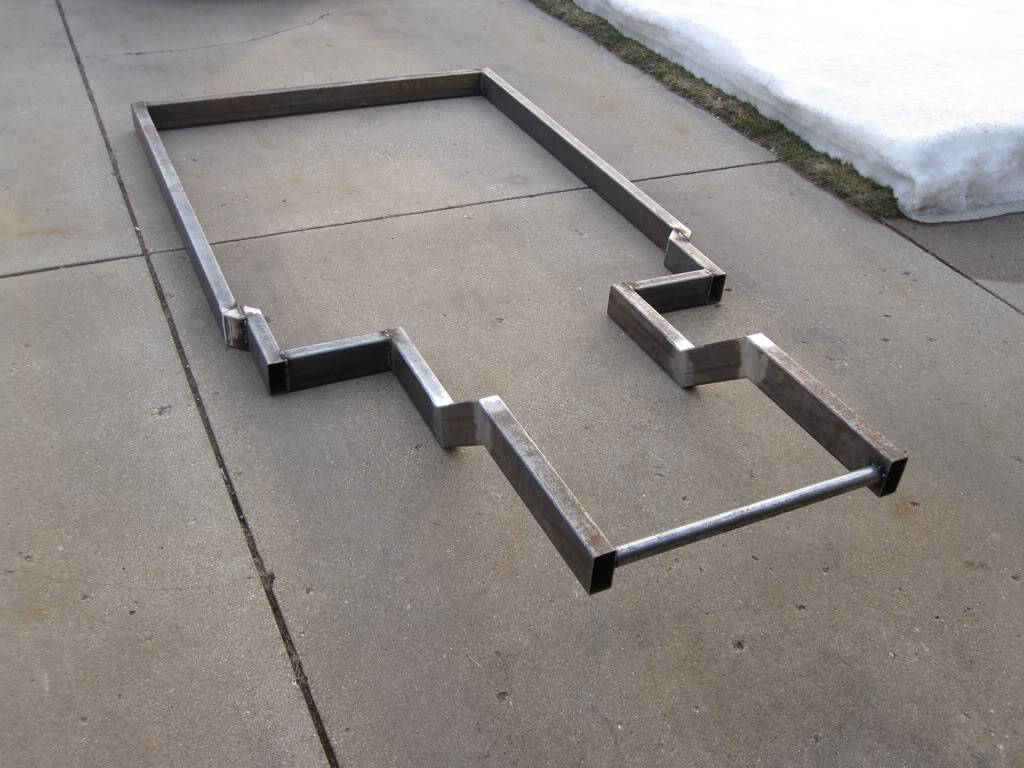

      Here's some progress as of late. Doesn't seem like much but I've been working my junk off! The chassis is almost finished after I had to rebuild my front frame rails; I can do statistics and calculus like nobody's business, but apparently 7th grade geometry has fled through my first set of front and rear frame rails.
      So, I built the rear rails tacked them in place, rebuilt the front rails, tacked them in place...
      ...started building the back brace, tacked it in place, and here is where the chassis is at...
      I have a lot more to do on the back brace to strengthen and finish it but I ran out of material since I changed the design. I'll pick some up and get it finished up tomorrow.
      After double checking all measurements I welded the chassis solid and began the fishplates. I've got all the fishplates cut and tacked in place and will get those locked down tomorrow as well. Tuesday I'll begin working on suspension mounts and front cross member.

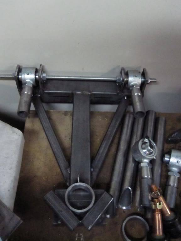

      While all this has been going on, more parts have come in, Spohn Del-Spere's, Howe Balljoints...

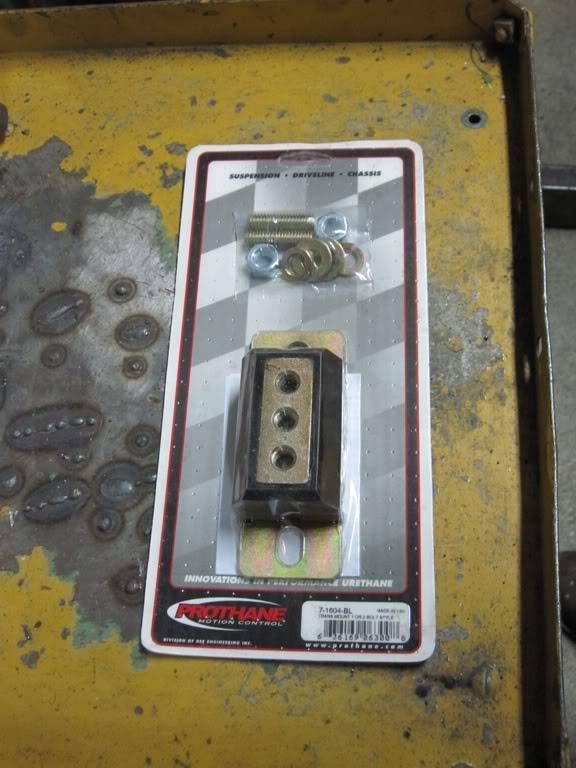

      Trans mount when I get there later this week or first of next...

      And finally the jig for my LCA's...
