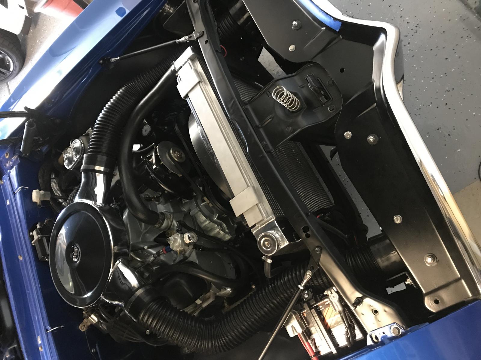

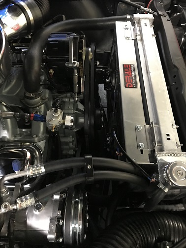

      Well.......my MarkVIII fan melted down this last weekend at the Ford Connector, so I went a different route. I installed a Derale 2 fan setup, got rid of the DCC controller, and went with a Davies Craig 2 relay setup. Hopefully this works better. I just need to add some spacers to where I mounted it up and will make some kind of cover for it.
