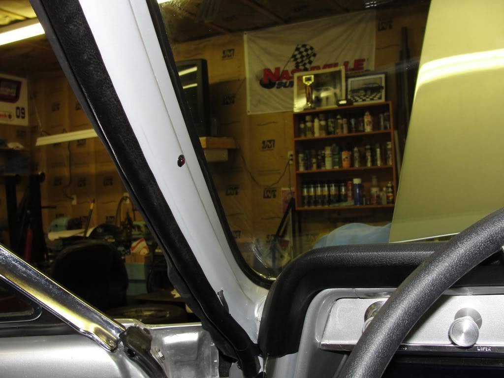

      We had this great idea last year when we installed the accusump, but ran out of time before heading to Vegas. Now, with a little more time and since I've been in the wiring mode, I've installed this red LED light on the A-post (windshield pillar) right at eye level to let me know if the accusump is activated. Seems like it's something I might want to know...

      Hey now that is an idea. with out it you ASSUME it is working. And we know what that means (ASS U ME) Yea it hurts to say that!!HAHA

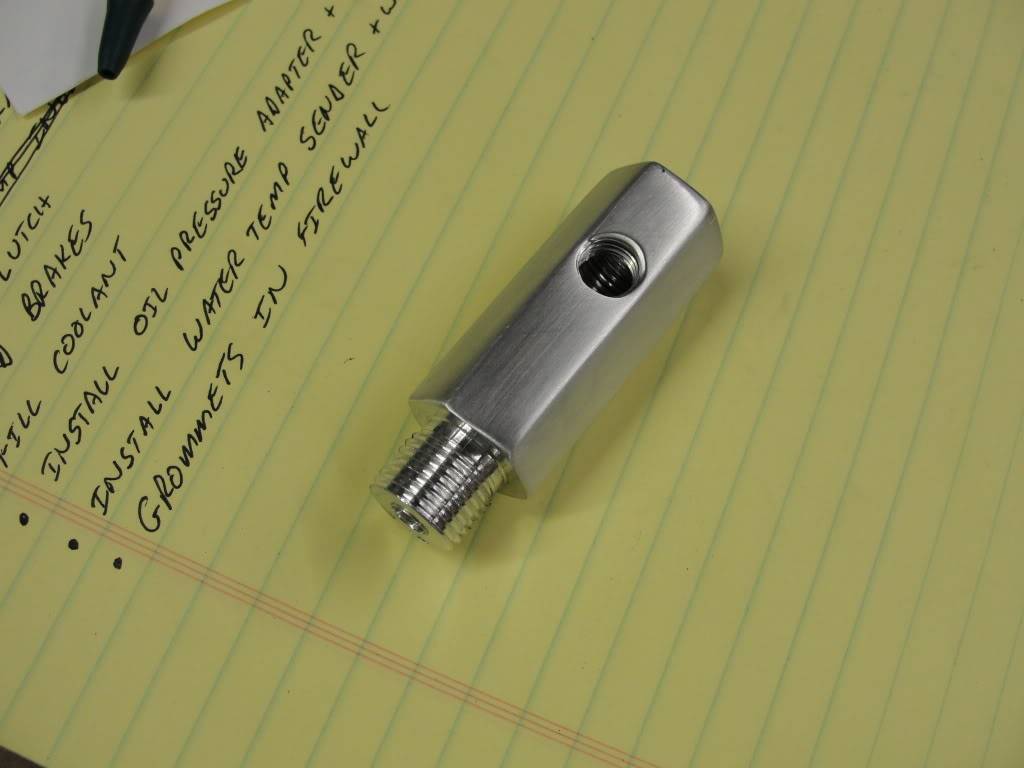

      I failed to post this previously because I was so sick about it. When we originally started the "new" LS motor I was shocked at the 23 pounds of oil pressure at cold idle. It really had me perplexed (and worried) for a couple of days. Once I started going over all the possibilities in my head I realized that the Dakota Digital gauge would read EE then flash to 90 back and forth when I turned the key on, but when I started it, it would go straight to 23 and go down if I revved it. So, I called Dakota Digital and talked to a tech guy who immediately informed me that the oil pressure and water temperature would not read correctly using the LS senders. Which also meant figuring out a way to adapt the 1/8 NPT oil sender that came with the dash and coming up with an adapter for the water temperature sender. I ordered a 16mm extension that was tapped for the 1/8 sender from Street and Performance and Dakota Digital came up with a metric VDO sending unit for the temp gauge. Dakota Digital really impressed me with their customer service in both the tech and sales department. I can see another one of their dashes in our wagon or Sam's 67 in the future.
      Alright, bottom line, after I sorted out the new sender, I had 60 psi at cold idle. Whew!!!
      Here's the 16mm x 16mm x 1/8 NPT fitting (it was polished, but that really isn't our thing...)

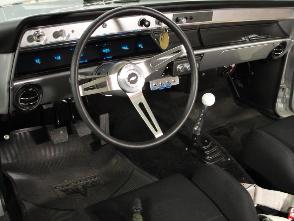

      Here's an interior picture that shows the dash (recently cleaned!), the new shifter lever from the Roadster Shop, and pedals that we pictured before. It just all looks better now that it is running again!

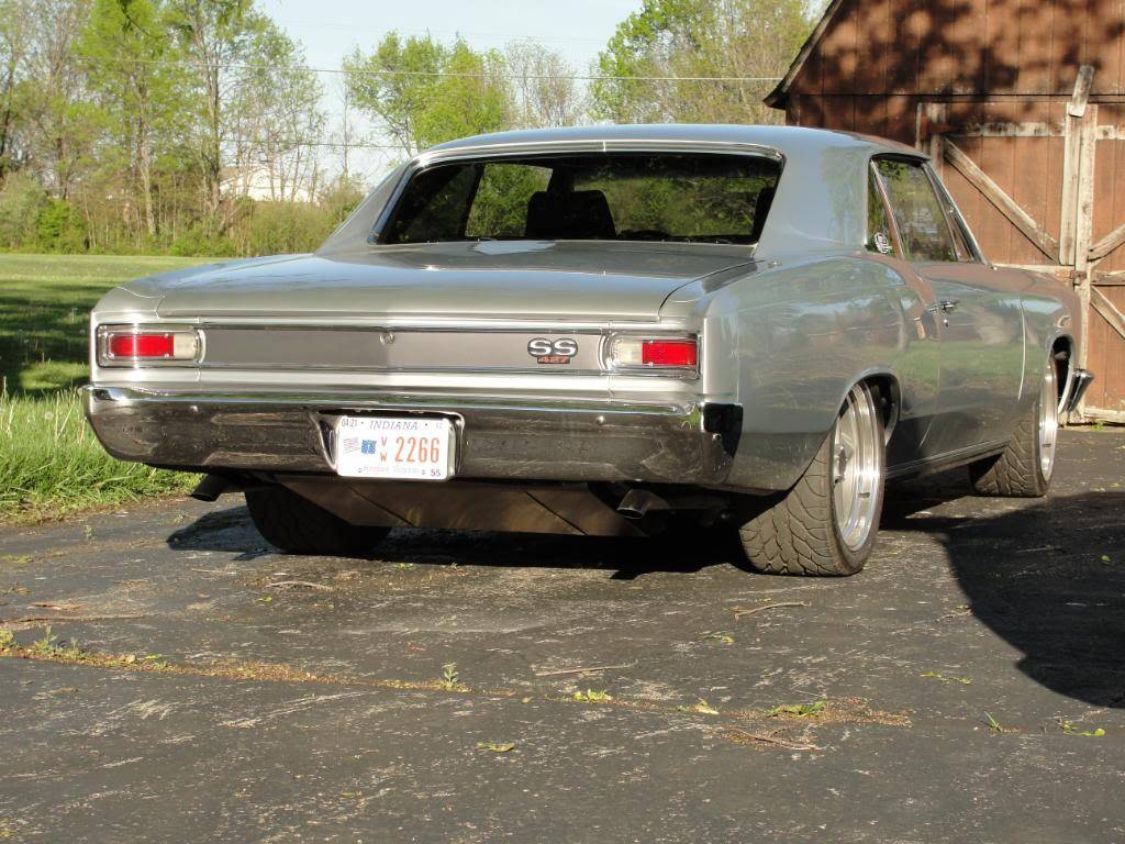

      Here's a rear picture. I never thought we would worry about ground clearance in the back. We're thinking about cranking the coilovers up 1/2-3/4" just to be safe.
      Don't you dare raise the rear on this thing! It sits PERFECT!!!

      Yeah, who am I kidding, we love the way it sits! LOL

      That's my issue with the tank. It hangs down but damn i want it.

      we do have a skid plate that is not being used....LOL

      Does the tank hang below the axle? It looks odd in that photo.

      Maybe it has added capacity which will make it hang lower.
