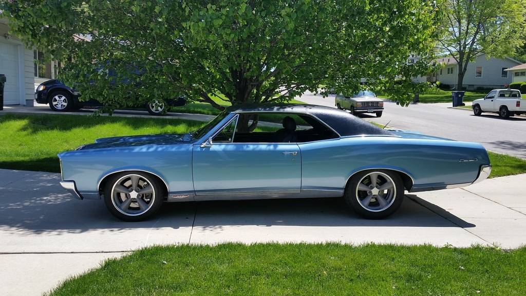

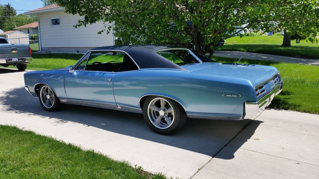

      Spent yesterday cleaning up my ride height and washing the old girl. Both were long overdue and we had a big local show yesterday and I have a fun cruise today. This has been a battle. My car has a nasty A body pimp lean to the driver side. From all I gather its not too unusual really. I had the same frame shop that straightened my frame out originally, look it over last week. I thought I may have warped the frame a bit when I boxed it. The results were that it was straight as an arrow and way better than anything that ever left GM. So it was time to mess with some shims. Originally I had shoved a ton of shims in there just to get the car going with the other wheels and tires. This resulted in a high ride height in the front and a car that was all over the place side to side. Anyhow this is the kind of stuff that isn't really fun to do but the end results are good I think. The nose came down 1-1.5" and the rear came down just a hair as well. With the proper shimming right to left i'm within a 1/4" in the front and maybe a 1/2" in the rear. Its unnoticeable without a tape measure from all angles. I might mess with the rear a little later on to see if I can dial it in but for all intents and purposes that's good enough. I also have a bit of rake. I think the GTO's just look a little better with a touch of rake.....

      Your car looks good. I agree with a "touch" of a rake.

      Man Nick, that looks fantastic!

      Since I dropped the nose? I guess I haven't had it out on the interstate yet....that is a good question. It would change my drive line angles wouldn't it?

      Changing the front ride height has zero effect on driveline angles, only the rear ride height effects driveline angles.

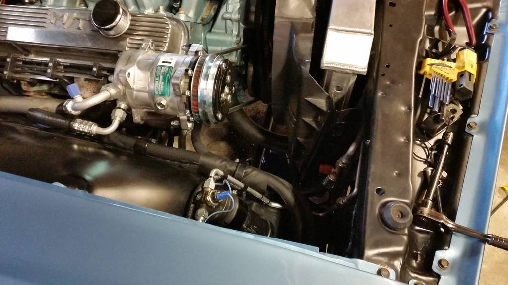

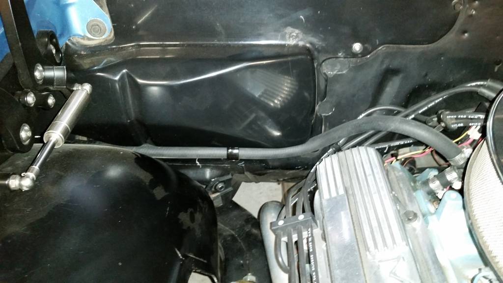

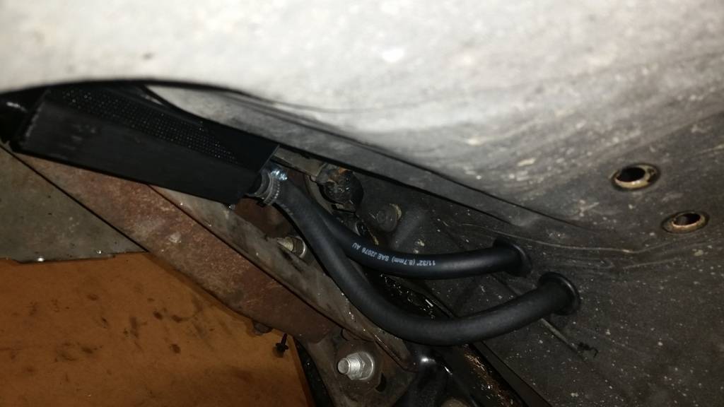

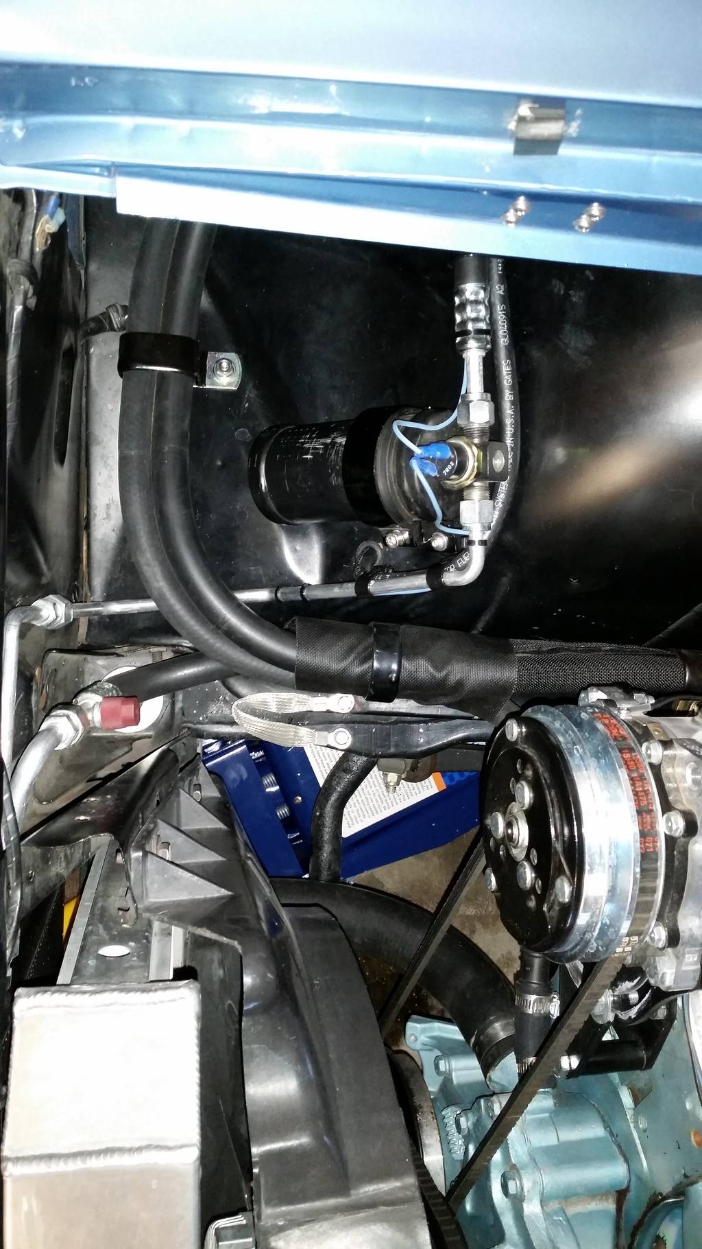

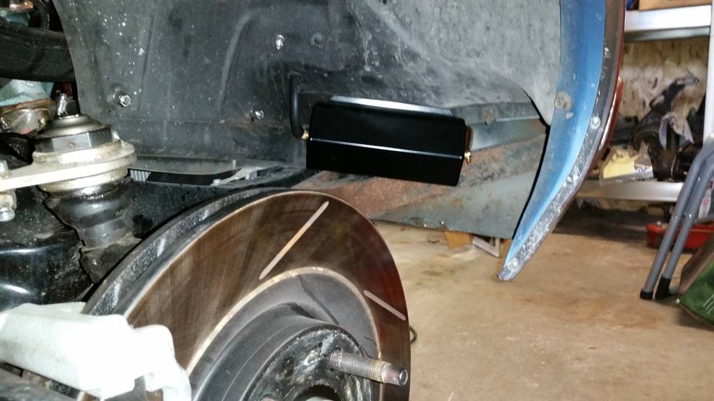

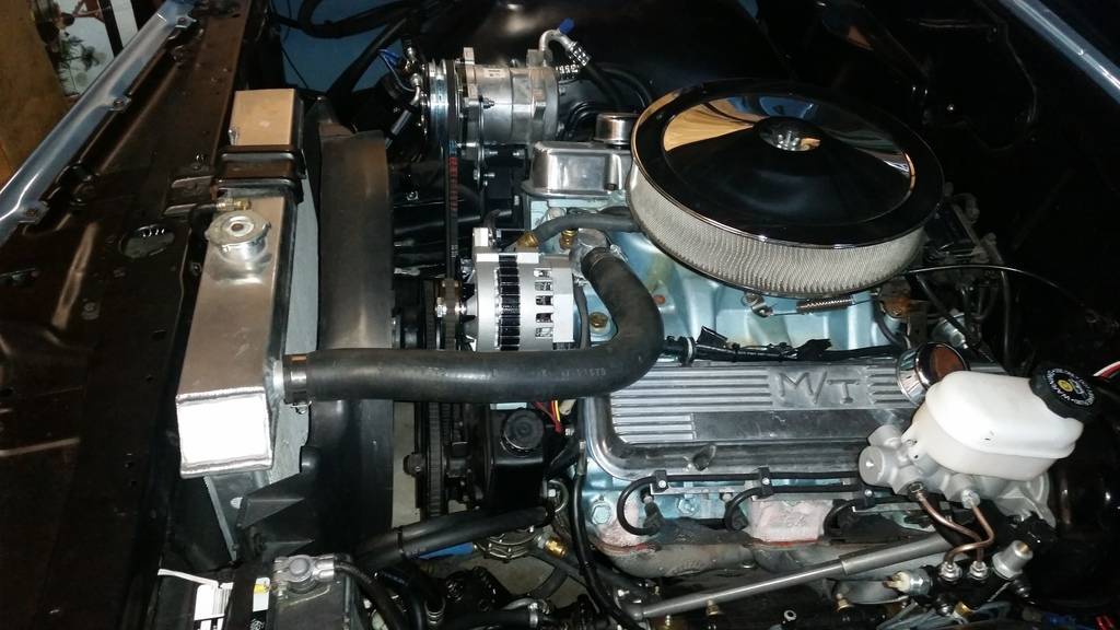

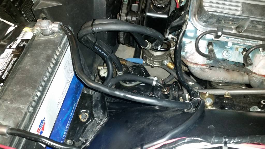

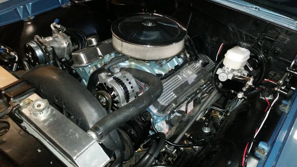

      The last few weeks iv'e gotten a few more things done....

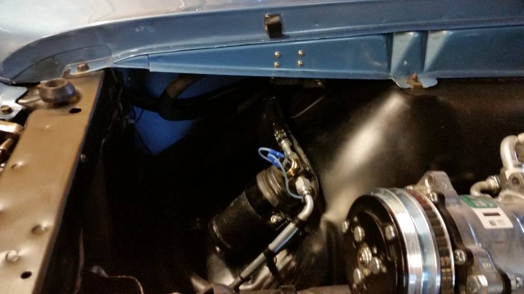

      -I finished up my Vintage Air. Its great to have a functional AC/Heat/Blower system back in the car. It was a huge PITA to be honest but I'm glad I did it. The heat is hot and the ac is Ice Cold!
      -If you notice the 4 SS screws in the fender in picture 2. That's where I mounted the electric coolant valve and then I doubled back on the coolant hose to the rear of the car as seen in picture 1.
      -In pictures 3,4,5&6 you'll see I used VA's lines but cleaned up the suggested install. I tried to keep the install as clean as possible without flopping stuff everywhere. You will also notice an aluminum bracket I bought off Ebay to mount the dryer. It was about 13 bucks and looks a world better than the strap VA gives you. I also need to do a quick scuff and shoot on the dryer its mounting. It got scratched up pretty good with all the tinkering around.

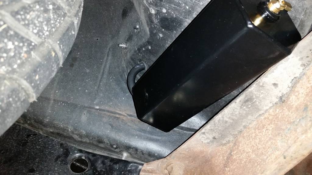

      -I also relocated a new radiator overflow can to under the passenger side fenderwell. Although the canister is sideways I don't see any sort of issue with this and it's out of the way of everything. Its also running downhill so it should be easily drained. Worst case is that I have to unbolt the canister and drain it. That would take all of 5 minutes where its at.

      Nicks67 i installed vintage air in my 67 also. Did you crimp the lines yourself or did you bring it somewere to get it done. If you did how much was it. Just currious.

      I did everything but crimp the lines and charge it. I took it to a local radiator/AC shop. They did the crimps and charge for around $175 bucks.

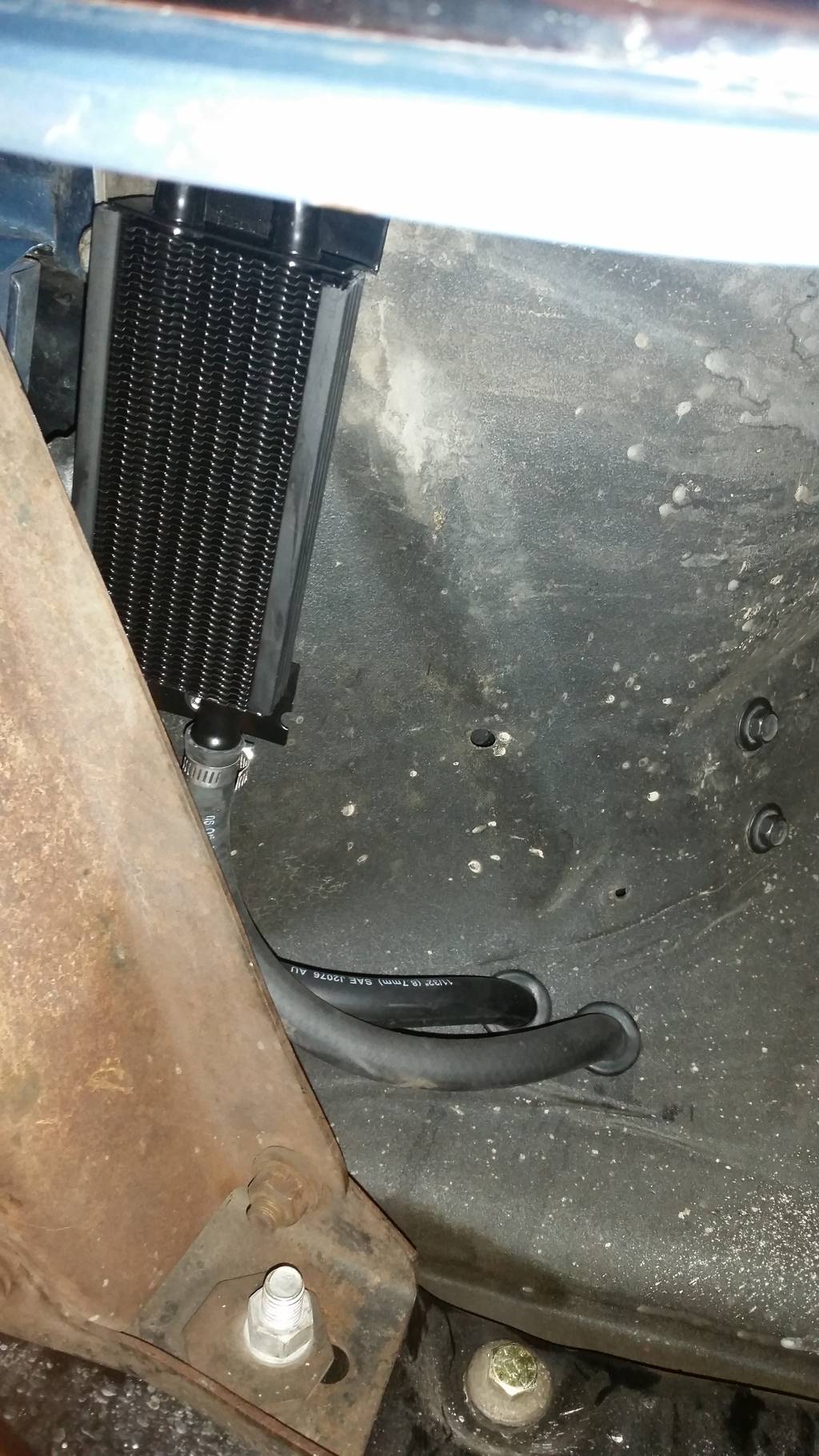

      The last few weeks I did a little work. Nothing too cool but progress is progress. I added a Derale power steering cooler to the underside of the driver side fender by the front bumper. I drilled some holes in the inner fender, used rubber grommets and ran the lines through under the battery. It should get plenty of air and be protected under there. I also added a new 150 Amp alternator from http://www.qualitypowerauto.com/ I don't necessarily need it right this second but my old alternator was just that....old. This gives me room to grow with my electronic parts like EFI, electric fans and fuel pump. Install was bolt in and all I had to do was parallel another #10 wire from the alternator to the starter post.
