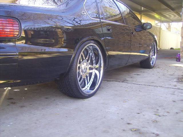

      Why dont you go with a 315/25/22 instead.Here are some on my SS with 22x11 rims

      A 25 series tire is too small for what I need. My motor is a 632 merlin and if needed I will back half the car, so custom wheel tubs is a must. The rear is being shortened 4 inches. Really would like a 40 series or bigger and atleast a 14 inch wide tire. Still need to research what is available for tires out there.
