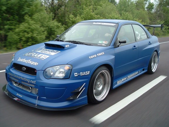

      This is the color I've kept coming back to. Satin White Pearl, Don't know what brand paint
      Below are BASF Carizzma Flat paint/clear. Different colors to give you and idea of finish.
      http://www.carizzmacolors.com/news.php
