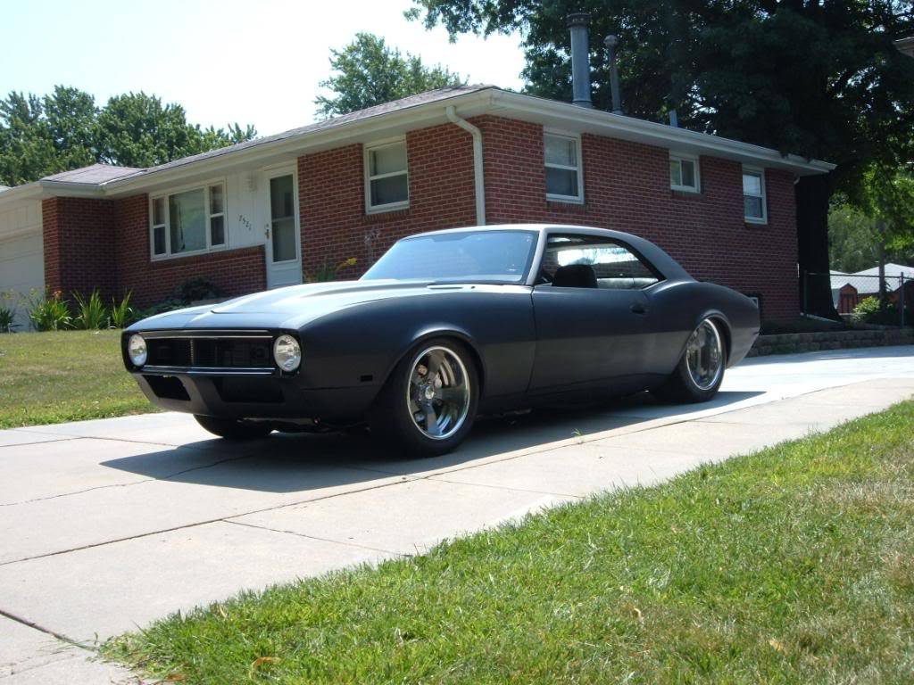

      does flat black show swirls ? i want to paint my camaro black but i dont want to have to deal with all the swirls and the tendency to show scratches very easily! and flat black has a sort of shine or clear coat to it right?? and how does the texture feel when its painted??? thanks dom

      shows scratches WORSE than gloss..
      and you can do flat clear coating.

      what would you consider this?? satin?? i like how its flat in color but has a shine to it as well! this is how i would paint it, MR. Vengeance did u have a clear coat on the gto? cuz ur car was one of the reasons i want to paint mine flat black

      Just an FYI if you do goes this route it looks badass but it's hard to keep it that way. You can't just go buff out scratches and put wax on it. The way I did mine was satin black with a single stage paint. I'm thinking of doing a different paint next time in the future. It's really hard to keep swirls or any imperfections awa it feels just like paint there is no texture also. You will have to put flattener in the clear f you go this route as well , if your going flat try hot hues black from dupont

      what we always did for a guys race car was have 33% flatener added to the paint nad it came out very nice, he used the cleaner/polish/wax for black bumpers and it looked ok but I would talk to paint companies first, see what they recommend.

      Another option would be to have your car wrapped in flat black vinyl. I've seen this done on a new Nissan GTR and it looked great. I've been told that the vinyl lasts 5-7 years. Just long enough change your mind and color too? Just a thought.

      That black car in post 3 is a vinyl wrap. In fact most of the exotics you see in satin are wraps so getting that look in paint is next to impossible.
