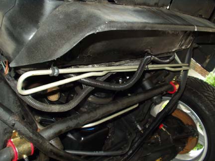

      If it's a heat issue, you could try using this p/s cooler off a 1989 F-body - Edelmann P/N 91959. Here's a pic of it installed on my Monte -
      Sorry, ignore the sloppy fan wire harness, I've cleaned it up since then.

      I have one of those on my 2nd gen. It came with the WS6 box so I figure WTH.
      I also installed a magnfine filter inline. I read about them here, again I figured it would not hurt. Rockauto carries them.
