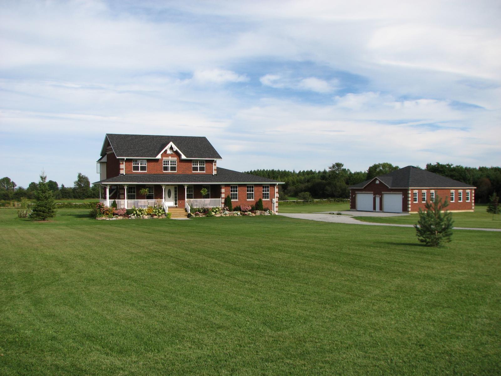

      One thing I didnt see anyone mention is brick! I love Brick.
      Radiant heat and my hoist. The three best things I did.
