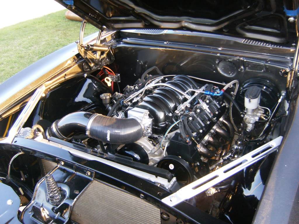

      well the new engine is all done and in the car. Man, does that thing pull too!

      Quote Originally Posted by Rybar View Post
      Great looking firebird and build. Entire car looks killer. love the painted grille and the colour.
      What are the specs on the motor? Looks like an iron block LS?
      thanks for the compliments.
      the engine is an LQ4 bottom end with a set of L92 heads, LS3 intake and a Comp cam with .600" lift and 226/230 dur at .050" She runs and sounds awsome!
