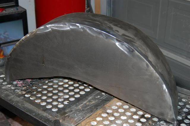

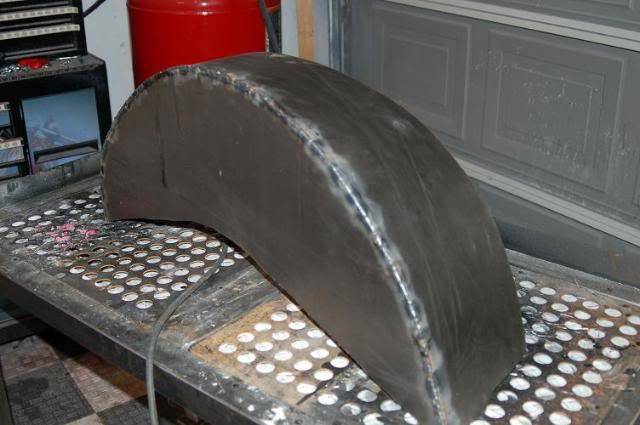

      Impressive work. I was going to roll the lip on my car but you've got me curious about your method. Do you have any images of the work you did on the wheel well ? I'm curious on how to tie in the round bar. I would also like to see what you did to the A Pillar since you removed the drip rail. Thanks in advance.

      Im not there yet. I just cut them off for now. I just figure it will be a lot easier while the car is on the rotisserie.

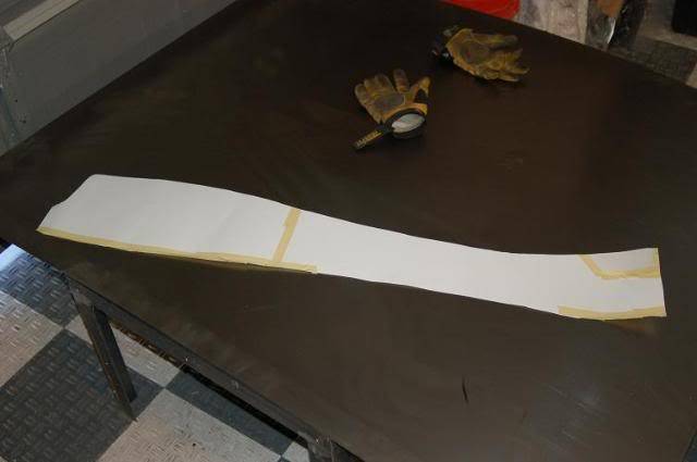

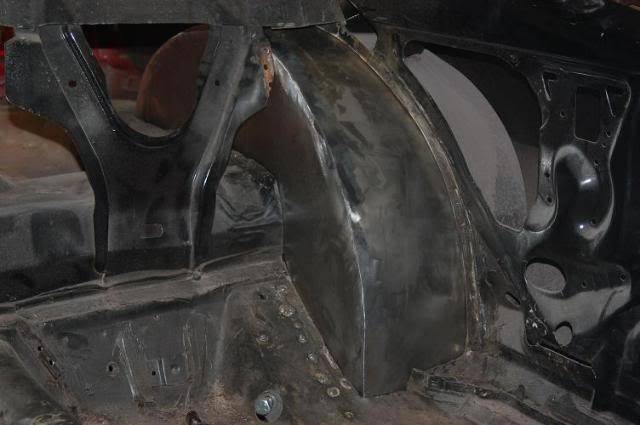

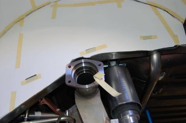

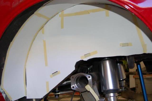

      Got a call today from Fedex. Looks like the Magnum Trans will be here Monday:yes: Now I can get that LS2 off the create stand and get them paired up.

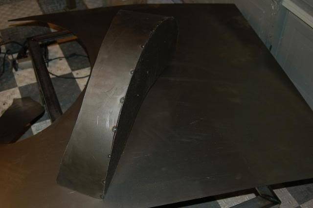

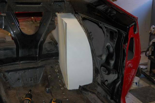

      After getting the rear clip tacked in I put the DSE tubs in there locations. I didnt care for the way they hide the Morrison frame rail. I want them to butt up to the rail and not overlap it. Im also running 345mm rear tires. I need all the room I can get. So I pulled out the poster board and started cutting it up. Heres what I came out with. This part has been fun for me because Ive never done fab work like this. Its givin me some time behind the welder. Its not welded in yet, I wanted some feedback first. Thoughts??

      Your doing some amazing work! The AME stuff looks fantastic.
