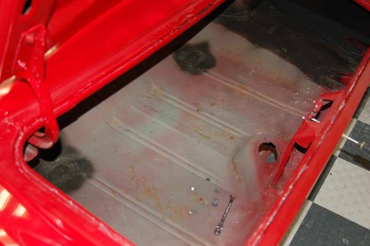

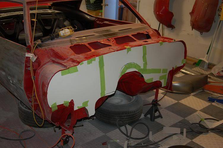

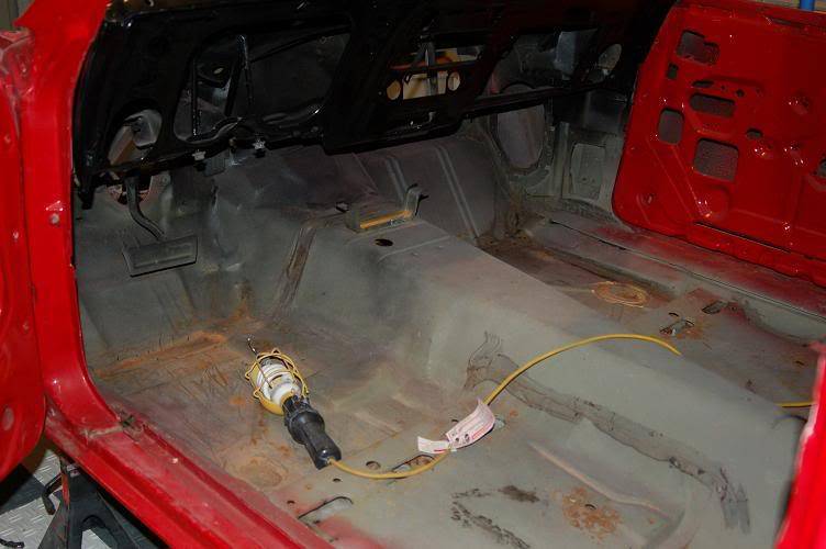

      Getting some of paint off and getting ready to fill the firewall.

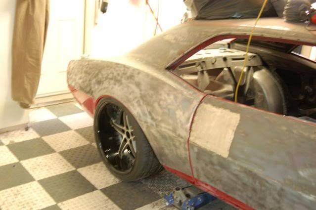

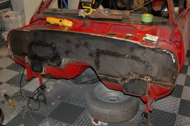

      Got the metal cut out and fitted. Also shaved the trunk lock and pass side door.

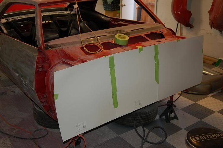

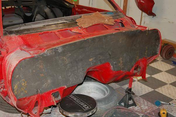

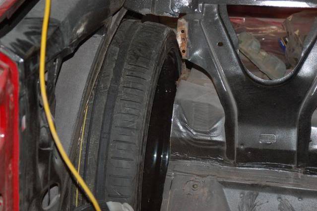

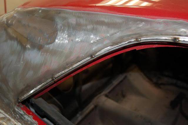

      I cut the lip off the wheel wells today. I left 1/4 inch of lip. Im going to weld in a piece of round bar to finish it up.
      I placed the rear wheels under the car so I could get a measurement for my rear end. Its 54 1/2 to the center of each pad. Tomorrow I call and order my Morrison rear end! Woo hoo

      A tip on the round bar for your fender lip: use 1/4" stainless steel tube. It is easier to form, resists rust, and welds in easy.

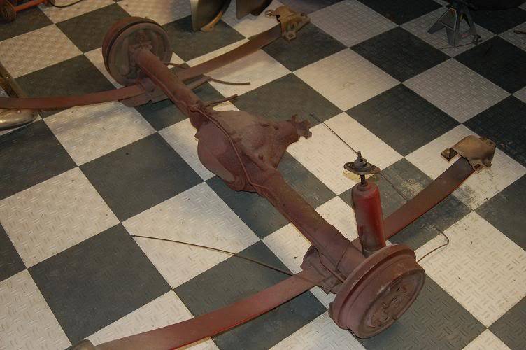

      Well got the call today. The shipping company called and said my "car frame" was ready for pickup. I ran down to the yard and they loaded it up. This baby is nice! Morrison did a heck of a job! A second shipment should follow soon. It will have the axles and gears.
