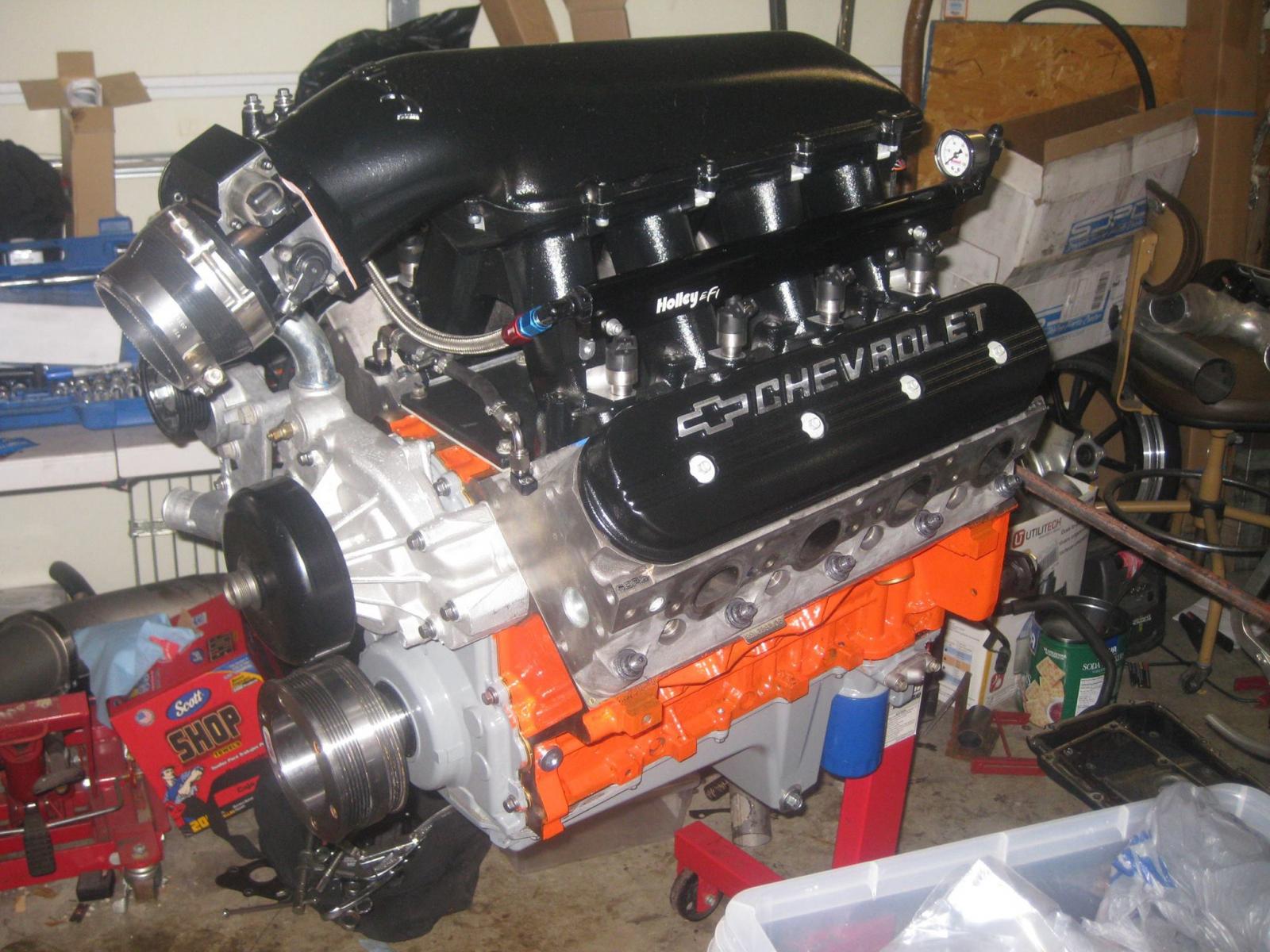

      Here is my project. 87 Monte Carlo SS
      Specs
      383 LT1
      Forged Eagle Rotating Kit
      LSX Killer Trickflow Heads
      Custom Supercharger brackets for Powerdyne BD11a running 8Psi
      Built T-56
      9" Ford Rear 3.70:1
      Hotchkis TVS Suspension
      Bilstein Shocks
      Custom brackets for C5 brakes
      LS1 Rear Brakes
      Hydroboost from Astro
      Still working on it. Next is paint and body
      87 Monte Carlo SS 408 LSX S482 Holley EFI 4L80e
      92 GMC Typhoon Built 4.3l Vortec Heads Baby Billet 25G Turbo

      Cool project! Explain if you will the electric water pump on an LT motor?

      I installed the electric wp to free up some hp. I also installed a dual roller timing chain on the engine getting rid of the factory drive coupler for the factory wp.

      what kind of wire looms and spark plug wires are u using. also did u have to make that brakets to the superchrager? i was thinking about putting supercharger on my lt1 but didnt kno if i had to make a braket or not

      I am running a RM wiring loom kit from Summit
      http://store.summitracing.com/partde...5&autoview=sku
      With a set of custom MSD Wires.
      I custom built the bracket out of 2024 1/2 plate aluminum. I am running a underdrive pulley to run all the accessories and a Jegs SFI damper to run the SC. I was also able to use the factory style tensioner also.
