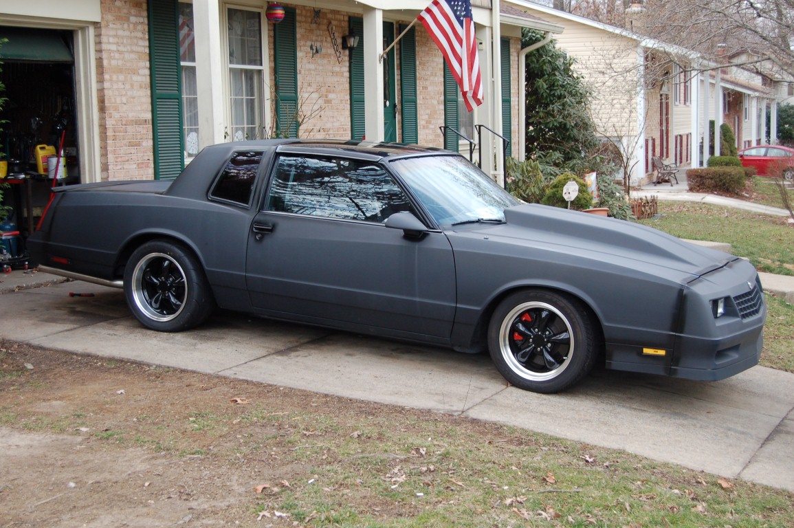

      Here is my project. 87 Monte Carlo SS
      Specs
      383 LT1
      Forged Eagle Rotating Kit
      LSX Killer Trickflow Heads
      Custom Supercharger brackets for Powerdyne BD11a running 8Psi
      Built T-56
      9" Ford Rear 3.70:1
      Hotchkis TVS Suspension
      Bilstein Shocks
      Custom brackets for C5 brakes
      LS1 Rear Brakes
      Hydroboost from Astro
      Still working on it. Next is paint and body

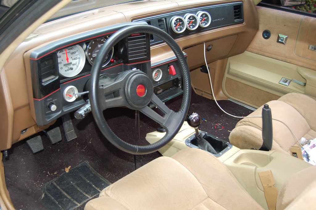

      Some interior pics

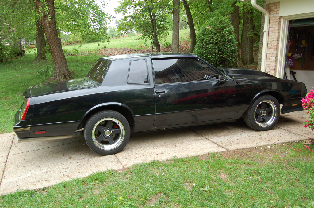

      Thanks.
      Still have a lot to do. I plan on running some 17x10 or 11's out back with some 315's. I have 255 out back now but the car is traction limited So in the next couple of weeks I plan on doing a frame notch.

      badass MC. that is one car I would not want to mess with. what did you use for your pedals?

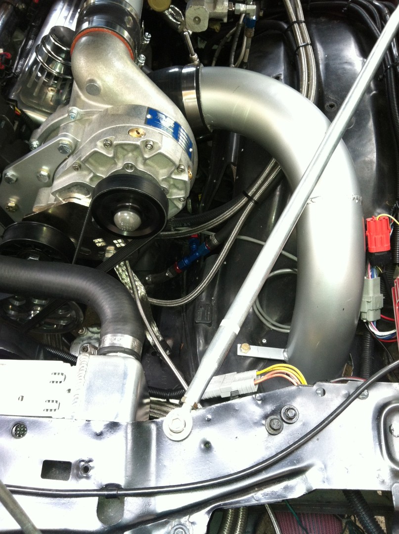

      what kind of wire looms and spark plug wires are u using. also did u have to make that brakets to the superchrager? i was thinking about putting supercharger on my lt1 but didnt kno if i had to make a braket or not
      https://www.pro-touring.com/forum/sh...ad.php?t=22724
      is there an AWD Vette somewhere?
      I had a AWD Trailblazer SS a couple of years ago. As for the pedals I had a 95 F-Body clutch pedal the i extended about 2"

      Quote Originally Posted by lt1chevelle View Post
      I am running a RM wiring loom kit from Summit
      http://store.summitracing.com/partde...5&autoview=sku
      With a set of custom MSD Wires.
      I custom built the bracket out of 2024 1/2 plate aluminum. I am running a underdrive pulley to run all the accessories and a Jegs SFI damper to run the SC. I was also able to use the factory style tensioner also.

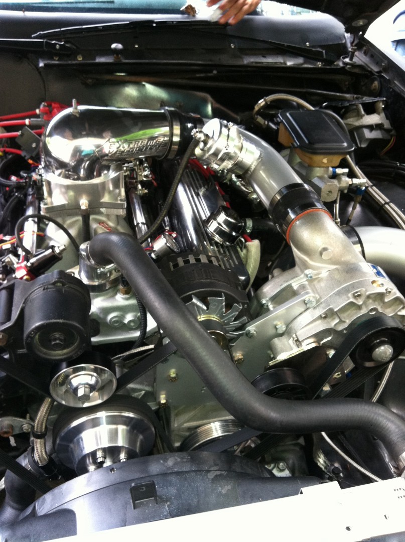

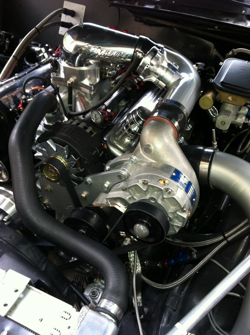

      Updates:
      The 383 LT1 I had decided to snap the crankshaft (Eagle)... In 3 places... In my driveway. Ended up putting a ATI Procharger D1SC on her running a little too much boost. So I pulled the engine took it to the dump. Took the majority of the parts and sold them. Then let it sit for a year...
      Its back together again... Sporting a new setup..
      Specs:
      1970 4 Bolt 350 LT1 Block
      Lunati Sledgehammer Crank
      Forged Rods / Pistons
      AFR Eliminator Vortec Heads
      Howards Retrofit Roller Cam
      Edelbrock Pro Flo EFI Intake Manifold
      Fast EZ-EFI fuel injection
      MSD 6AL2 Programable Ignition
      TH400
      3200 Stall Converter
      C5 Vette Front Brakes
      LS1 Rear Brakes
      9" Ford 31 Spline Mosers
      OPGI 2/3 Drop Springs
      Bilstein Shocks
      Procar Scat Seats
      3" Pypes exhaust system
