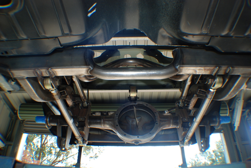

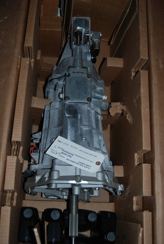

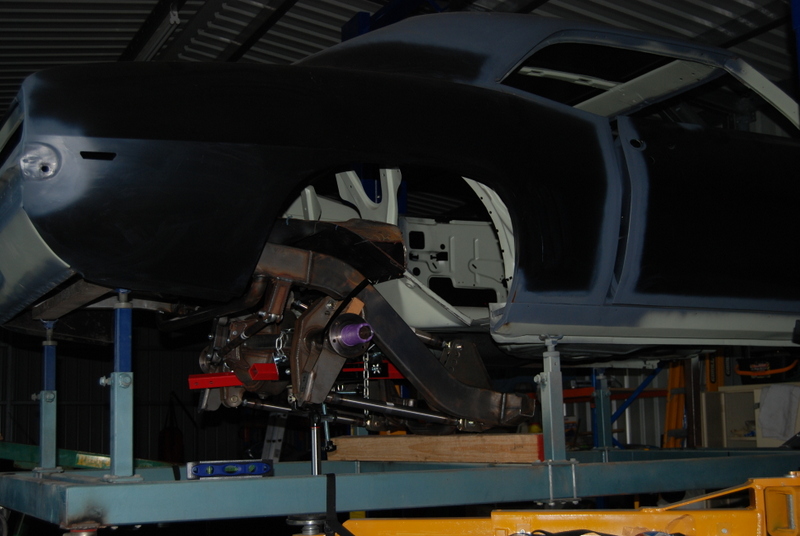

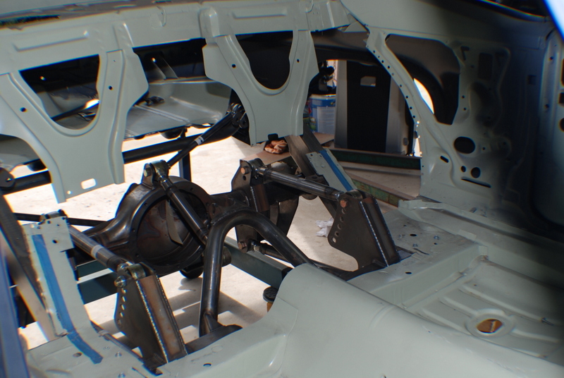

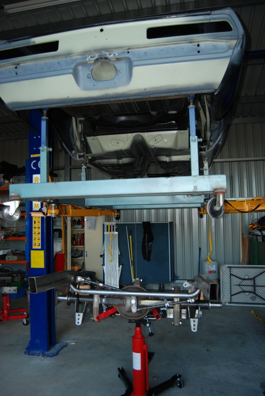

      I will install the rear over the next couple of weeks, it has to be welded in, but I have to cut the floor out for the 3 link mounts first. I start to moch it up in place to find where I need to cut. Then I will start the cage and trans tunnel mods, my T56 Magnum tranzila arrived as well.

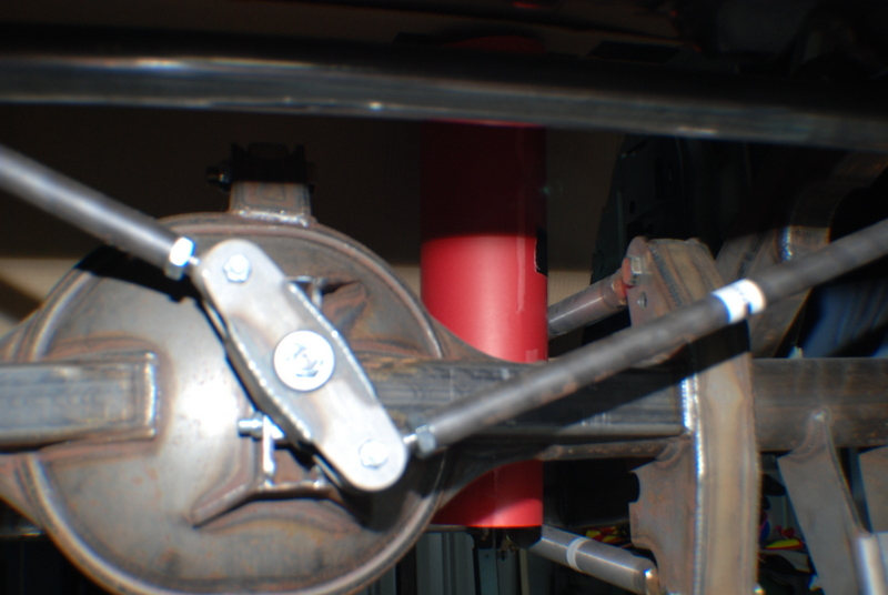

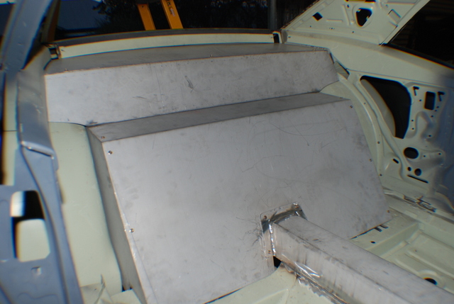

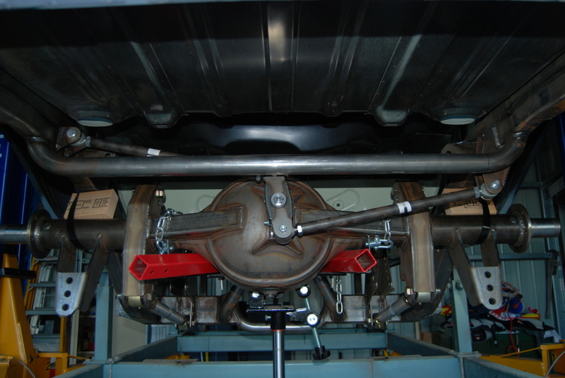

      I have done all the prep to weld in the rear clip, I have also worked out where the dry sump tank Will fit, it's the red paper cylinder in picture, the close out panel over the suspension will be pretty straight forward as well.

      Dec 2009
      1,607
      Greg - sick build for sure! Two questions:
      - Does the RHS motor require an external staged pump? Or will a GM factory oil pump move enough oil to the rear tank...
      - Where is the upper shock mount? On the cross bar?
      Thx!
      Ron in SoCal
      69 Camaro in progress
      Used to be known as flash911

      Hi Ron,
      The shock mounts are on the frame rails near the Watts link mounts.
      For the oiling in the RHS motor we are using a Katech pump that Is high scavenge and high pressure.

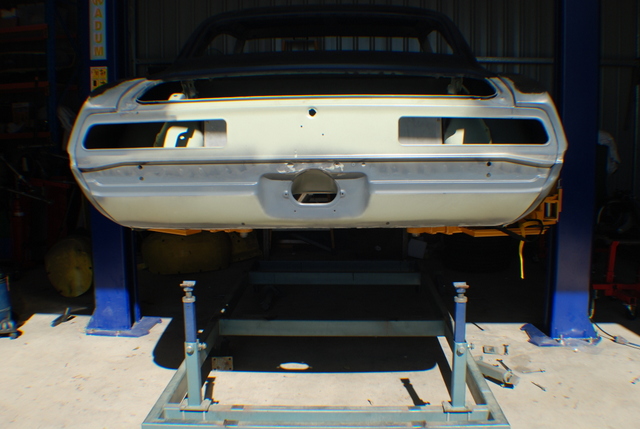

      So I got it back today for the next step, I will start on the cage.
      It been a few years since it's been of the frame

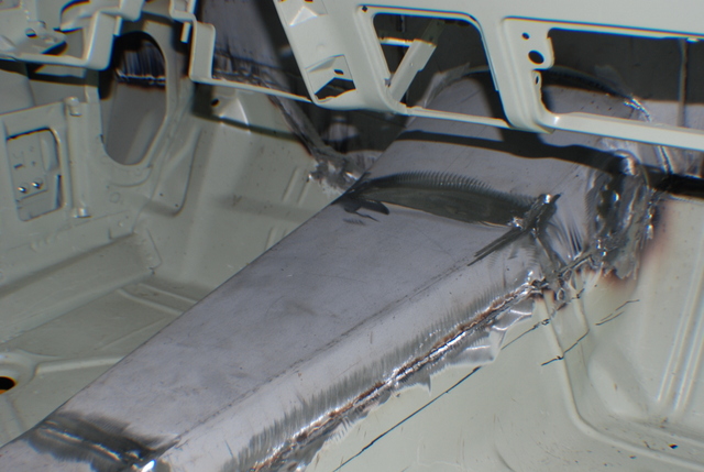

      The firewall and tunnel all finished, I just have to tidy up the welds
