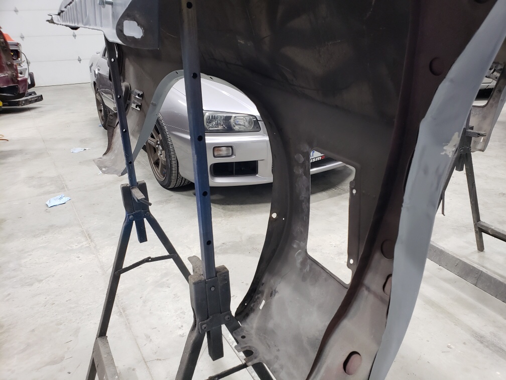

      - more blocking and panel alignment

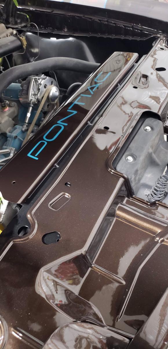

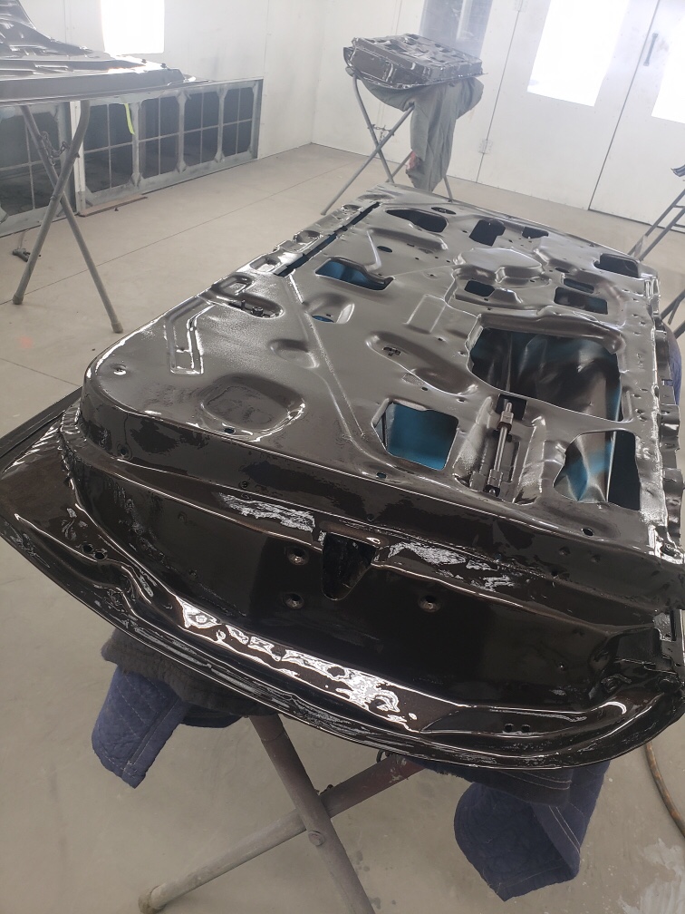

      - working on colours (we finally chose a Lambo/Audi colour - Javabrown). Drag-U-Down got busy painting the car:

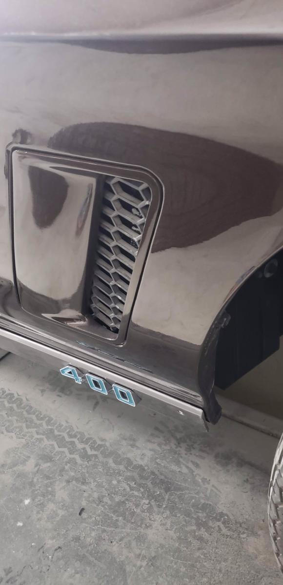

      - some more pics...

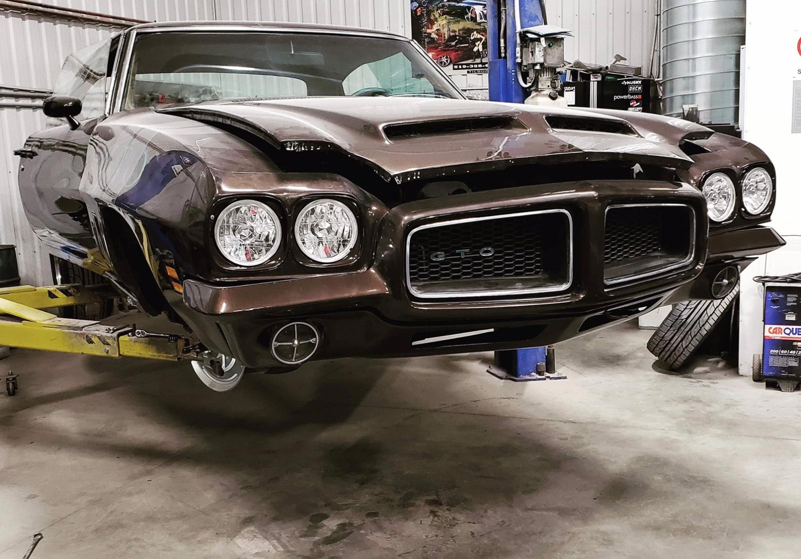

      '72 GTO - Project 'Just-A-Driver'...
      We are edging closer to complete. The front valance is on, and the interior and wiring being finished. Also some custom touches to try and bring the interior up to date - carbon fibre/3point front & rear seat belts...
      We went to BMR front/rear coils - the GW springs have been on the car for a couple years and were not dropping - albeit I have them as backup 8^)

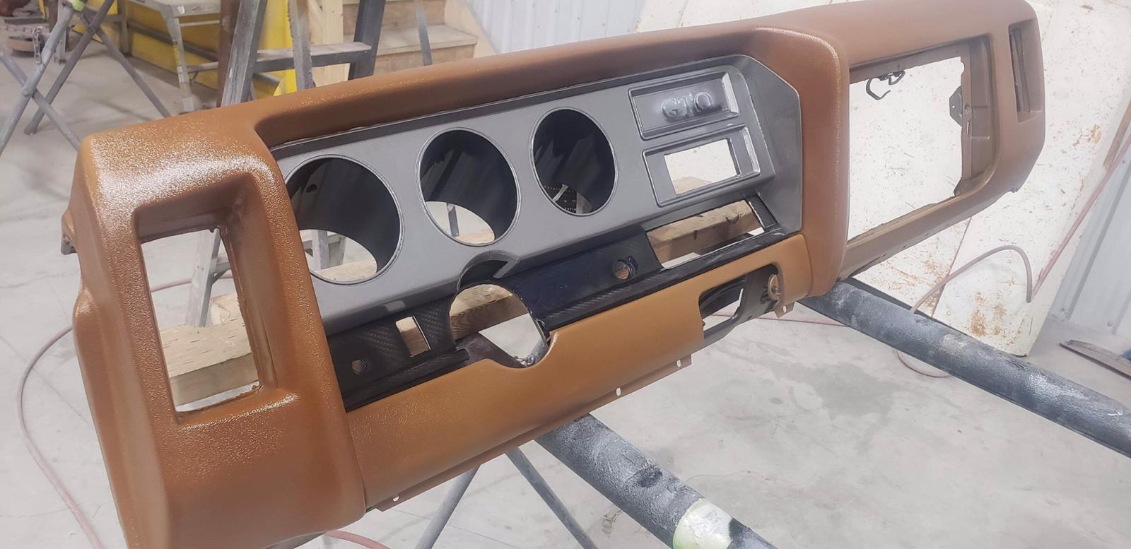

      More recent pic - almost done. We revised the frame (extra bracing and a UMI front a-body brace) and bit the bullet on lowering front/rear coils (car had been sitting on the Global West springs for 4yrs and were not relaxing). We will try these and if the car ends up too low, I can always swap the GWs back in.
      Some shots of the dash pieces - some carbon fibre included (Dakota gauges). Name:  IMG_1401.JPG
Size:  240.3 KBName:  IMG_1398.jpg
Size:  142.6 KBName:  IMG_1360.jpg
