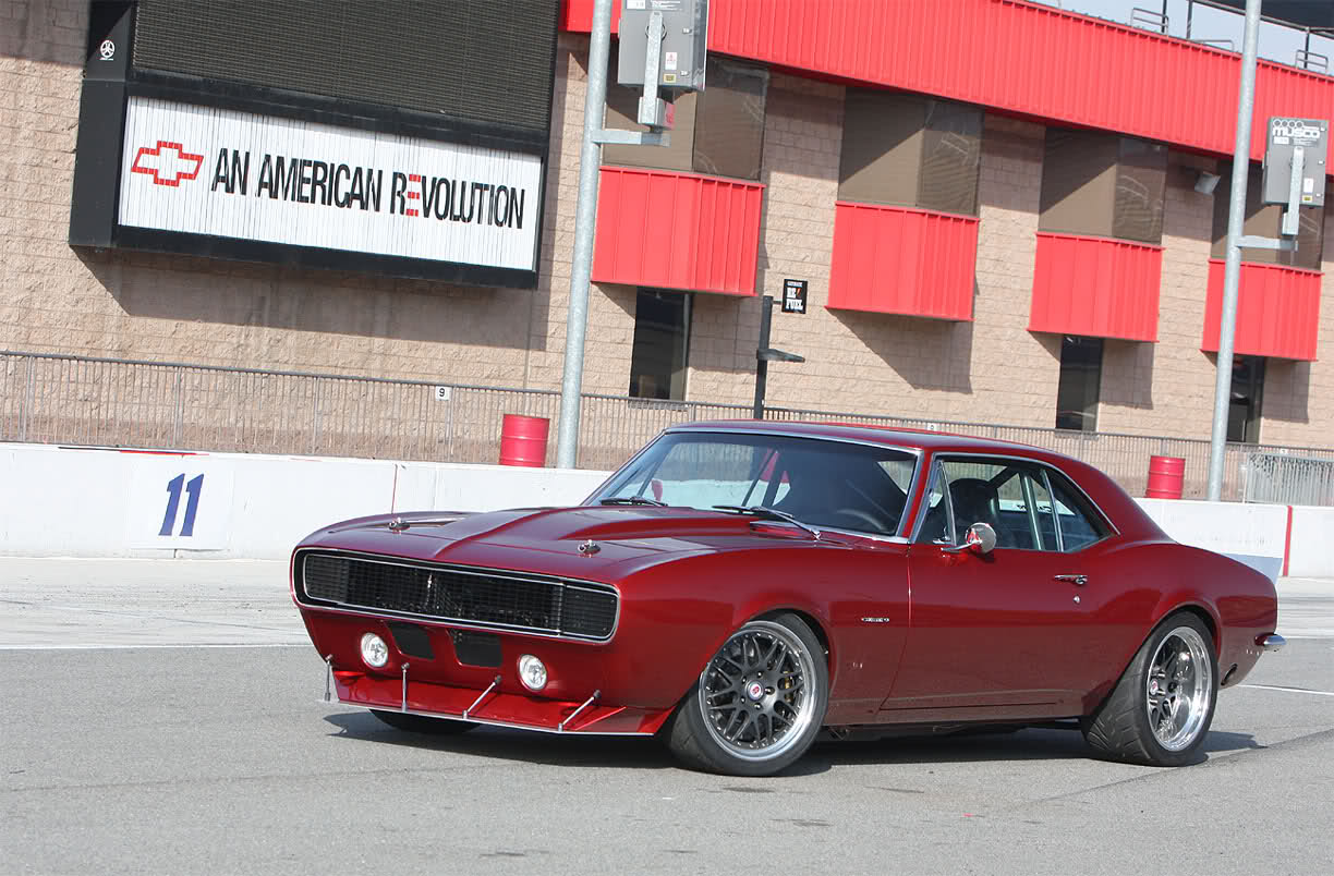

      We shot the car today for Camaro Performers at California Speedway.
      Here's a shot not good enough for the magazine as a teaser.
      Beautiful Car!
      1968 Track Rat Camaro:

      It was a really fun experience at California Speedway yesterday with Steve. I think that we made his job a little bit tougher since part of our job was to direct the light where he needed it - unfortunately, it's been six months since we last saw real sun and we were slightly confused by it...

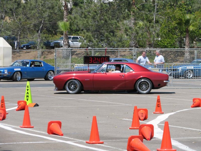

      Well the weekend was awesome...
      I was really honored to be awarded the Muscle Machine of the Year finalist award for the event.
      The autocross was increadible (photo by Steve Rupp)
      and I was happy enough with my 31.7 pass... although I know I can get more out of it.
      It's now in the capable hands of D!ck and the crew at Best of Show to try to sort out some of the problems that cropped up over the weekend. I`m back on the road and dreading another drive through Montana.

      Like Steve suggests, we were able to get the car together the Thursday before Del Mar and had the Camaro in the optima batteries display (when it wasn't on the Autocross course)
      I had the chance to get a lot of time on the Autocross course on Friday and Saturday...

      On Friday we found that the front end was too tight to the wheel - the ride height settled a bit over time (or so it would appear) - and the front tire got cut up by a fender bolt. Nothing disasterous and we were able to raise the ride height.
      On Saturday we found that one of the valve stems worked loose over two days of abuse (it was new following the rehoop earlier that week). Luckily the tire went flat at the end of my last run... close call but again nothing disasterous.
