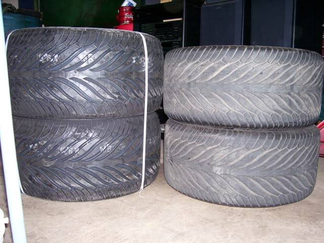

      Quote Originally Posted by andrewb70
      I'd go with a 285/40-17 in the rear and 245/45-17 in the front. The 285s are just slightly taller which I think will look better.
      285's on the left. I had 275's on the back of my car for a fews yrs and a taller tire would fill the wheel well nicer. I didn't realize how much bigger the 285's were over 275's but I hope they fit.
      So. Cal.
      1,240
      Quote Originally Posted by DAK View Post
      Wow!!! Thats really odd. Are those 275s on the right. There should only be a total of LESS than one inch (more like .800") for the whole stack. Im I losing my mind, yeah, yeah, I did find it again, but I swear its on the way out again. Tell me they are not 275s on the right? JR

      Quote Originally Posted by JRouche View Post
      could also be 8" rim vs 10" rim
