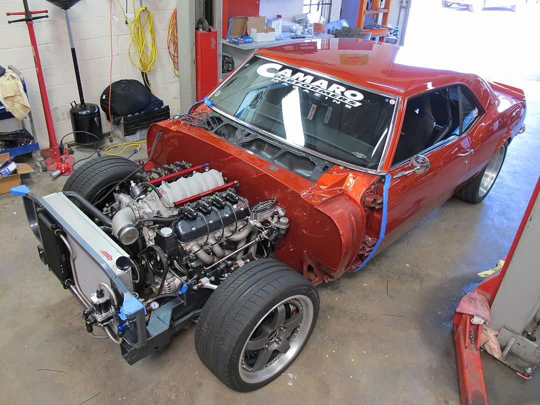

      Today was a good day.. the fans are hooked up and working (thanks Chris) and there are ZERO leaks from the engine, trans or any of the new brake lines.
      Car starts, and somewhat idles but the current tune is FUBAR'd and needs some lovin'
      Good oil pressure, I have mech gauges on the front oil system. It's 50psi at cold idle going in and 48psi coming out. I imagine the drop is minor resistance in the Canton oil t-stat. System holds about 8 quarts now.
      Here are some shots.. did a lot of things I had wanted to do like clean up wiring.. heat shield other wires and install some XRP insulation on the fuel line were it goes over the header. The whole underside was recoated with Wurth SKS Stoneguard and most stuff was re-powder coated. I didn't bother re-coating the exhaust system since it just ends up getting messed up.
      Dyno tune is set for Thursday afternoon at Westech Performance. I cleaned my front wheels and found that they are both missing their wheel weights, for how long I don't know but they both have small flat spots. I will most likely be moving to a 285 front tire anyways.
      Now to pull the front seats to install my new RaceQuip harness' and possibly plumb in my halon fire system.
      Bottom side (can't really call it the "dirty side" just yet)
      Top side..
      1968 Track Rat Camaro:
