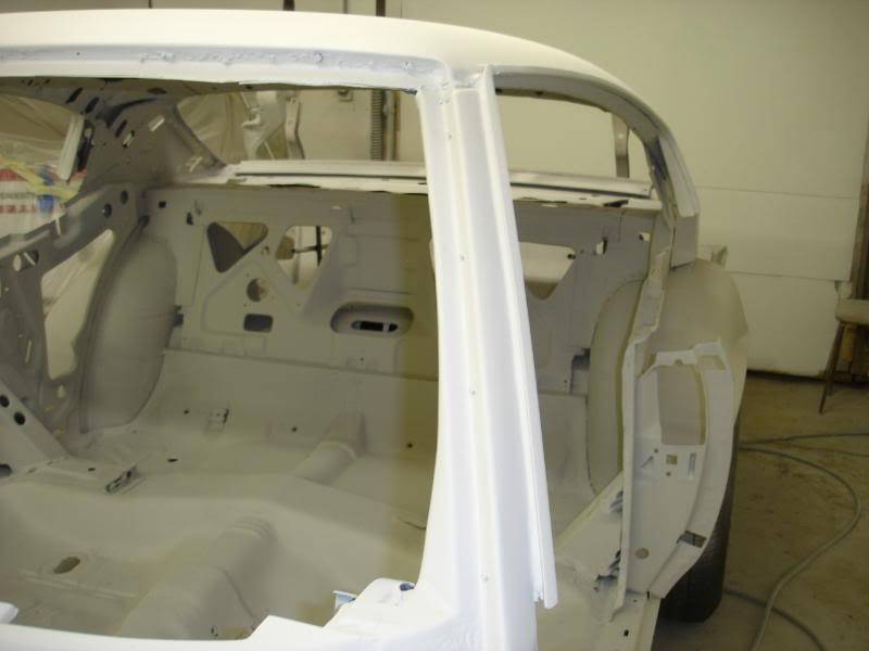

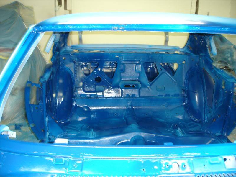

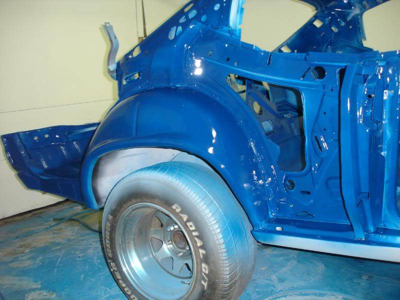

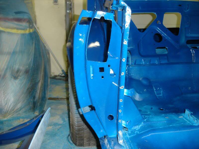

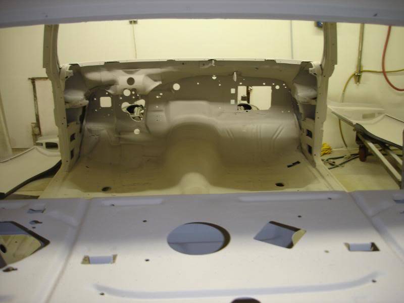

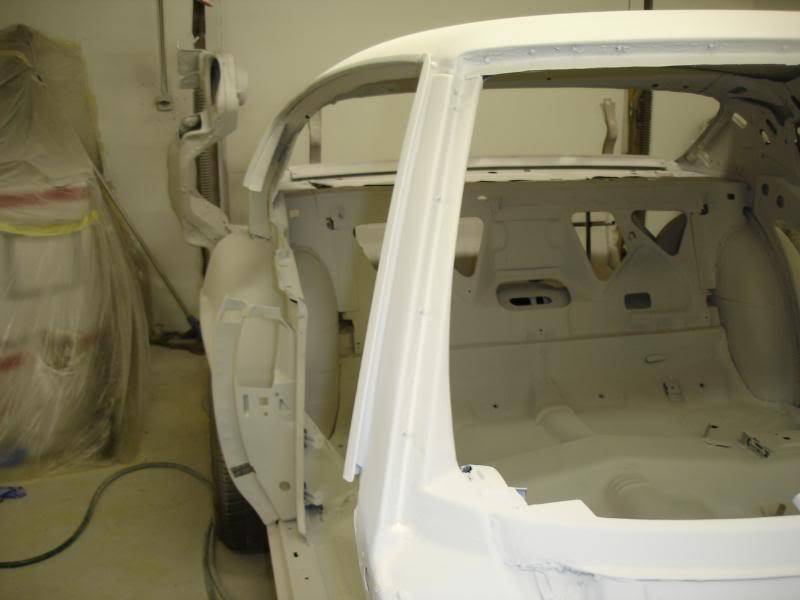

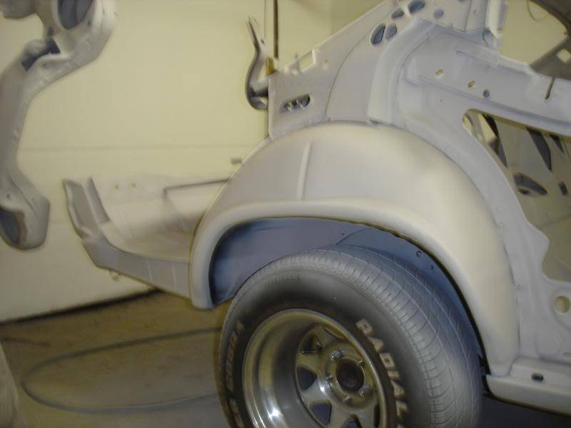

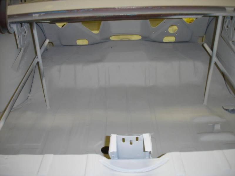

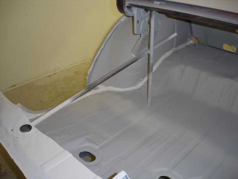

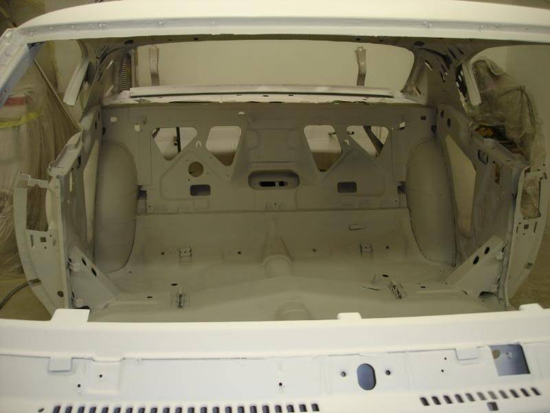

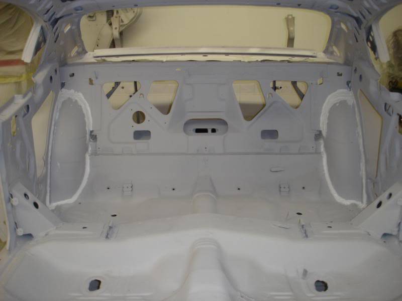

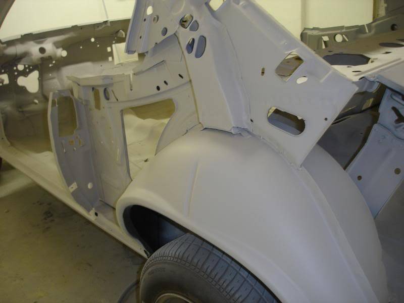

      here are few more pictures of my chevelle after priming

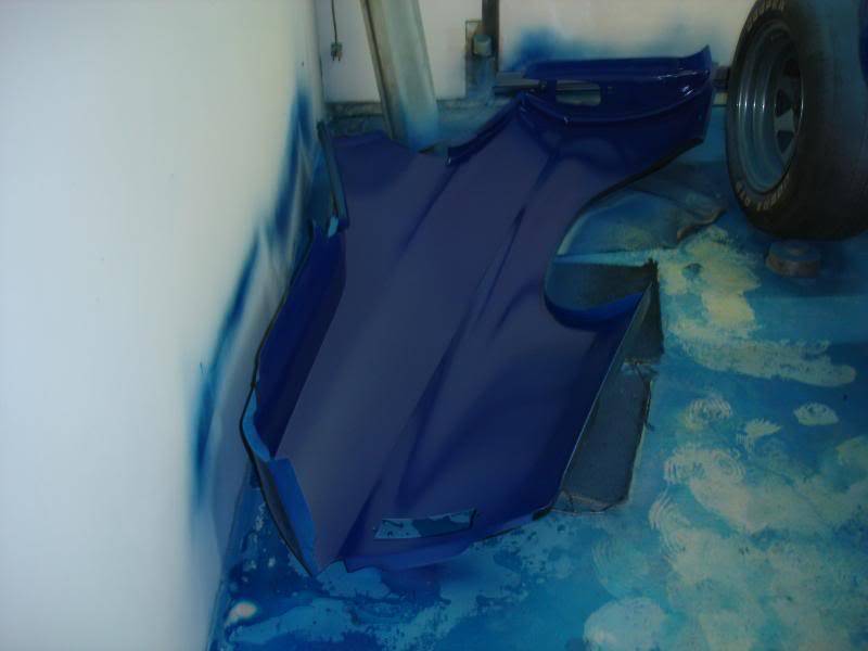

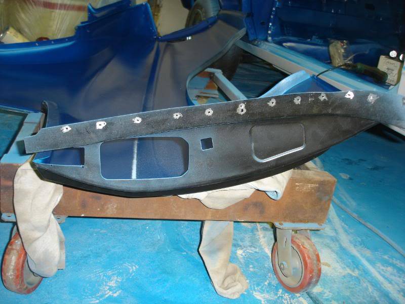

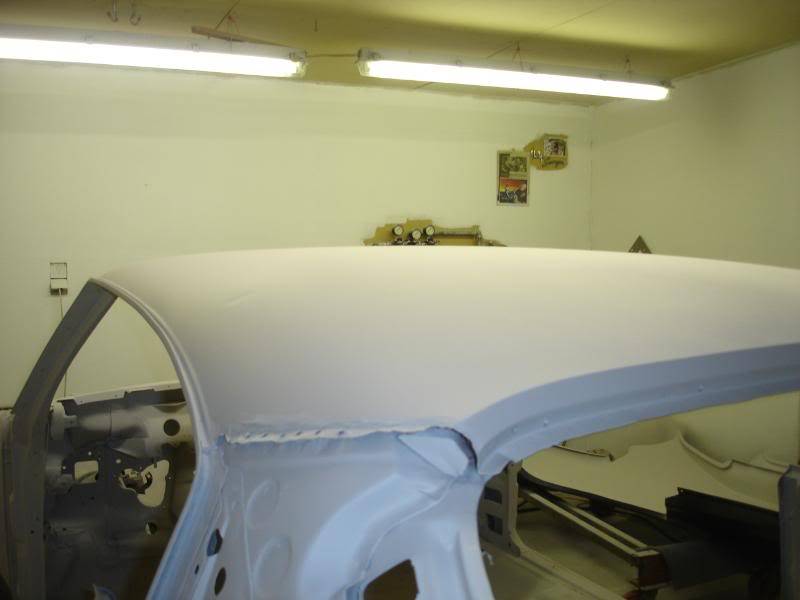

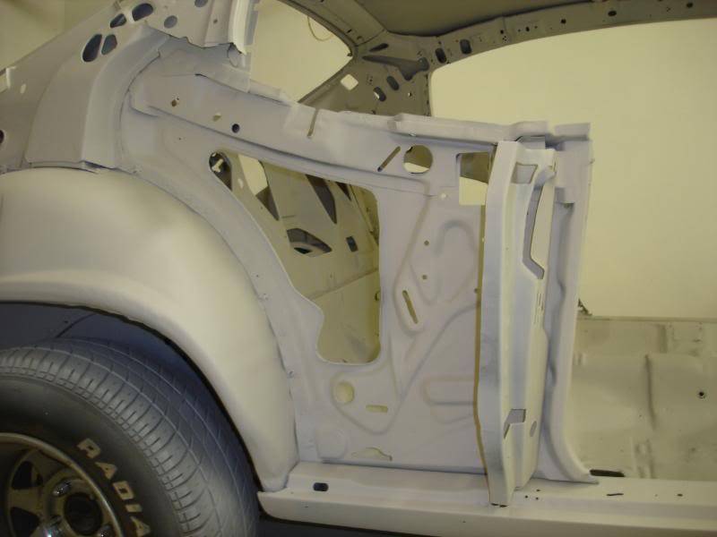

      What has been done
      Seams have been close with adhered
      2 cartridges did take long time to finish
      And ready for pant after XX hours

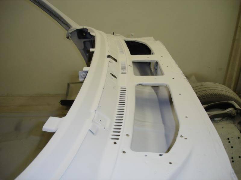

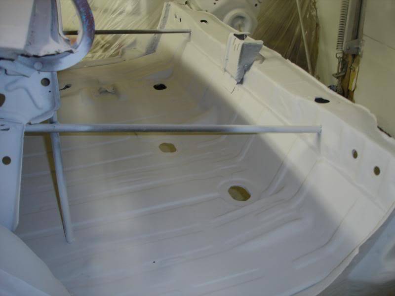

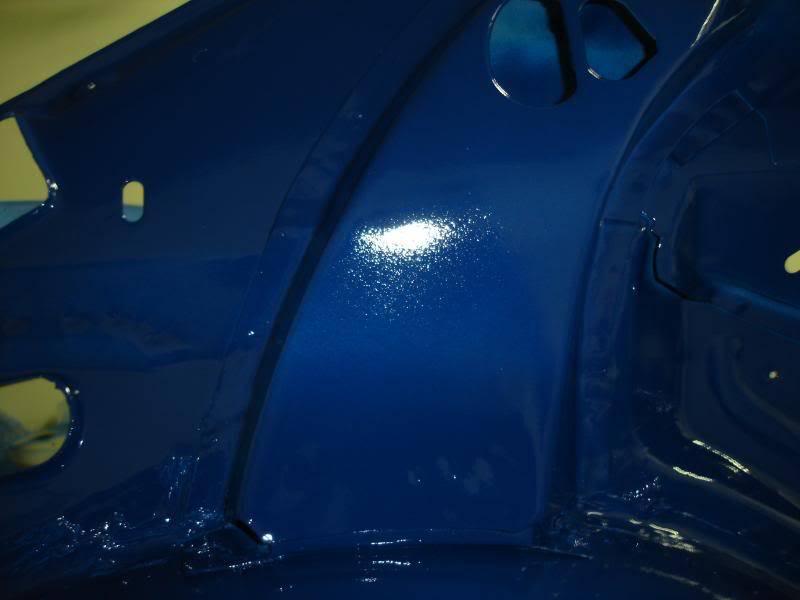

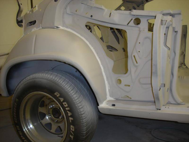

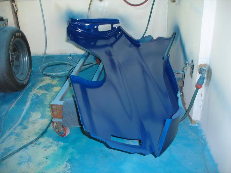

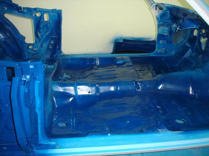

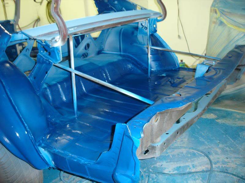

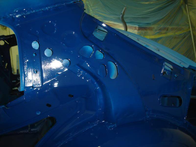

      I have finished painting thus part that don’t need Body Filler and sanding or will not be exposed.
      And I painted the floor and inside top lightly to close it for now.

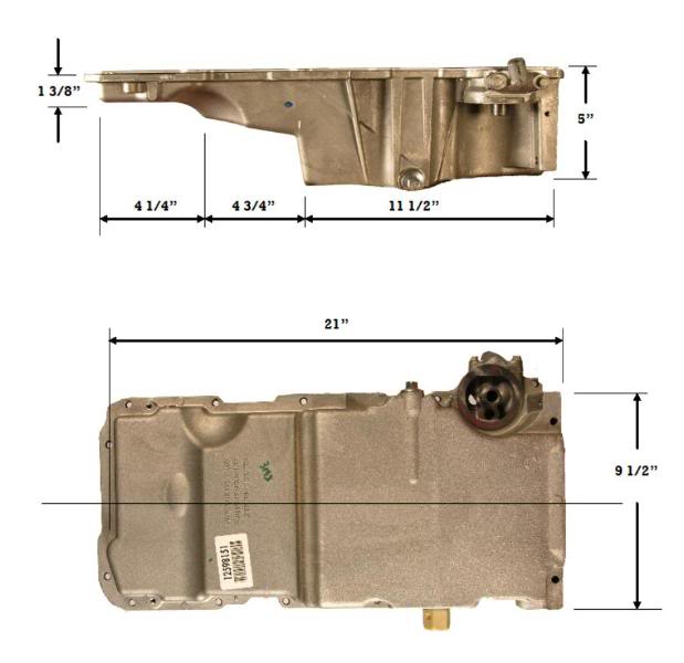

      Why did the ls motor not fit?
      the oil pan from 4gen to big
      2000 camaro
      ls1 pan for chevelle

      Do not use that LH8 pan it hang to low. So I have been told. Go with a autokraft.

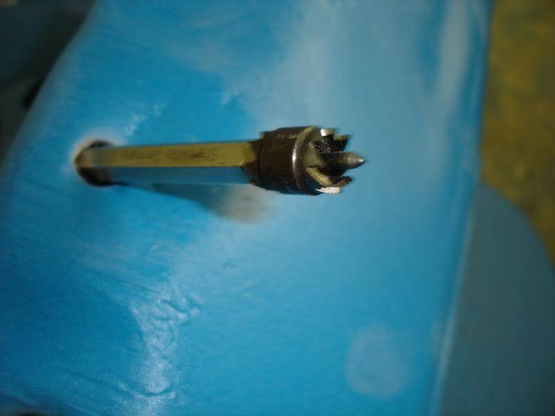

      why are you painting it all apart like that? wont it be a problem when you weld it back together?

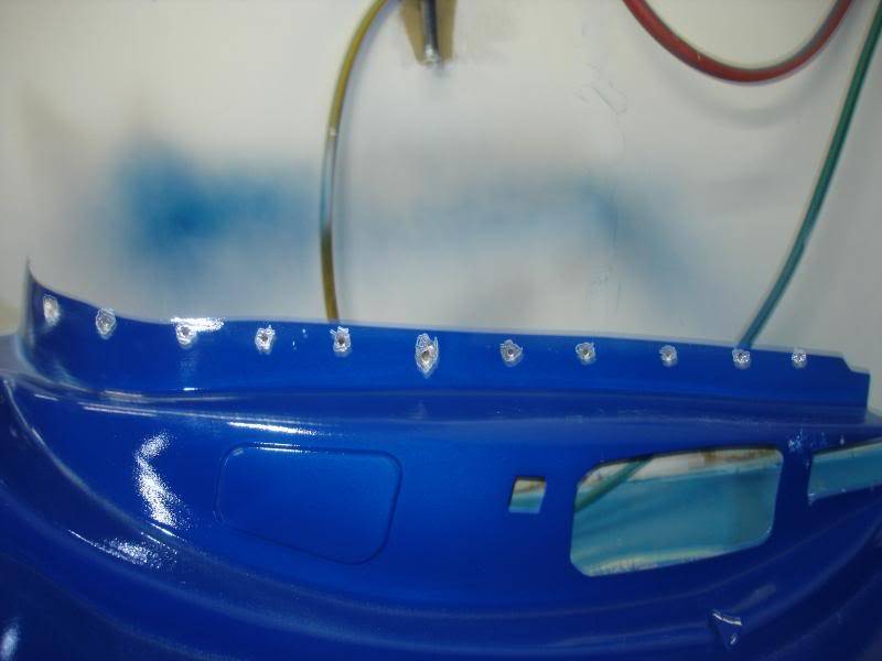

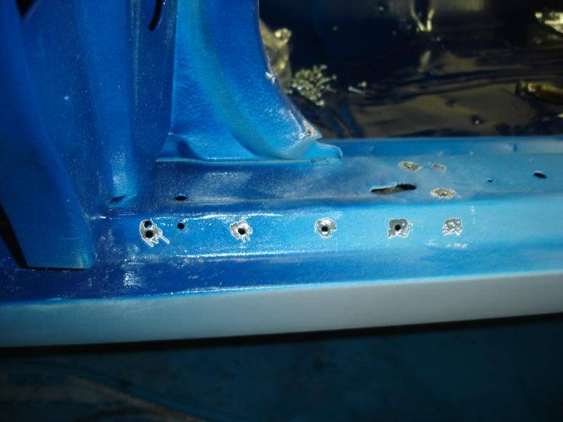

      Quote Originally Posted by Code Red View Post
      all welding points are clean metal
      drill with 8mm
      holes after the screw are 2.5mm after the welding re primed and paint again
      I have not decided on pan yet I posted the LH8 pan because it show size different on the camaro pan and pan that fits the Chevelle
