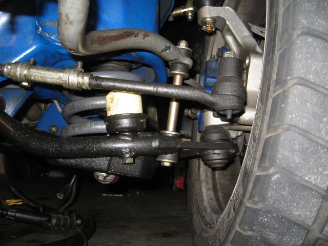

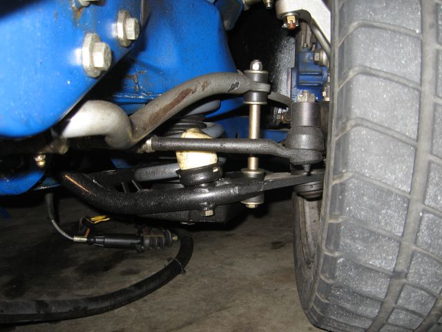

      Take a look at these pics. The truck is jacked up on the passenger side so this more represents a "compressed" shot versus a ride-height shot.
      Anyway, you can sort of tell that the angle of the LCA is kind of "northwest" while the angle of the sway bar is facing kind of "southwest."
      Don't you think that they both should be on the same plane??
      Also, notice how the end of the sway bar is a bit too far "back" compared to the LCA.
      Would you see any benefit to shortening the end of the sway bar AND twisting the end of it so it is on the same plane as the LCA?
      I would think that I could do this at ride height and that way 'above' and 'below' that point would have some bind but not like there is now.
      Any thoughts?
      Adam

      Jeremy (s10cyncrvr) had the same problem with the sway bar mounting holes not lining up. He cut the end off the sway bar, turned it and re welded it. Then he used a heim on it. Not sure if he modded the LCA at all.
      You could always use these;
      http://www.ridetech.com/catalog/Posi_Links-2484-1.html
      All the bind is coming from the LCA side. I has too much of an angle for the bushings.

      Okay, so let's say I got a sway bar and I cut off the end and then welded it back so it had both the right "angle" and the right "placement" over the LCA.
      Would I use that posi-link above on the LCA side or on the bar side? Would I want one on top AND bottom or just one?

      What I'm seeing in those photos is not bad enough to bother with in my opinion.

      Really? Not even a more "simple" solution like cutting down the length of the link to make it less obvious? Or even modding another bar?
      Plus cutting up another bar isn't that big of a deal to me because I'm "upgrading" to a thicker bar soon either way - so I'd have the chance to do this without any down-time. And let's pretend that 'time is NOT money' in this case too! :D
      The reason I feel like it's a big deal is because one of the poly bushings was completely destroyed and I feel like it is due to the angles - I didn't take a picture of it because I wanted to show the "actual" angles not what it looks like now without the bushing.

      Looking at the picks the problem seems to be on the LCA side. You could probably just use one there.
      Jeremy cut and welded his sway bar but I wouldn't. Unless you really trust someone to do the bar for you I say no. In no way am I saying he's wrong or I wouldn't trust his work but rather the average guy couldn't and shouldn't cut and weld on any spring.
