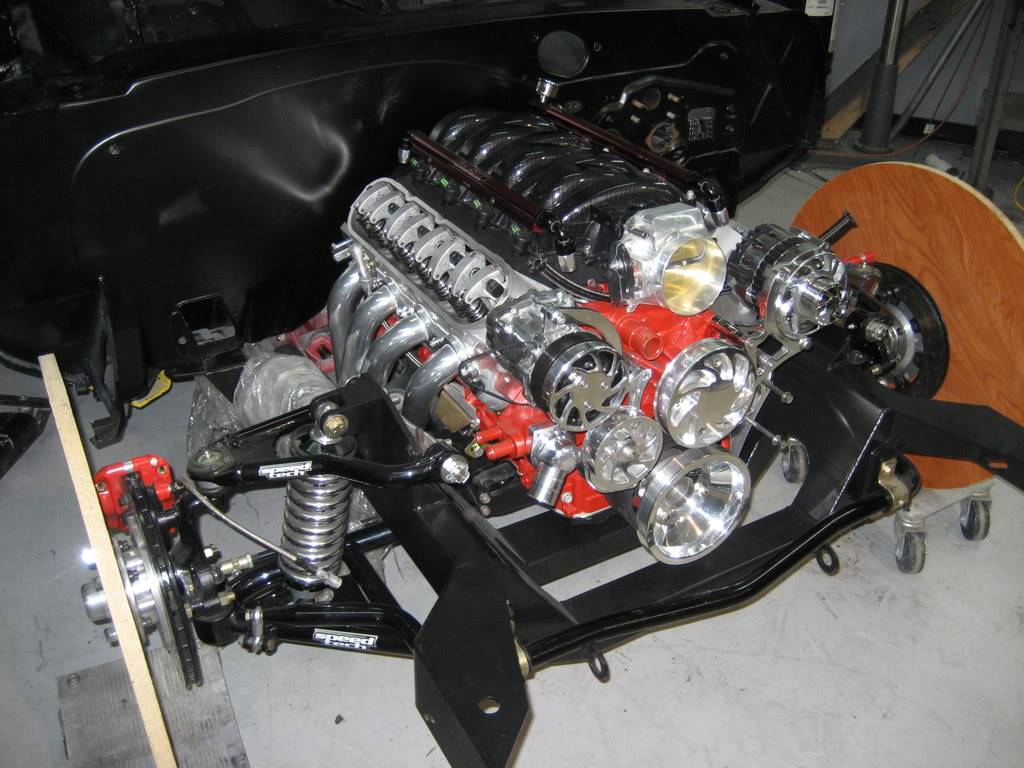

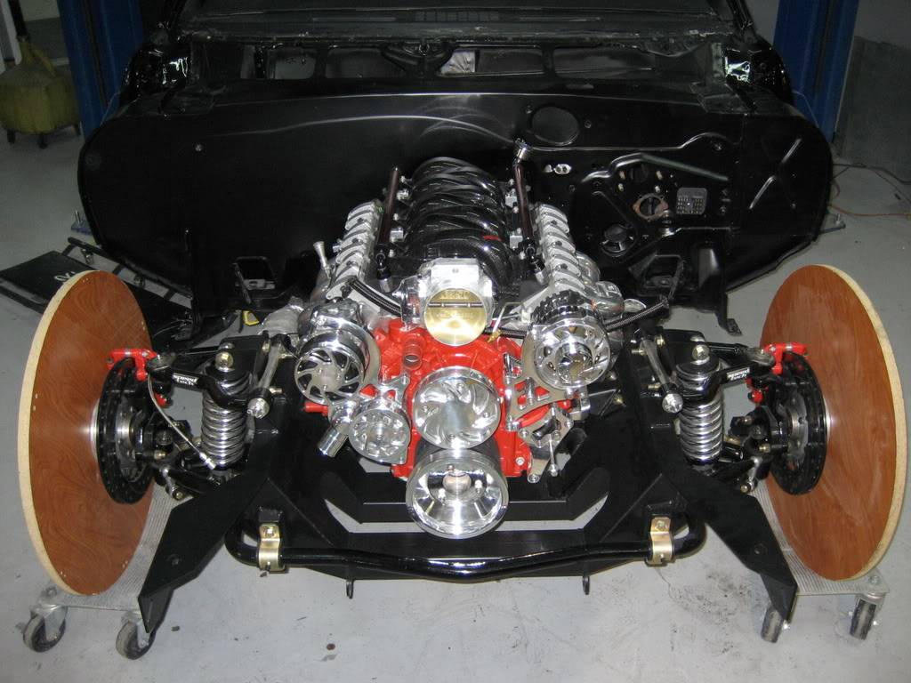

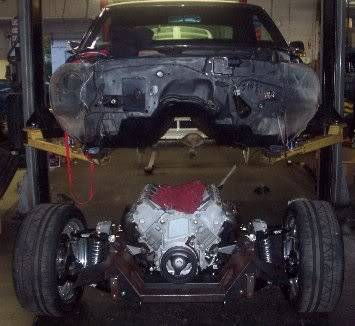

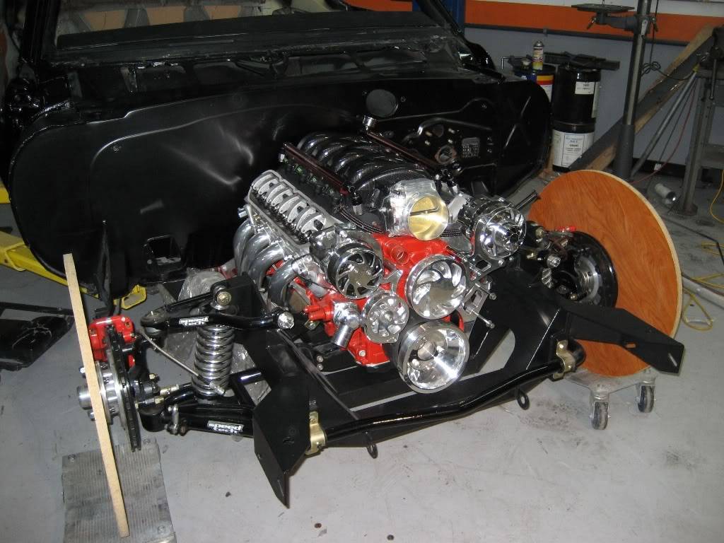

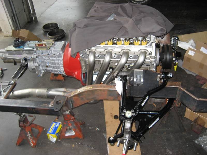

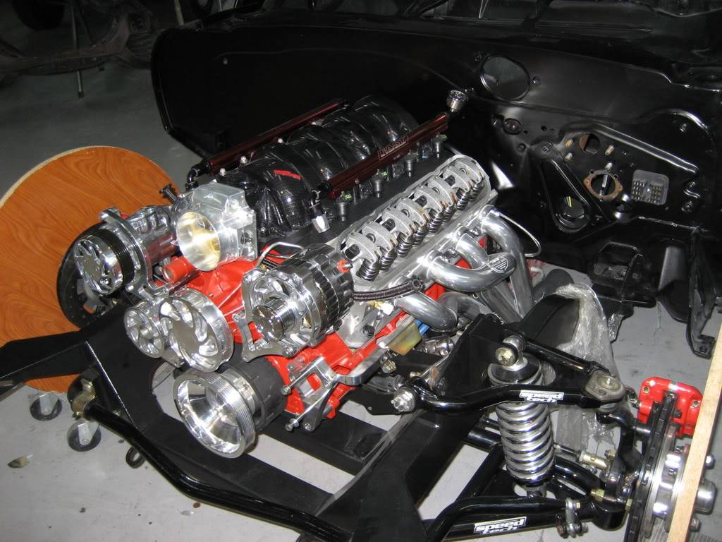

      Here is the Project before tear down
      Out with the Old small block and front subframe
      Mocking up the New Speedtech Subframe and LS-2 Motor
      Speedtech Subframe and LS-2 Motor with Keisler Transmission

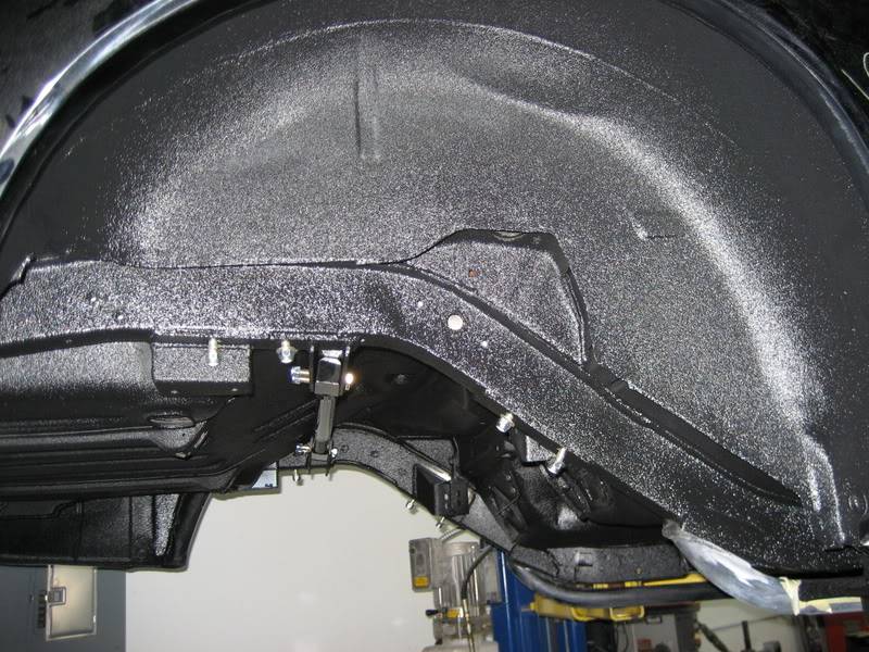

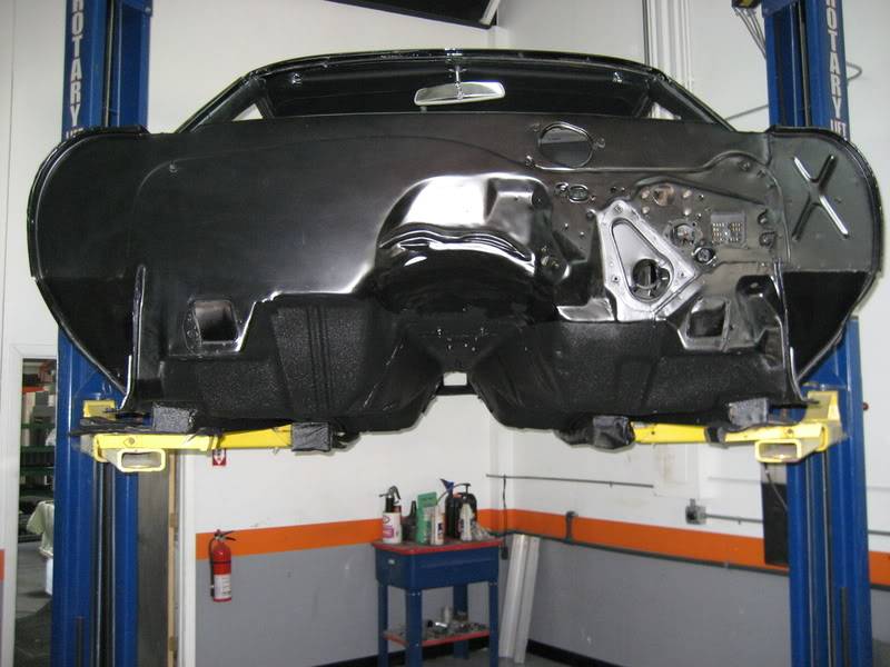

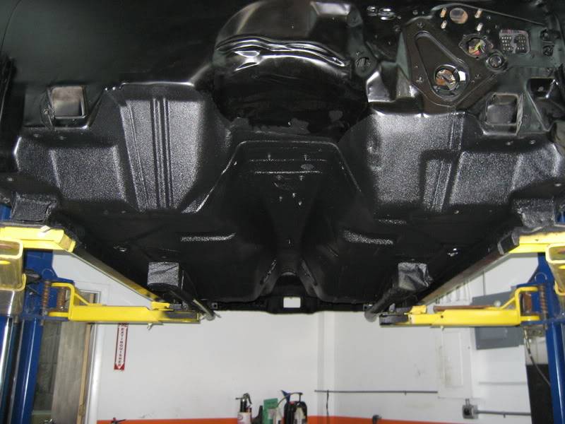

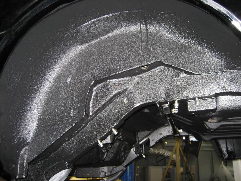

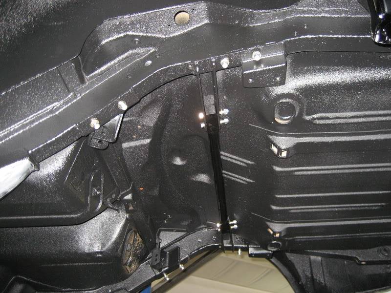

      Here are Current Pictures of the Undercarriage
      Undercarriage Tunnel

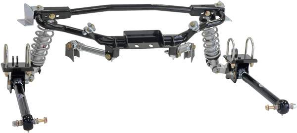

      Rear Undercarriage with Chris Alston's New G-Bar
      here is a pic of the Kit for the Chris Alston g-Bar/g-Link Rear Suspension
      iceland
      1,859
      Country Flag: Iceland
      Cypress, TX
      330
      The undercarriage looks great. Is that the U-Pol Raptor Liner?
