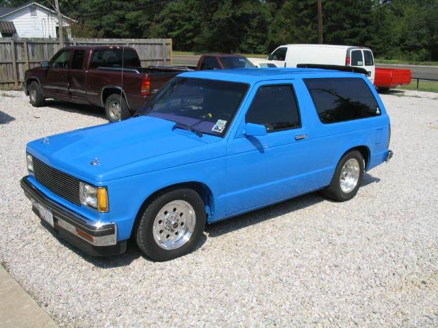

      That blue blazer is gorgeous! Congrats to the owner.
