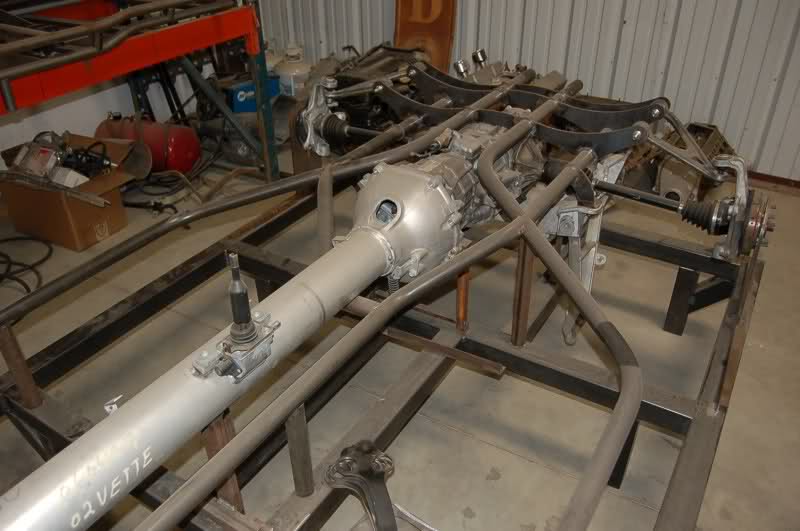

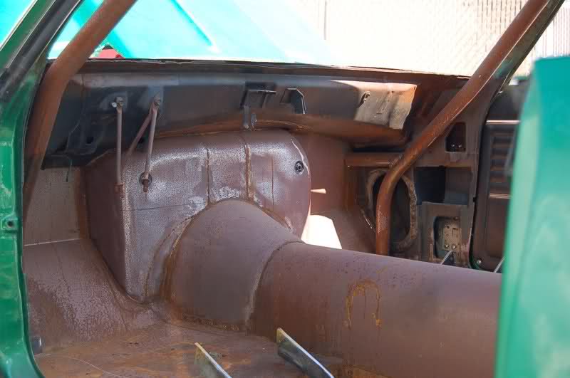

      Rear transaxle cover, rear main roll cage hoop and floor:

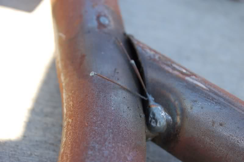

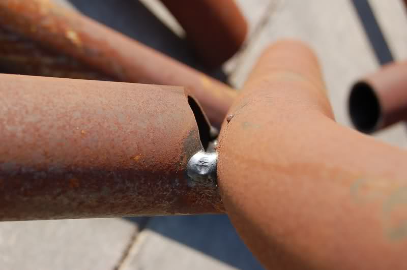

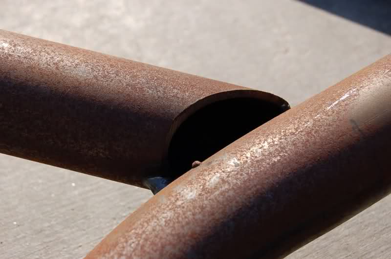

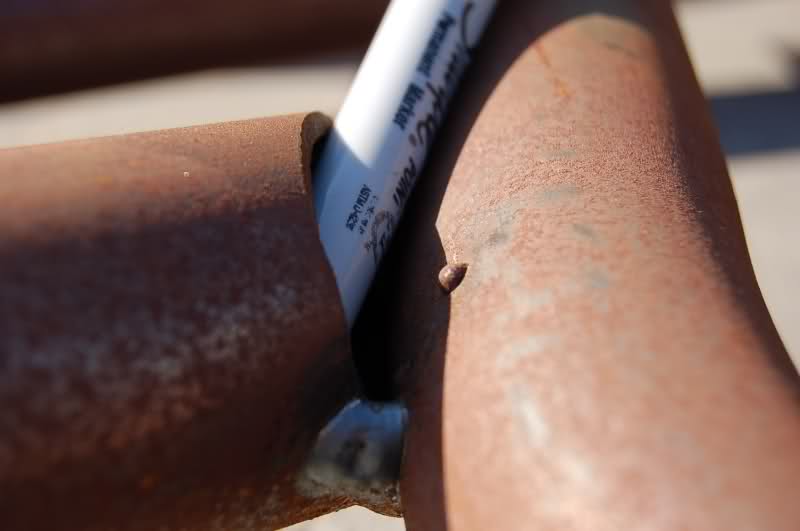

      The roll cage. It was built to standards not completely approved by any racing sanctioning body. One of the reasons for not passing tech would be this little gem:
      Yes. That is indeed an entire Sharpie marker stuffed into the non-notched-grand-canyon-sized gap of the tube joint. That is just one of many slight blunders of fabrication that went into my $14K chassis and roll cage.
      Other fun facts include:
      Inner frame too narrow to fit an actual exhaust system.
      Front down bars hit both front tires when turning.
      Frame rails made of 2x4 and 3x3 .120 wall metal (tank chassis)
      Front A pillar down tubes leave under 10 inches of room for 3 pedals
      Large gaps in joints of roll cage
      Sheetmetal doubled up in most places for strength (tank floor)
      Chassis could be built lighter and stronger with even lower ride height.
      Here are more cool pics from the cage:
      Don't worry about the MIG wire, it will add strength over time.
      What?!? Seriously? Come the 'F' on....
      How does this get the thumbs up to be shipped to a client?

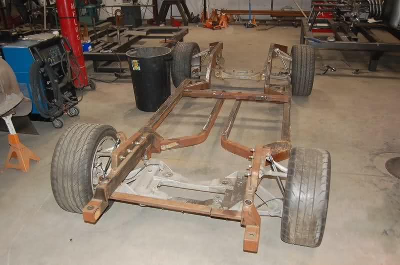

      Tank frame by Wayne. None of you can tell me that Wayne didn't build it strong enough. He used some serious wall thickness on the frame rails and added beef like it was going out of style. The car was a bit over weight for my standards, so it got put on a diet.

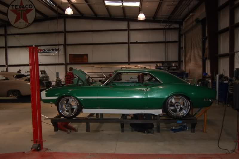

      The 50/50 Camaro before it goes onto the frame table for its new chassis:
      Here is the M1A1 Abrams C5 chassis:
      It had to be a bitch to cut that thing out in one piece. I'm surprised they were able to do so. If anyone would like it, make me an offer.

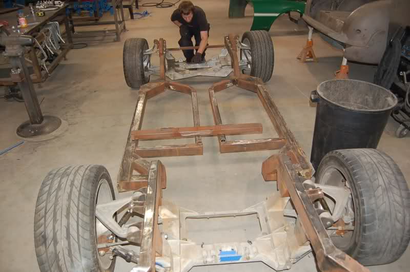

      Rodger and his crew have done a tube chassis once before and took some lessons from them to create this new tube frame. This is the rear. The front will be very similar. I think he shed 50% of the cars weight just by making a new frame for it.

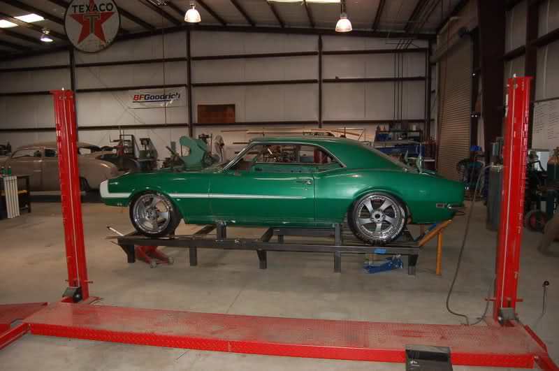

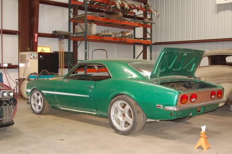

      So here is the money shot for me. I've never had a chance to put the HRE 542R wheels on the car before as I never purchased any tires. I plan to race this car so I figured get some tires that will do me right on the road courses.
      I picked up some Michelin road race slicks from a former LeMans C5R Corvette to fir the 18x12 and 18x9.5 HRE wheels. Rodger mocked them up on the frame table now that the car is on it. Rocker to ground is 6.5 inches. Roof height will be about 47.5 inches from the ground.
