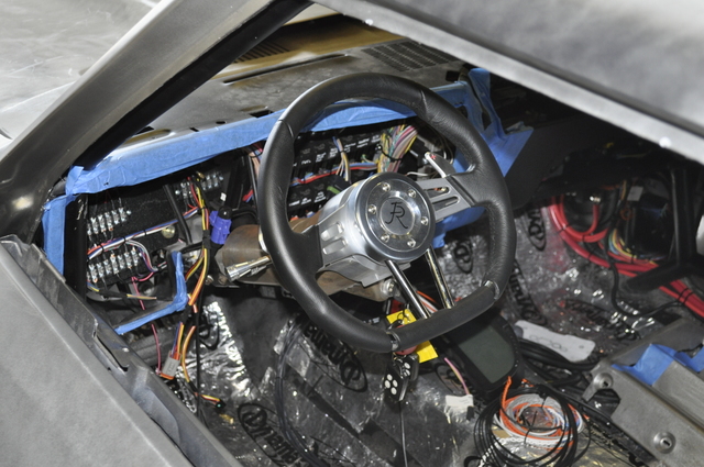

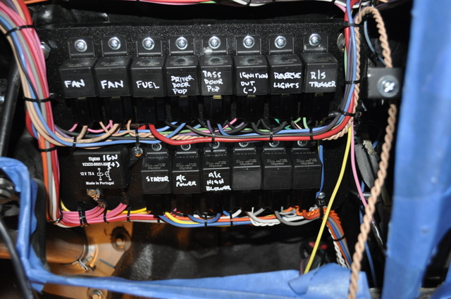

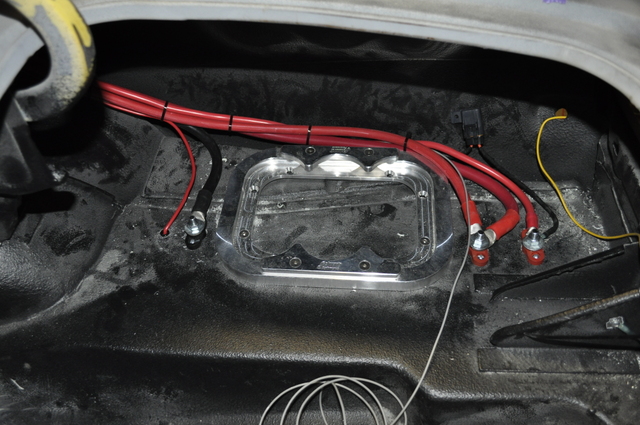

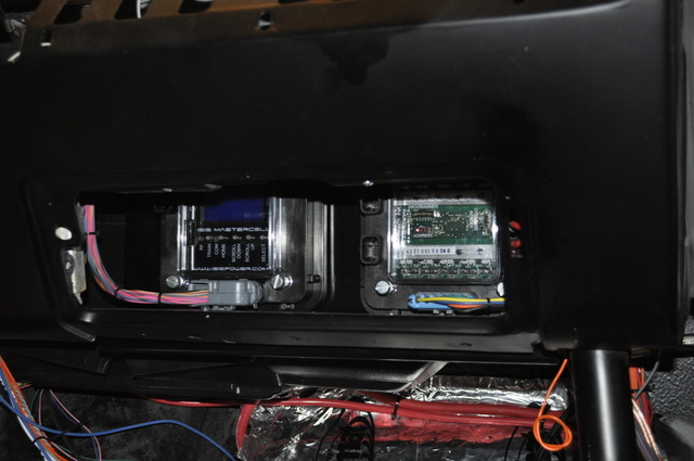

      Here are some pics of the ISIS install and wiring installed by Jason at All Wired.

      Why so many relays in the ISIS install? I thought one of the advantages to ISIS was relay elimination?

      Quote Originally Posted by banzaitoyota View Post
      Thanks John
      Anything that draws over 25A needs a relay with the ISIS system. Not all of the things we installed relays for will pull 25A but we wanted to stay on the safe side.

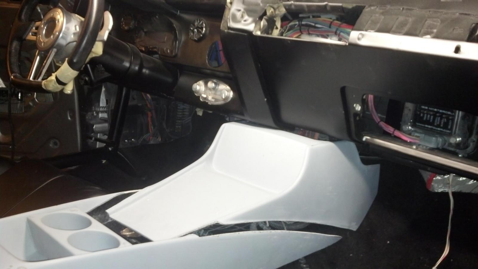

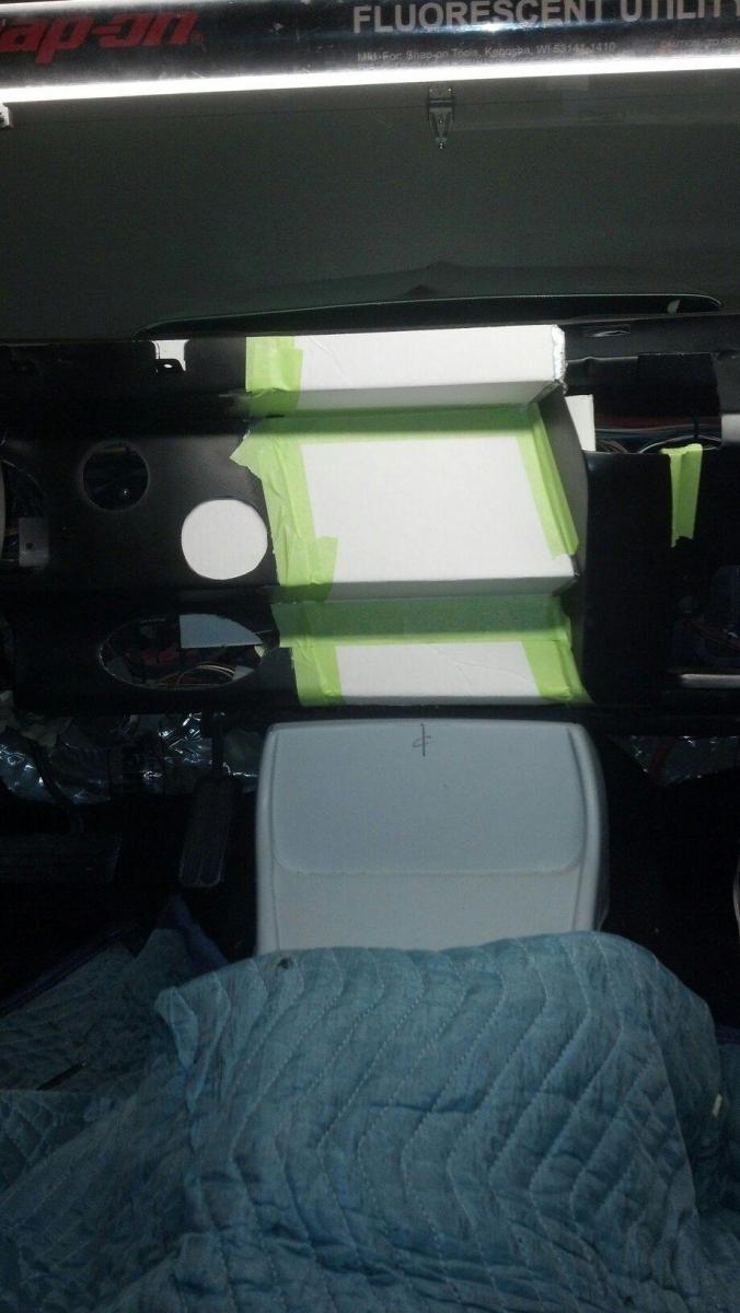

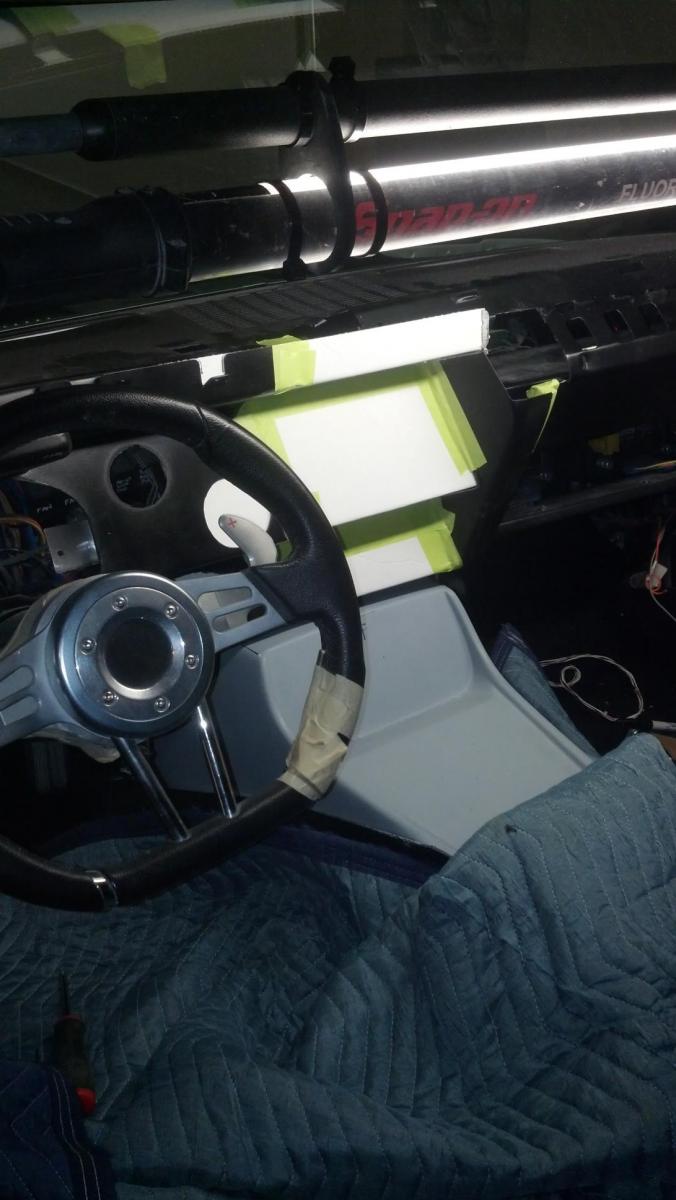

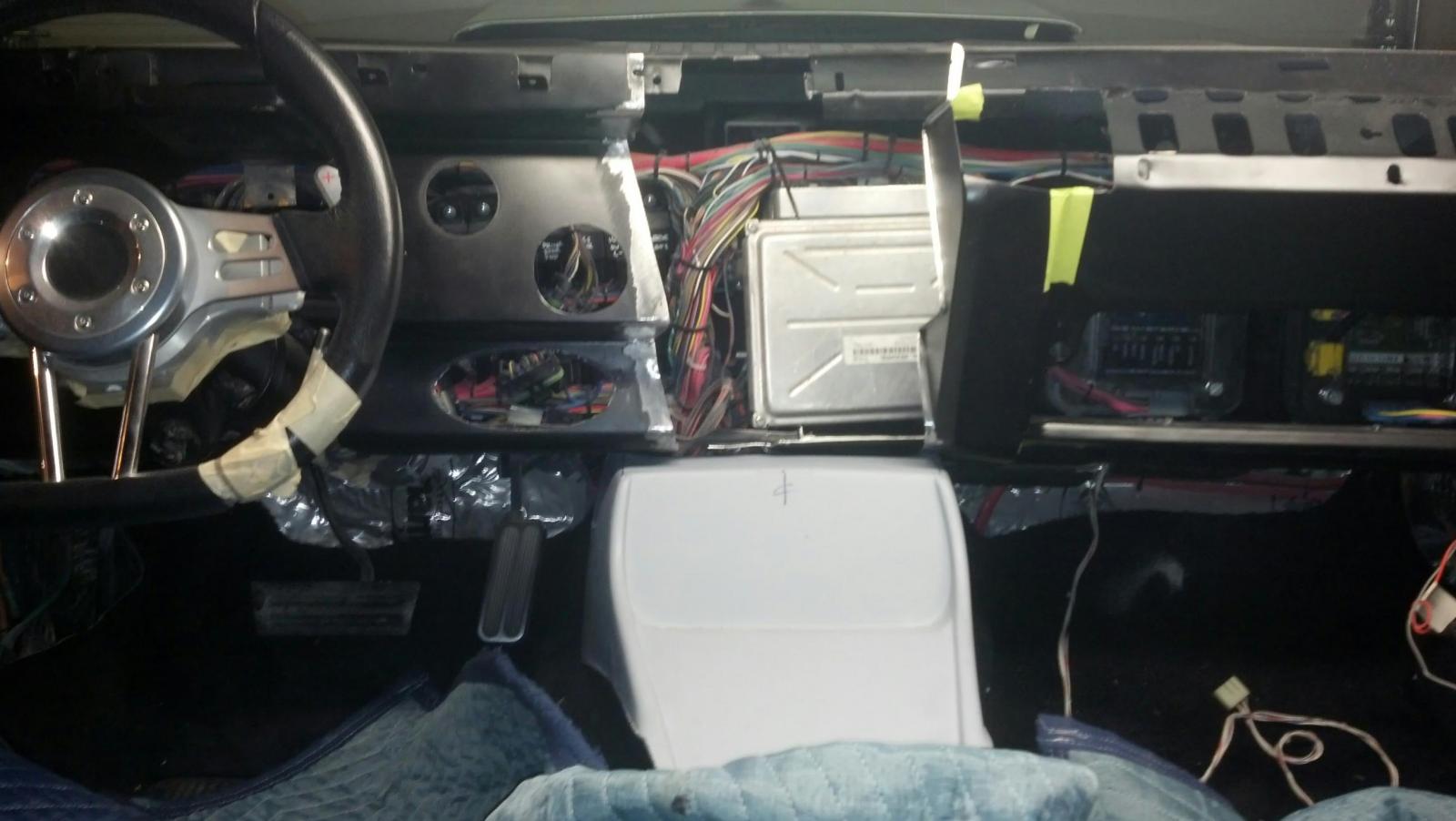

      Some interior work going on now. The DSC dash is being extended across and over to the glove box. An iPad Mini will be mounted on the upper portion of the dash between the driver and passenger. The Mini will control everything through the ISIS system including starting the car, the headlights, fog lights, windows, wipers, etc. No buttons.
      A MCI Stiletto console will be modified and extended to better match the lines of the car.
