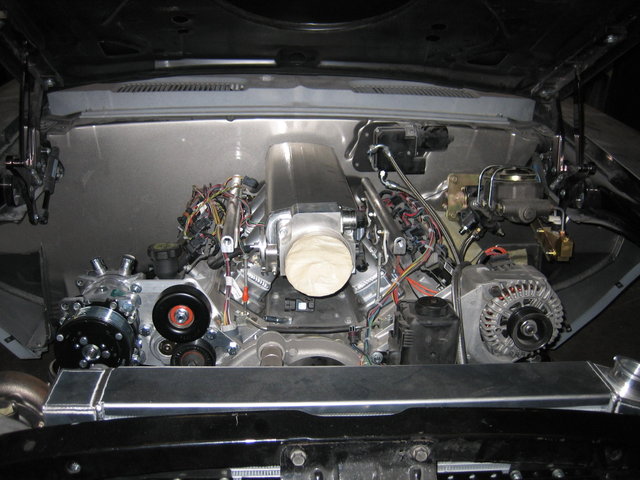

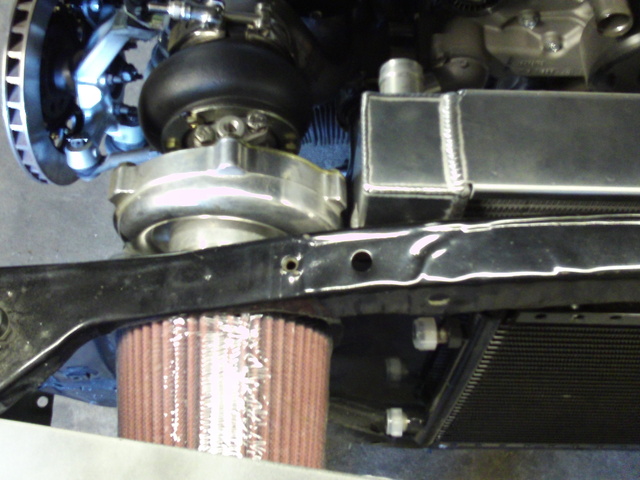

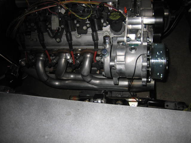

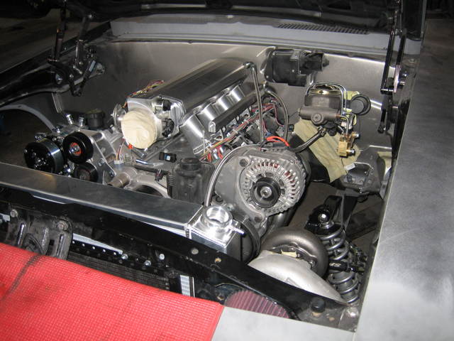

      Intake
      Here are a couple of pics of the intake bolted on...

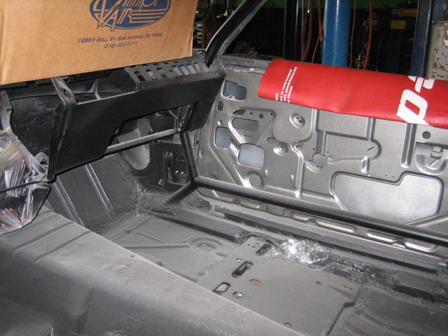

      Cage Mods

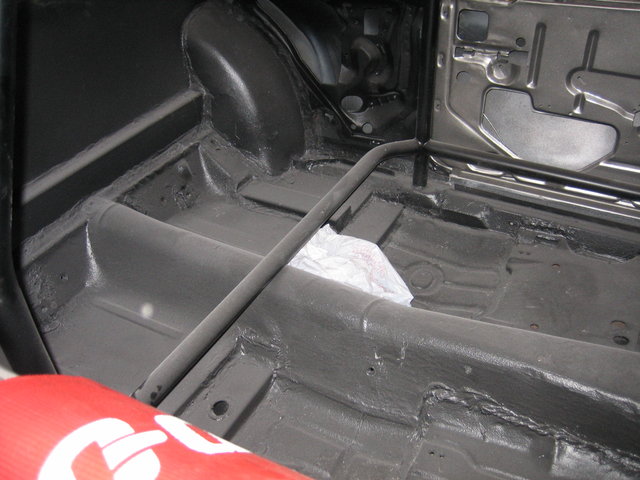

      Also had some mods done to the cage. I wanted both the front and rear of the car to have easy access.

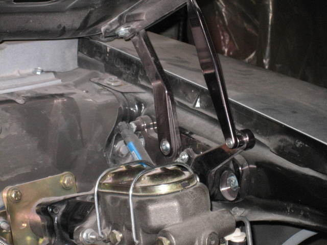

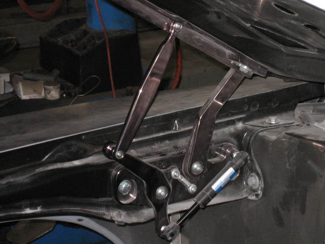

      Hood Hinges
      Here are some pics of the black chrome hood hinges.

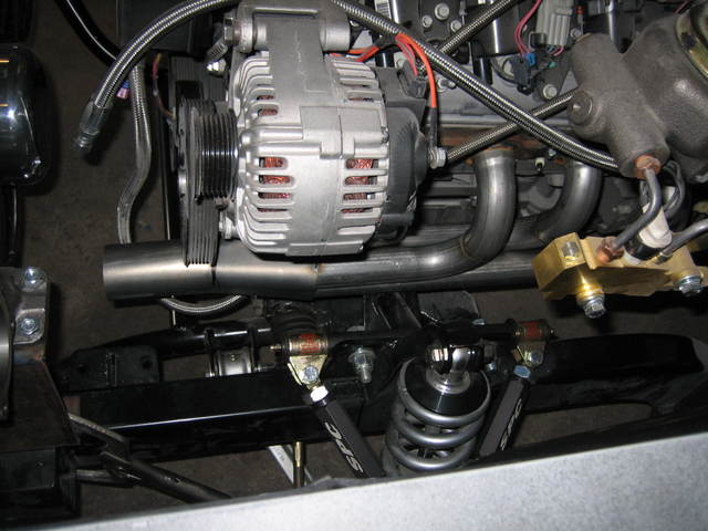

      Turbo Headers. These will be Jet Coated. I'm debating on color... Any suggestions?

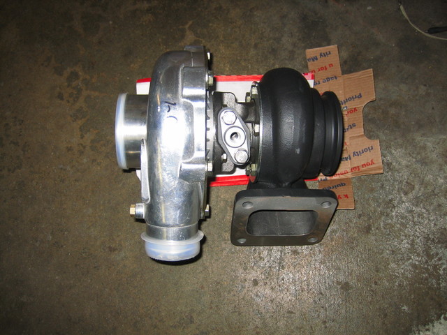

      191

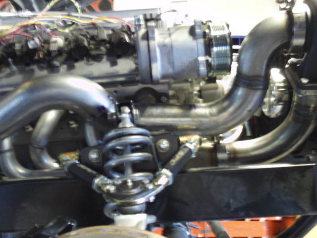

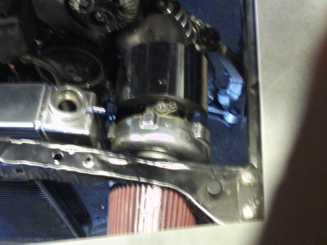

      Alright, so after some debate and my boy Perry over at J&T telling me I would have "boost at idle" due to the small turbos upfront we swapped them for Garrett 60-1 P-Trims. Compressors (.70 A/R) are polished and the turbines (.58 A/R) are ceramic coated black.

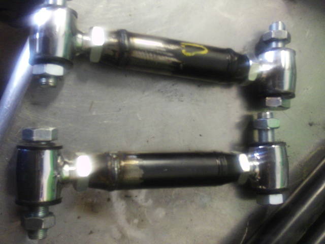

      191

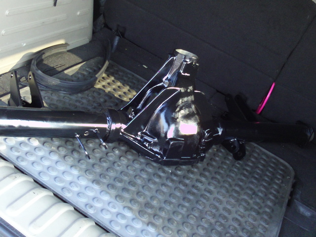

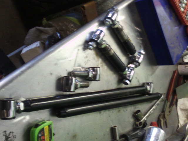

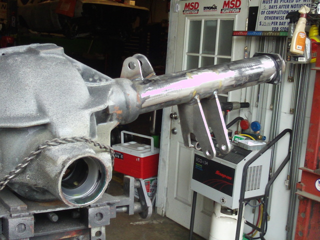

      He finished up the Triangulated 4 Link and sent everything out to be powder coated.

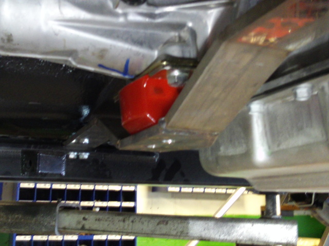

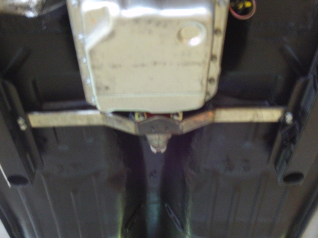

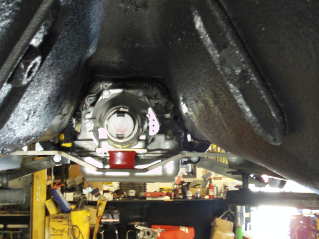

      191
      Heres is the fabricated tranny cross member. This will be powder coated as well.

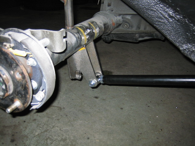

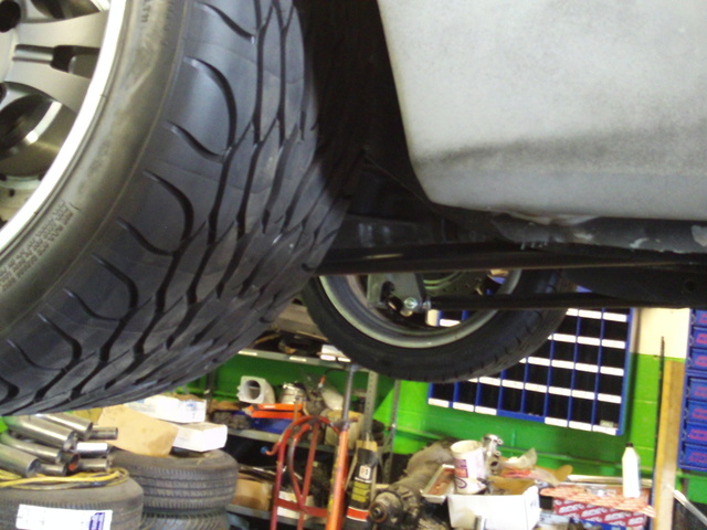

      191

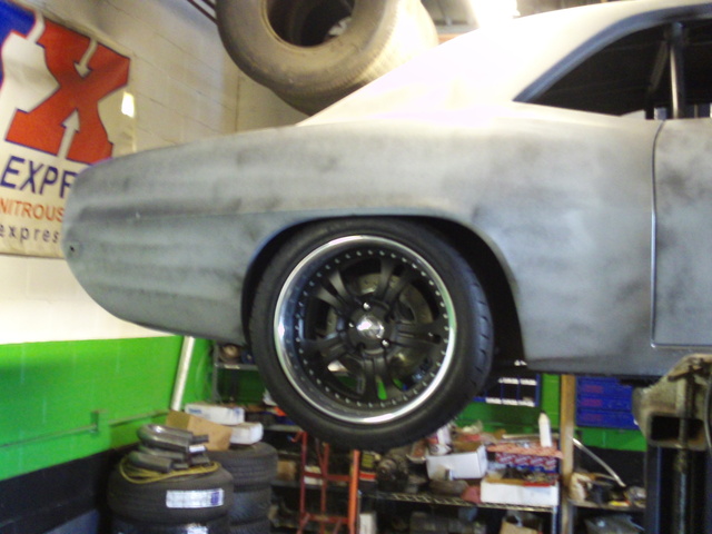

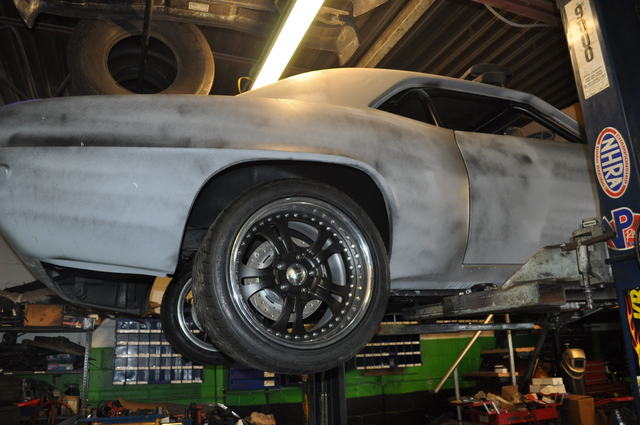

      Some shots of the rear wheels for the 4 Link mock-up.

      71
      Thats gonna be a bad ass ride. Who makes those hood hinges? They are a very nice piece.

      Quote Originally Posted by 89cobraysi View Post
      They are DSE hinges. I broke them down and gave them to the local powder coating shop who put the black chrome finish on them.

      664
      Mind me asking gauge and width to the crossmember you have installed?
    17. #37
      May 2008
      Staten Island, New York
      191
      Perry told me it is 3/8 by 3 inch Chromoly flat stock.

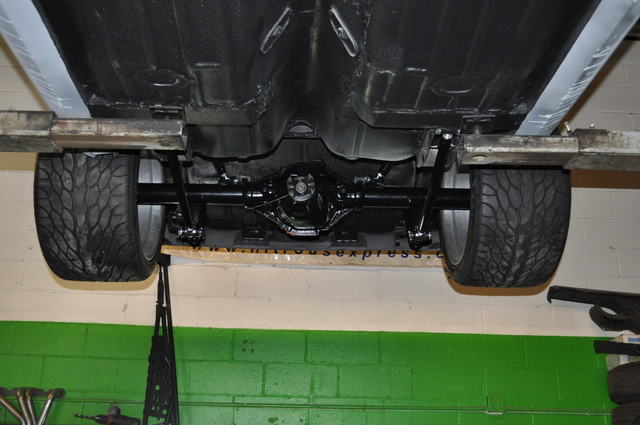

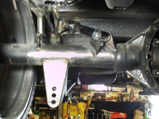

      Rear is back from powder coating.

      191

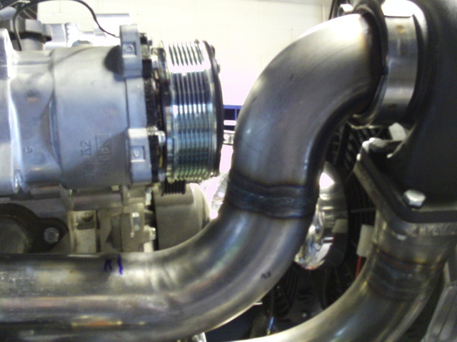

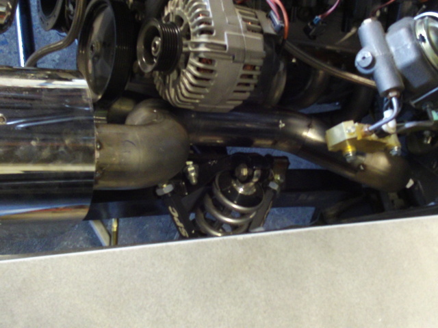

      Big P got the new turbos mounted and has started to fabricate the piping.

      191

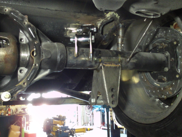

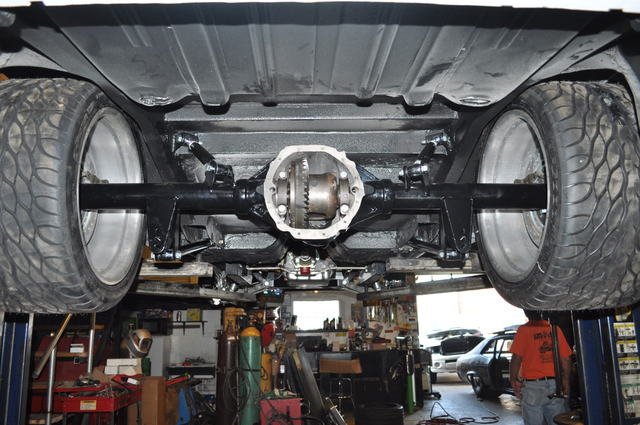

      Here are some shots of the rear installed.
