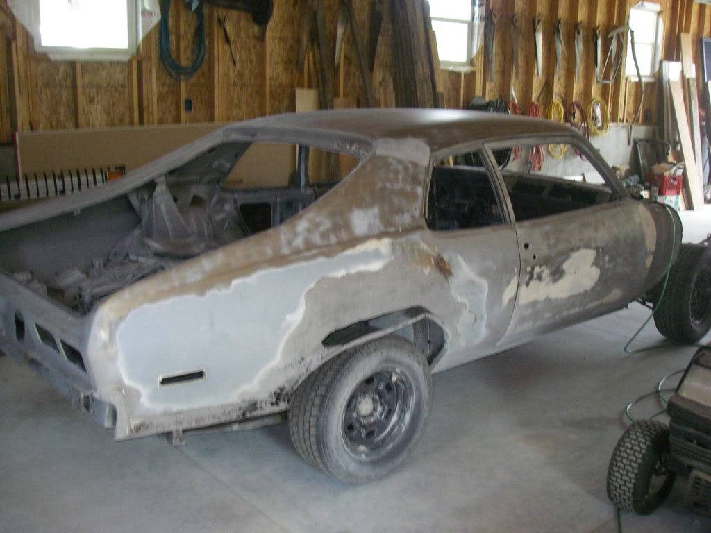

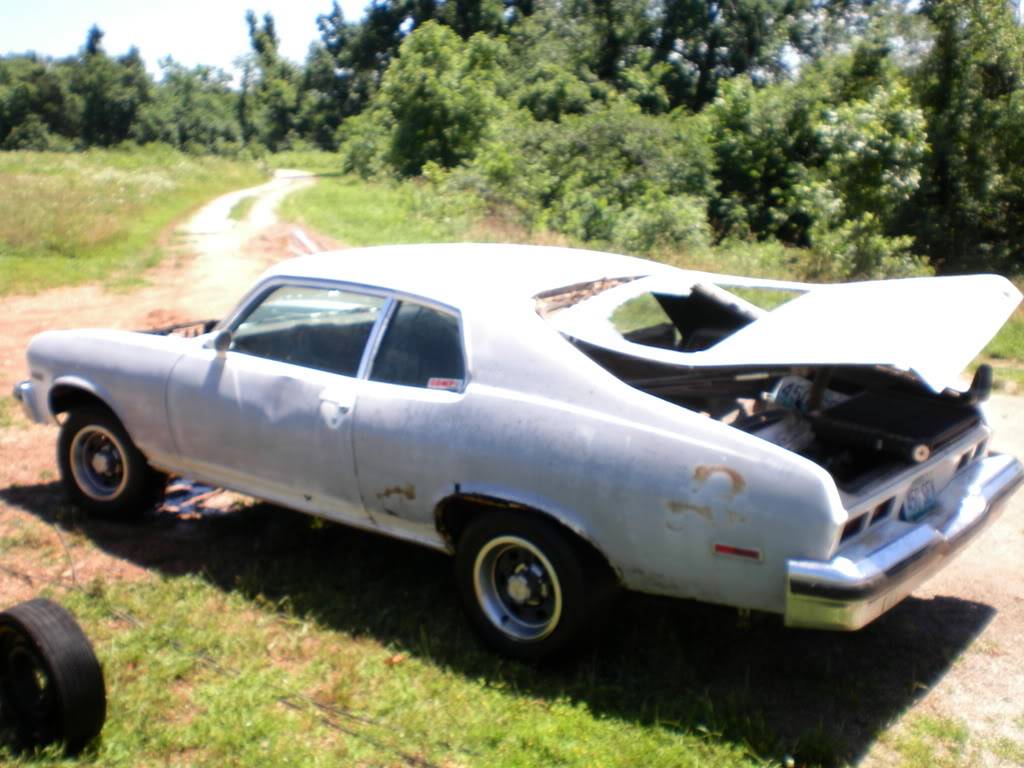

      Here is the car before I got started.

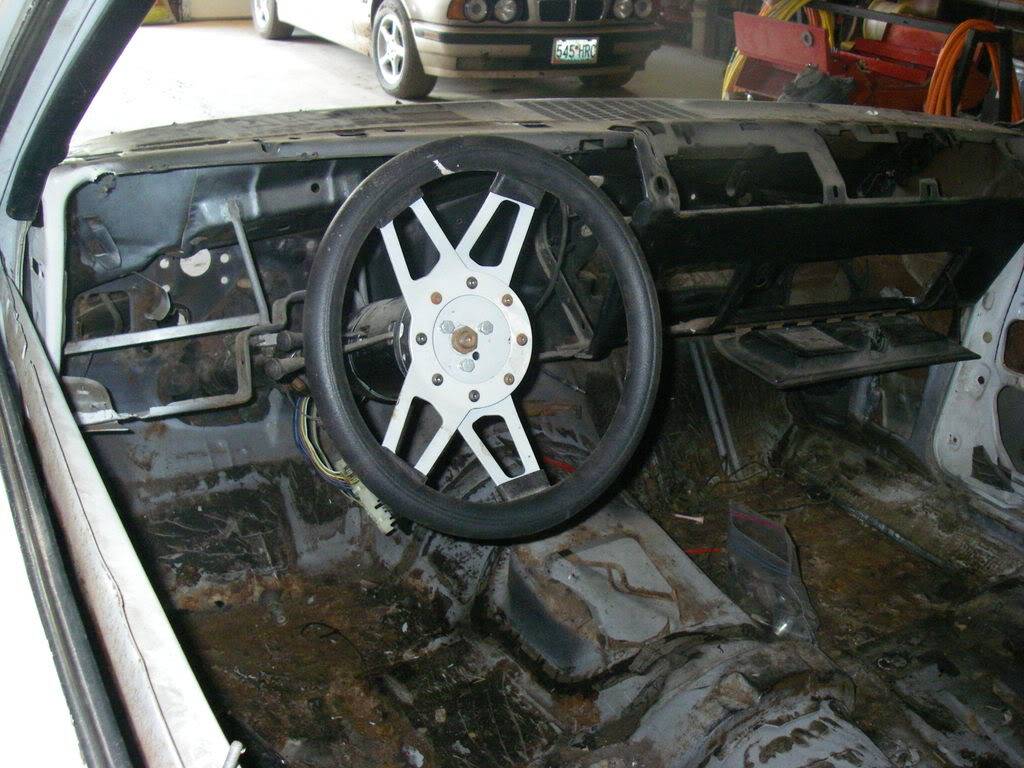

      Here is one of us tearing the car down. Everything came out. The car was takin down to bear metal.

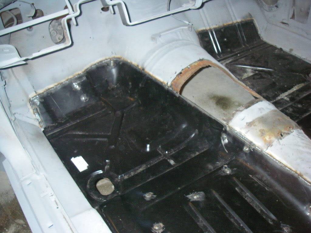

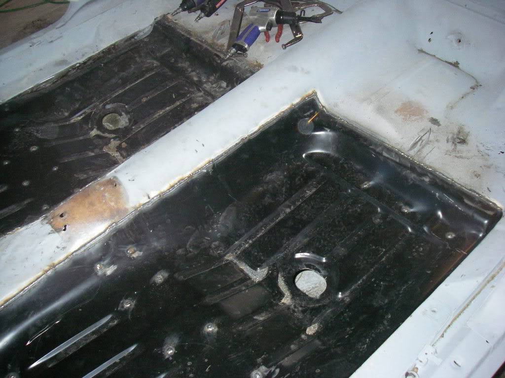

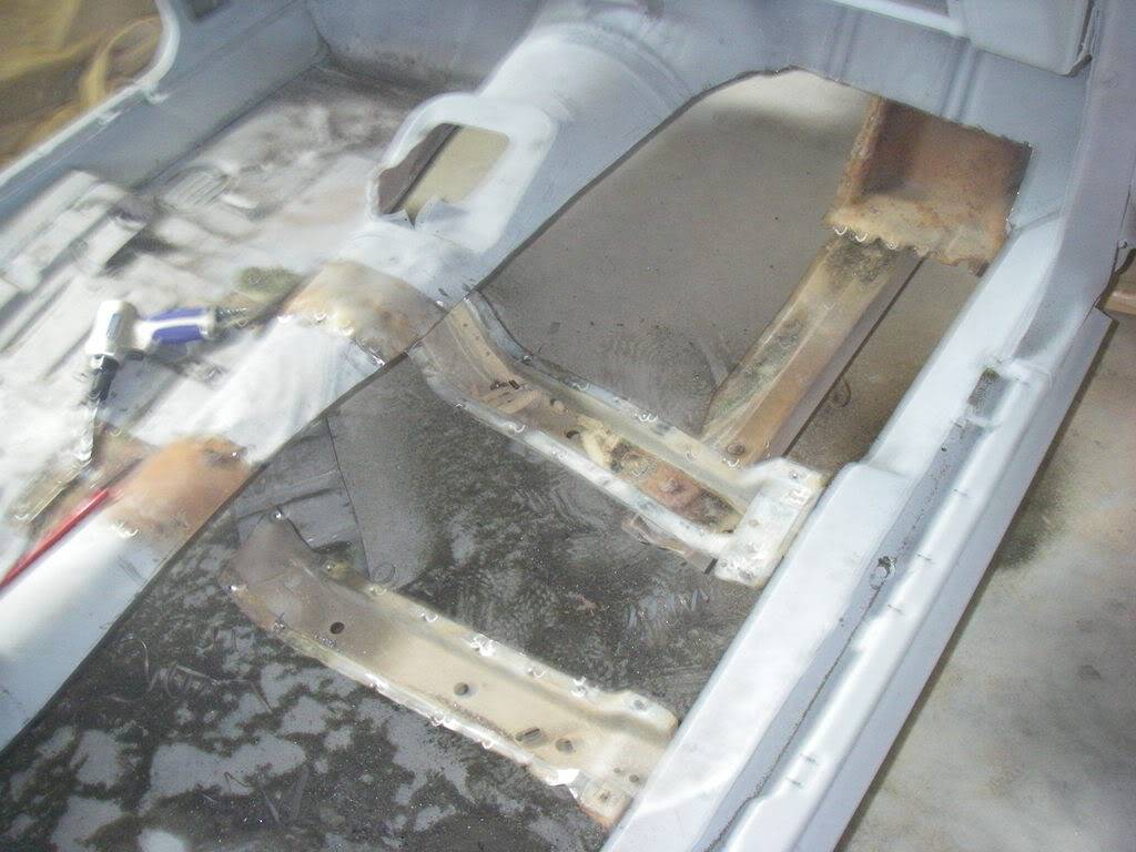

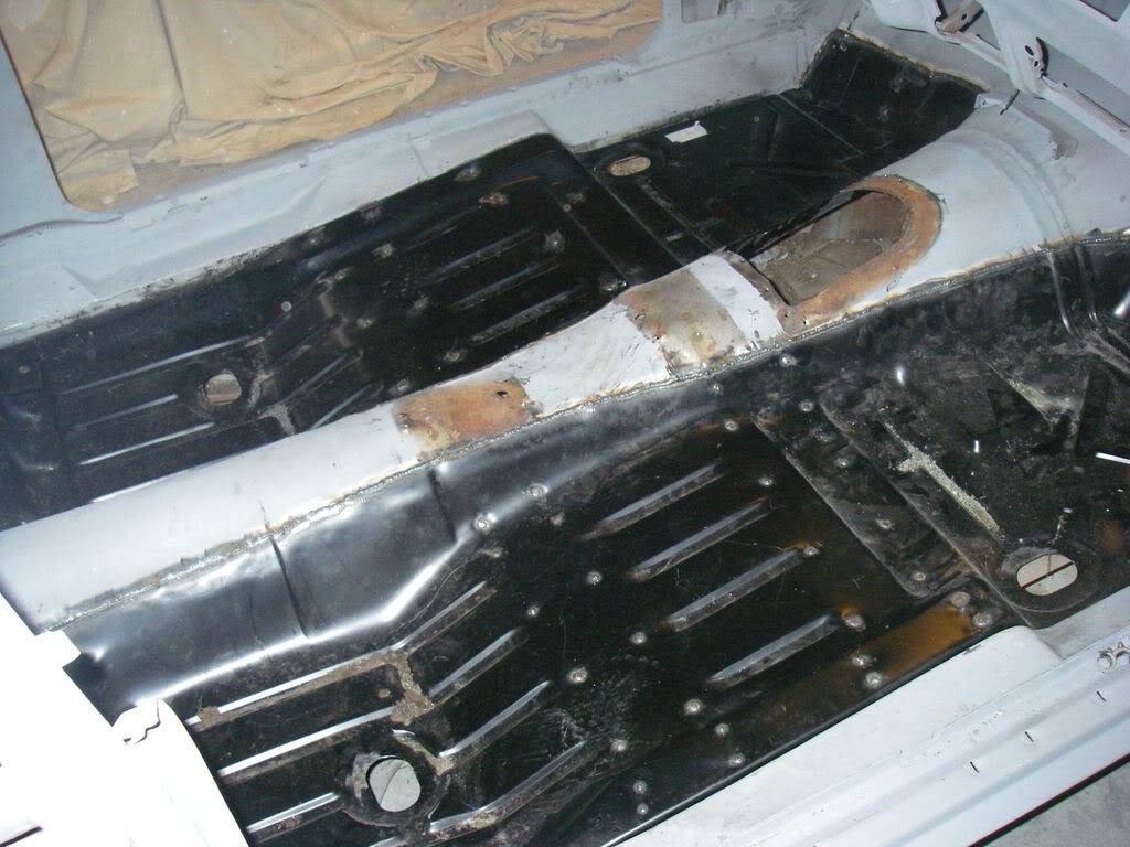

      As you can see the floor pans had to go.

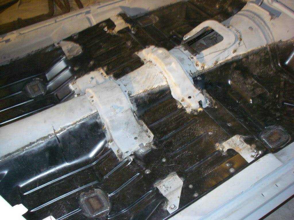

      Another one of the inside. Showing front of floor pans and dash.

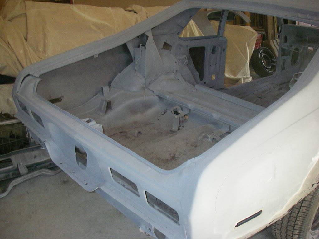

      The quarters were gone. I got new ones from Goodmark that will be on it soon.
      Another pic after it was media blasted.
      You can see the rusted out hatch floor as well. I have plans of making my own floor here. A fuel cell will go in as well as relocating the battery. This will all go under the stock panel that came with the car hiding it underneath it.
      I just got these put in the car about two weeks ago.
      I have more pics of the floor pan installs but can't get them off of my camera at the moment. Hopefully I will get them posted soon.

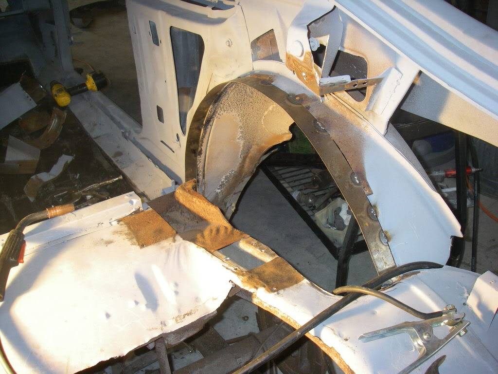

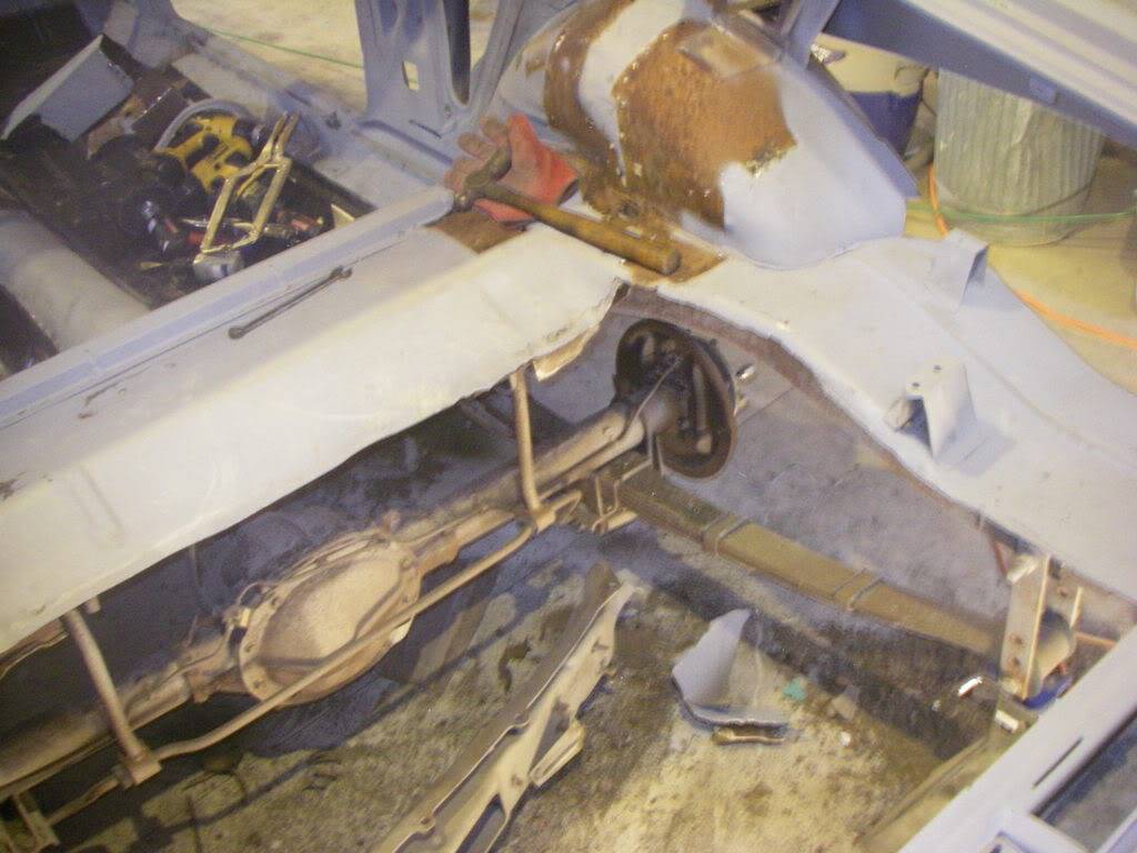

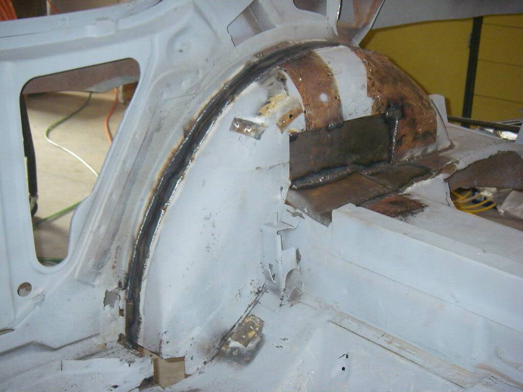

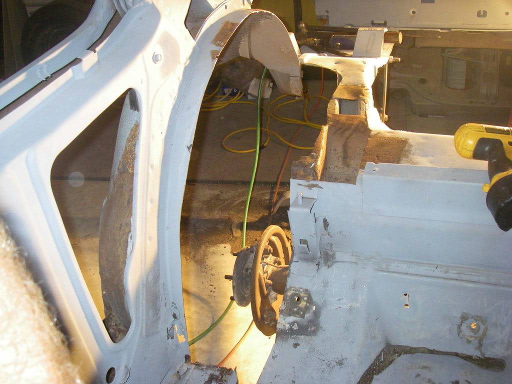

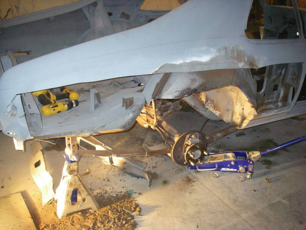

      Next I moved to the rear tubs. I cut the factory quarter off to get it out of the way. I am making my own wider tubs by placing a one and a half inch strip of sheet metal down the center of the stock tub.

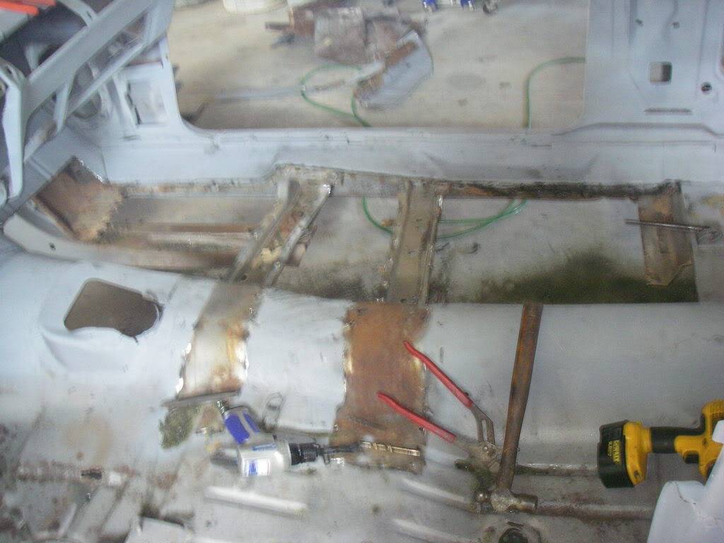

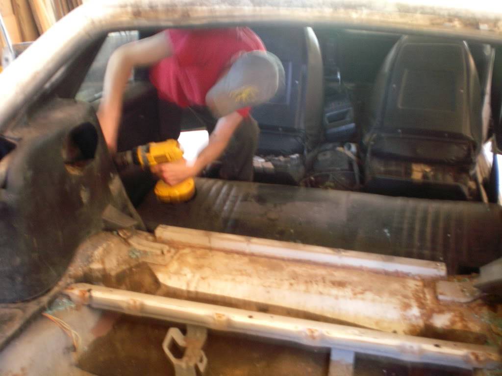

      I cut out that nasty hatch floor. I have also drilled out the spot welds and took out the bracing for the tubs.
      Next I cut out the factory tub.
      Here I got rid of the shock mount. I'm going with a triangulated four link kit with coil overs so it wasn't needed.

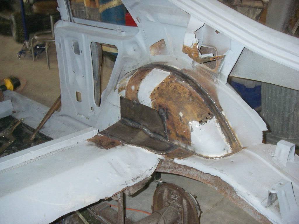

      Here is a pic after I put in the sheet metal strip. I also patched the floor over the brace where it had been rusted through. The tub was also rusted through so I made a small patch for it.
      I still have some patches on this tub inside behind where the rear seat is at the floor. I ran out of gas for my MIG though so I had to put it on hold. I am getting more this week and will continue this weekend. More pics are sure to follow. There are also more pics posted on photo bucket. Just do a search for cehuffhines and click to view my album. I will post more pictures there than on here. It takes so long to post them over to here. I welcome any criticism and advise. MORE TO COME!!!

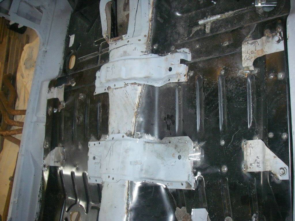

      Here's a couple more pics of the floor pan install.
      Here's the floor with the braces and seat brackets welded back in. I also welded up the drain holes that were cut in the new floor pans.

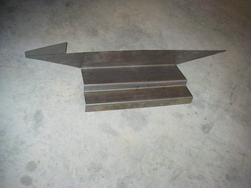

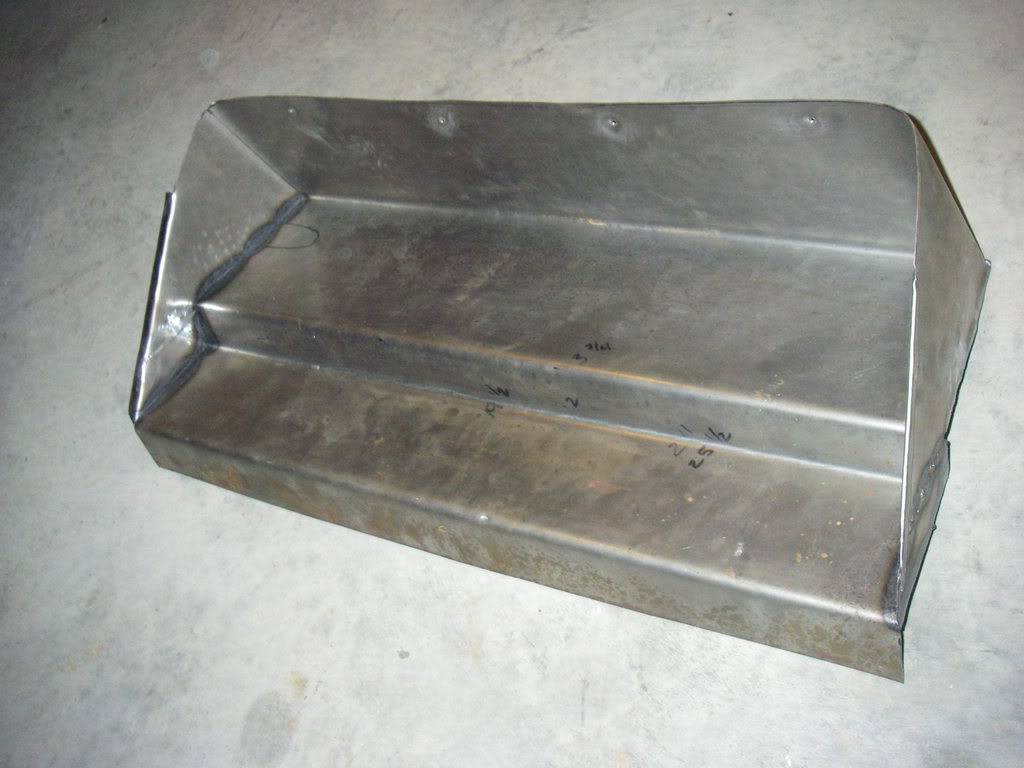

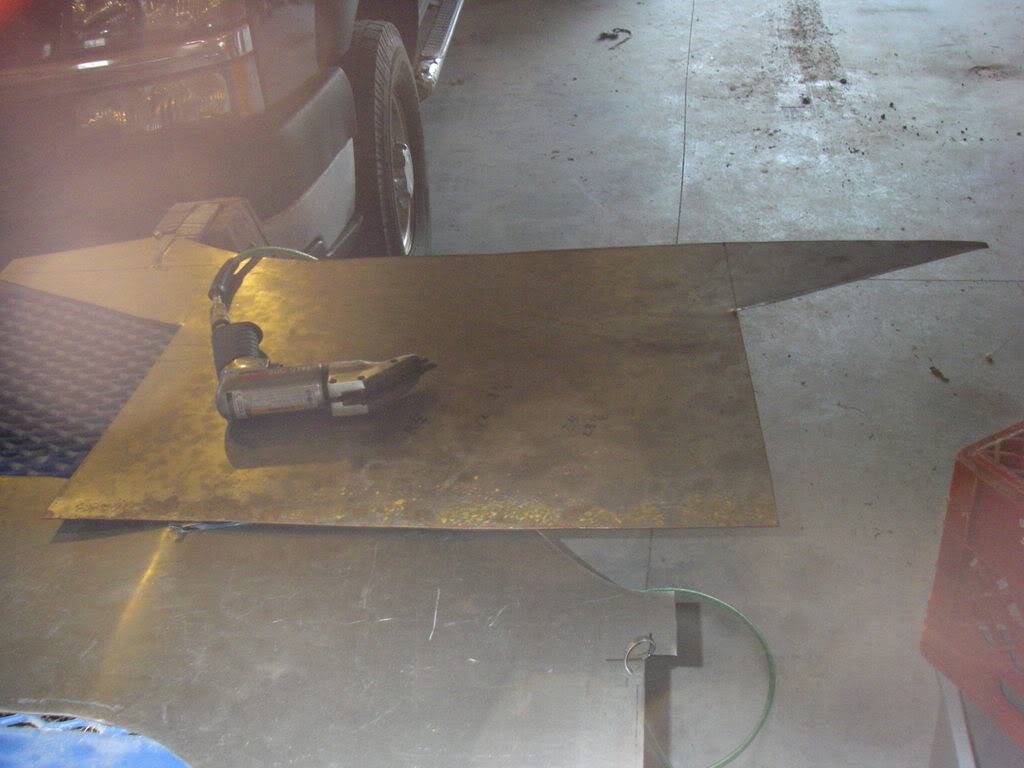

      Here is a pic of a metal break I fabricated this weekend as well.

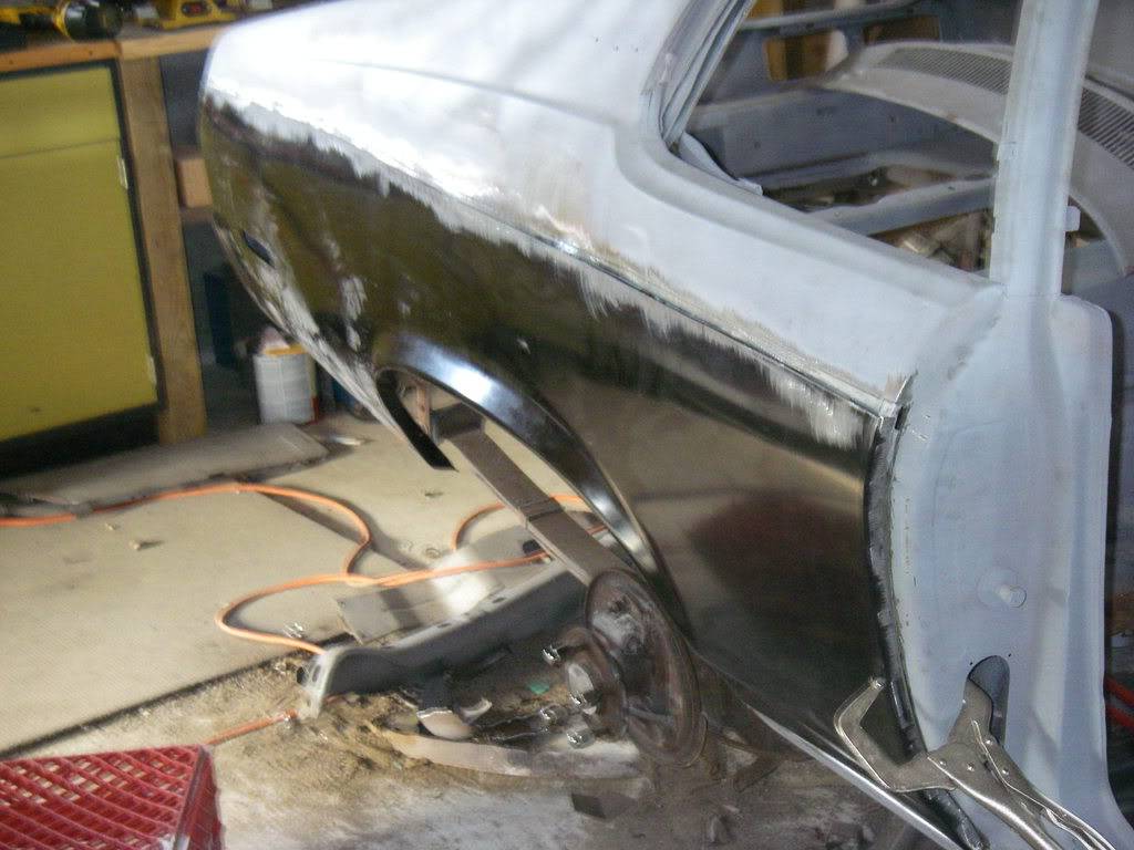

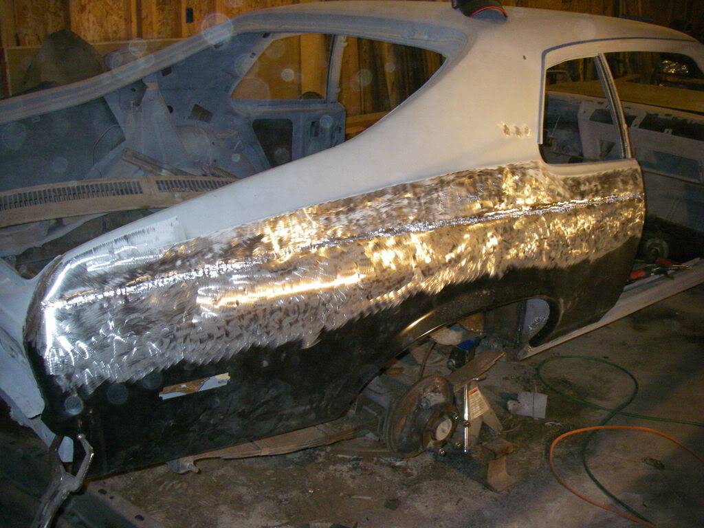

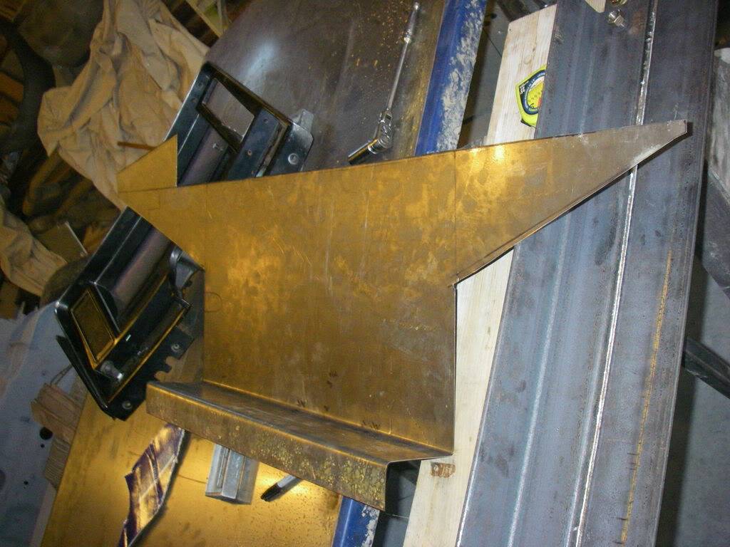

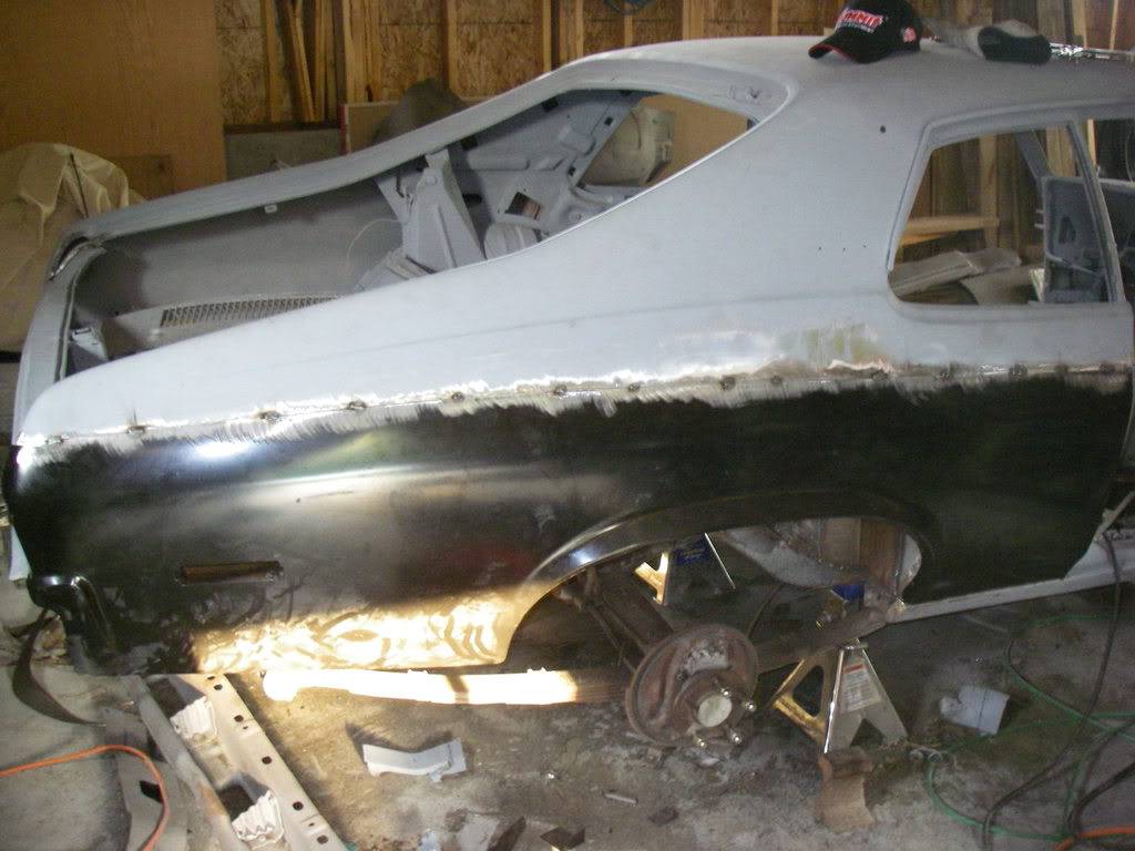

      Finally got some more photos on here. Here is one of the new quarter panel on the passenger side getting welded on.

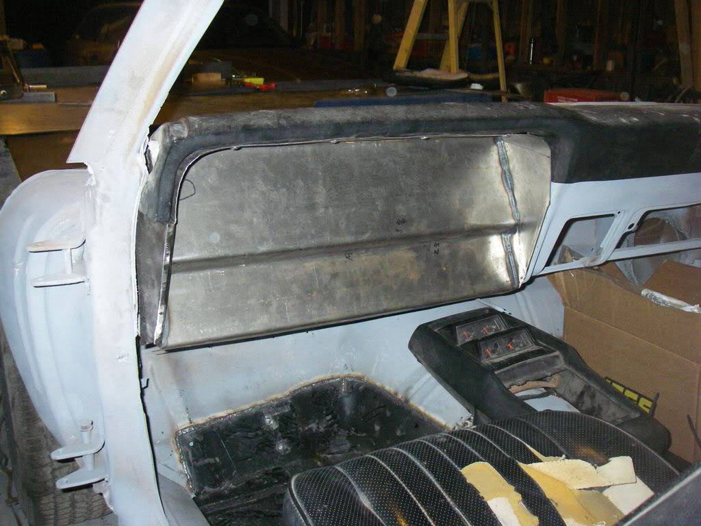

      I got tired of working on the quarter panels and wheel tubs so I switched to the dash. I decided to make my own dash panel for my gauges.
      Here was the finished peice. The trial fit wasn't bad. Still needs a little work, holes for gauges and the steering column cut out but I think it will work. Let me know what you think.
