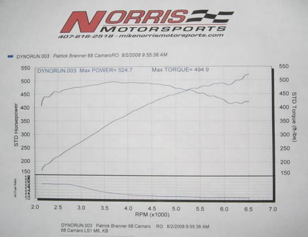

      Well last Friday I got to take my car over to Norris Motorsports to have Mike tune for the Supercharger. The motor is a basic '00 LS1 with about 20k miles on it...Mike helped me pick the cam and size the injectors but the internals are stock. I was hoping for HP#s in the high 400s.
      I want to be able pound the snot out this thing and not have to worry to much about it. So we stayed with a fairly conservative tune--not too aggressive on the timing and not running real lean.
      It pulled 525hp and 495tq to the wheels!! Needless to say I am very happy with Mike's recommendations on the cam and tuning...and oh yeah REAL happy with the Kenne Bell SC.

      nice torque numbers! that's gonna be fun to drive!
      can anyone educate me on what's going on at 6200 - 6500? I don't think I've ever seen a top-end trail off, only to go back up like that.

      Maybe the belt was slipping, then grabbed again? I was thinking valve float, but then i don't think it would recover from that and go up again.
      Those KB's are really amazing. I had a 1.5l version on my Ford302 and the torque went from around 200 at the rear wheels to 400. HP went from 190 to 325. Your numbers are incredible. How much boost is that thing pushing?

      Mike and I noticed that blip also...I didn't have a whole of time that day to keep testing but we are thinking it was either belt slip or maybe tire slip?
      I doubt it was floating a valve--especially with the new springs.
