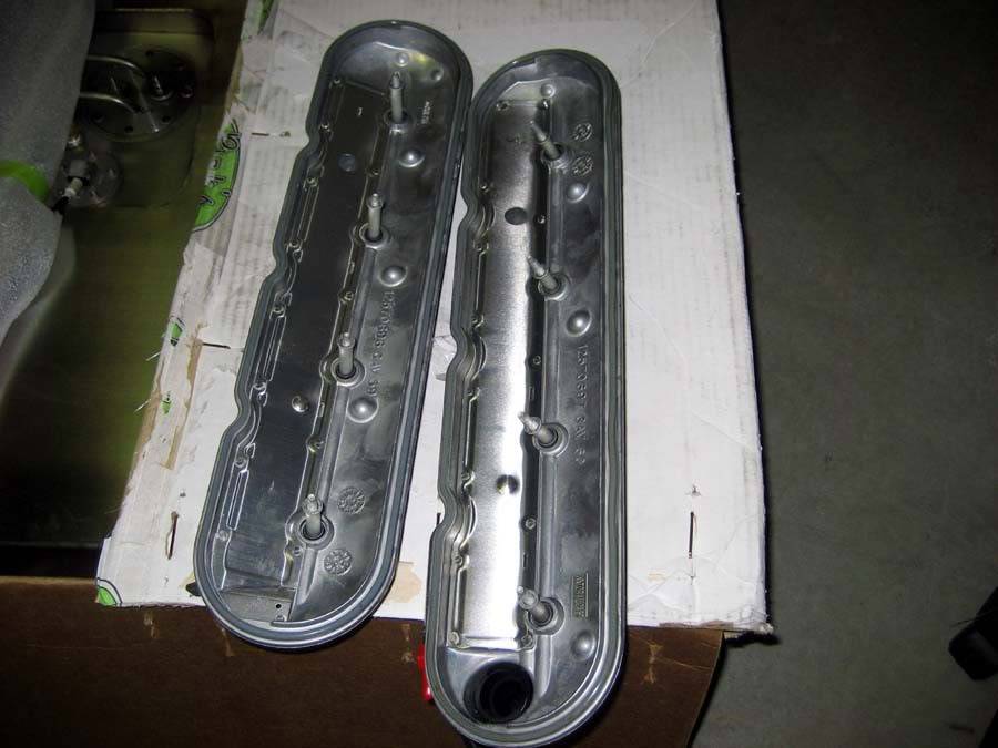

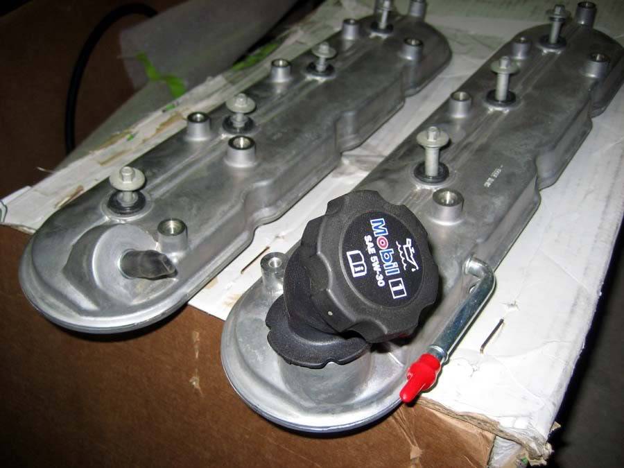

      I think I also will go back to factory covers. I went and looked in the garage at my OE covers. John I am still not sure which is outlet etc. I may be confused, but if you look at picture both the PS and DS rocker covers have baffles?
      Here is top which I believe is similar to what Andrew was explaining.

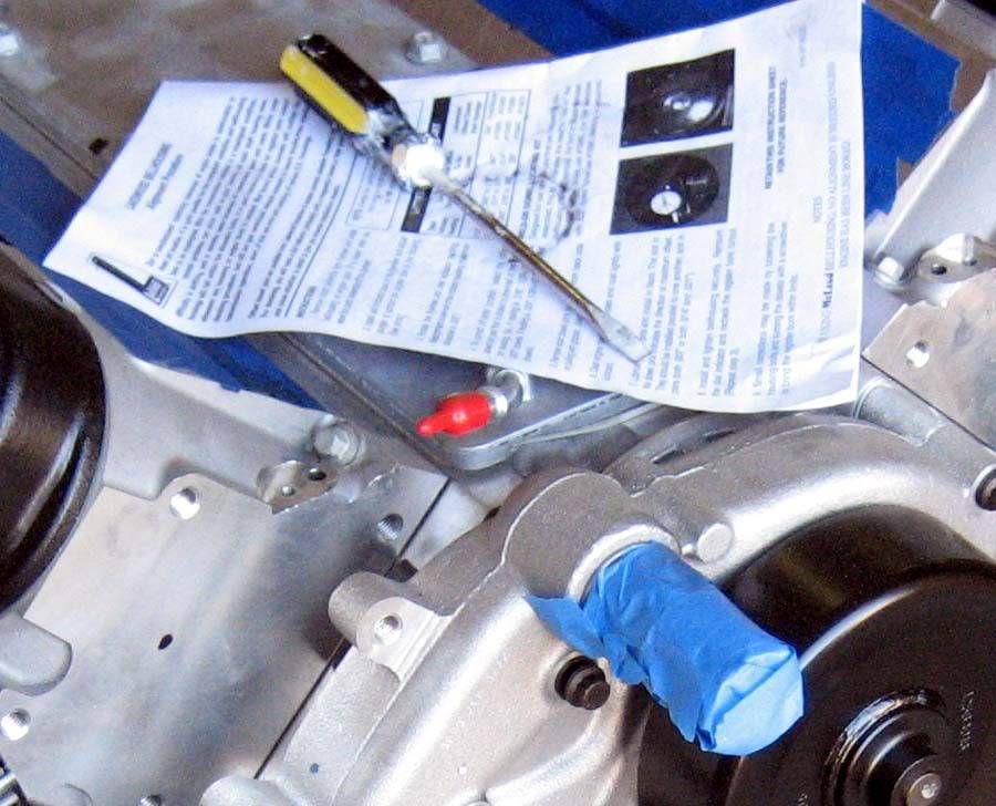

      Also, my engine does have the fitting in valley cover. Not the best shot but you get the idea.
      Not meaning to hi jack this thread just trying to understand before I go and buy one of these catch cans

      Andrew, you and Tom have "LS6" style valve covers. The PCV outlet is designed to go from the valley cover. The fresh air inlet is the nipple on the cover with the fill port. Leave what is the old PCV port on the other valve cover alone... and use your valley cover instead.
      Legend on LS1Tech has it that the LS6 style is better at keeping oil in the engine, but most of the hardcore racers use a catch can anyway.
