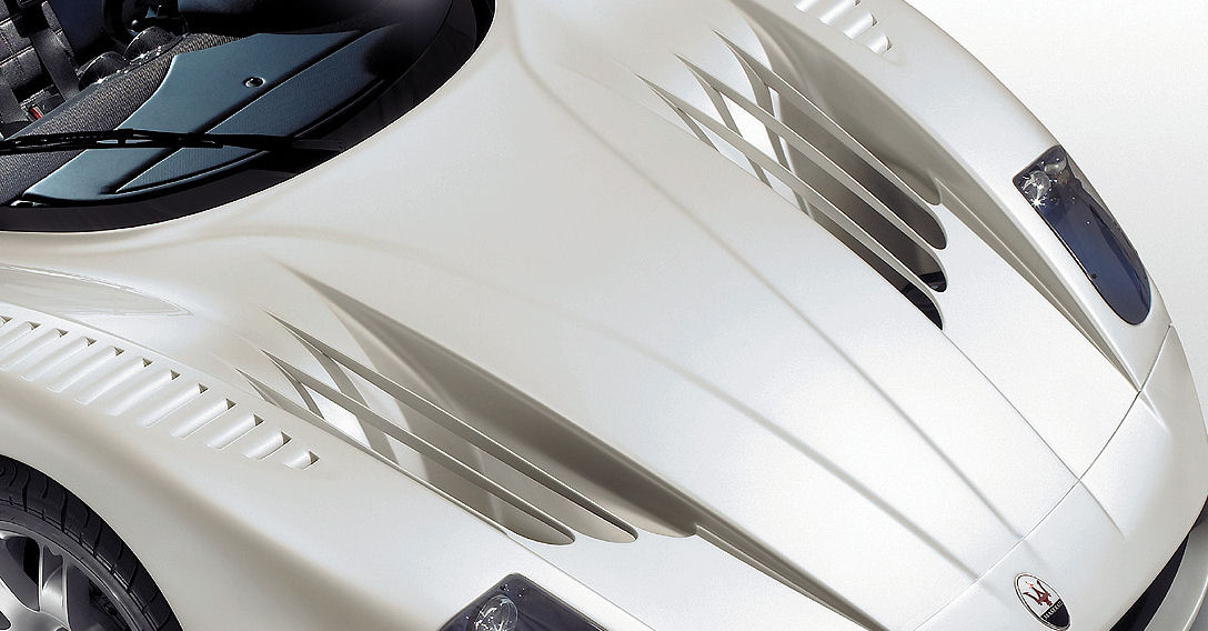

      I really like the look of these hood vents. I've drawn them on the hood of my bug and it looks very good. If you use the metal hood, draw the pattern you want, make those cuts, then bend the flaps down and weld in sides, you'll have the same look with the ability to let the heat escape from both the engine bay and the radiator. My preference to get air into the radiator would be to cut out the areas of the front apron between the fenders but leaving the area behind the hood intact. You can also add a lower lip below the front of the apron to keep the air from flowing under the car and forcing it into the radiator and/or engine compartment.

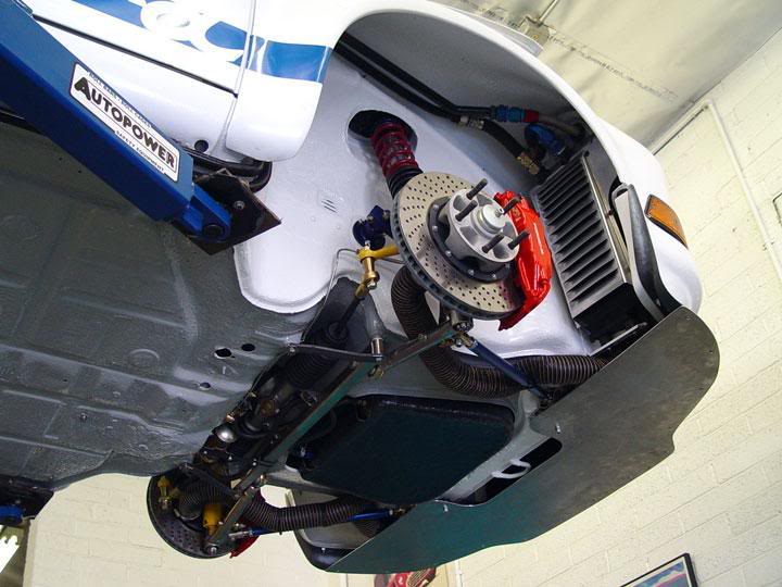

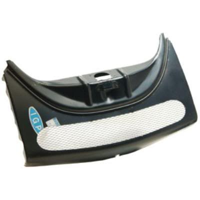

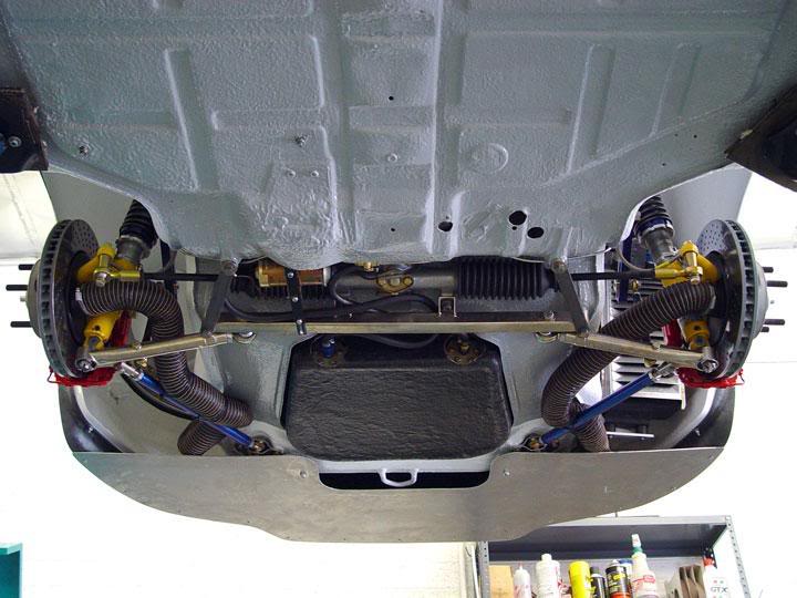

      My Super Beetle lower apron has "slots" down low but they aren't very big. I found this lower apron on Mid-America's site... I will try and make this work. This looks like it will pull a lot more air across it. My new radiator setup will be mounted MUCH lower in the car for Center of Gravity reasons. It will be right behind this grill...
      and install some sheetmetal ducting to my radiator somewhat like this:

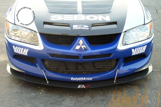

      I will then construct a splitter, out of either carbon fiber or aluminum, to force air across this apron opening to assist in the cooling. It's secondary benefit will be to minimize air being trapped inside my front fenders and creating lift... Check out the small "wickers" on each fender right above the splitter... I will fashion something like this as well to assist with downforce and minimize an "understeer" situation.
