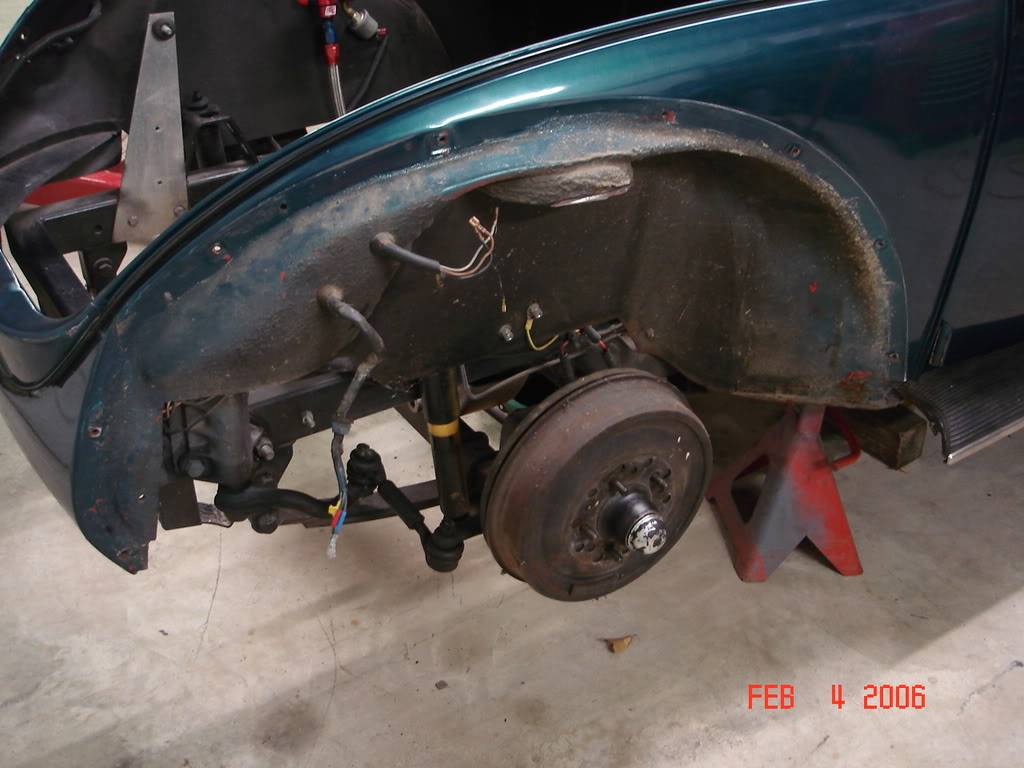

      Here are some installation pictures... First, the "before" pictures...
